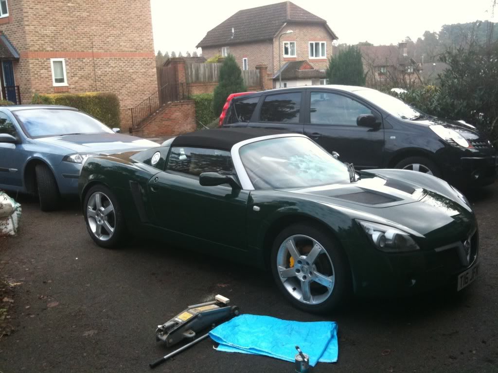

I used black caliper paint from halfords and I removed the anchor pins from the pads first and fitted them back in when the paint dried. Where has your splitter gone :lol:
dont you recognise your own jack, you hadnt fitted it when i took that LOL :beat:
I know lol :lol: you still giong on Bob's run next weekend thumbsup
bit sad i know, but when the clocks change, like they do next week, I like to make the most of it by doing something special. So, its a toss up, Peaks run, or day painting calipers.....?????
