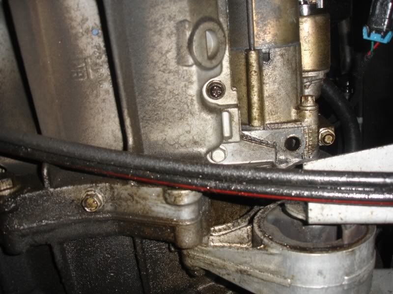

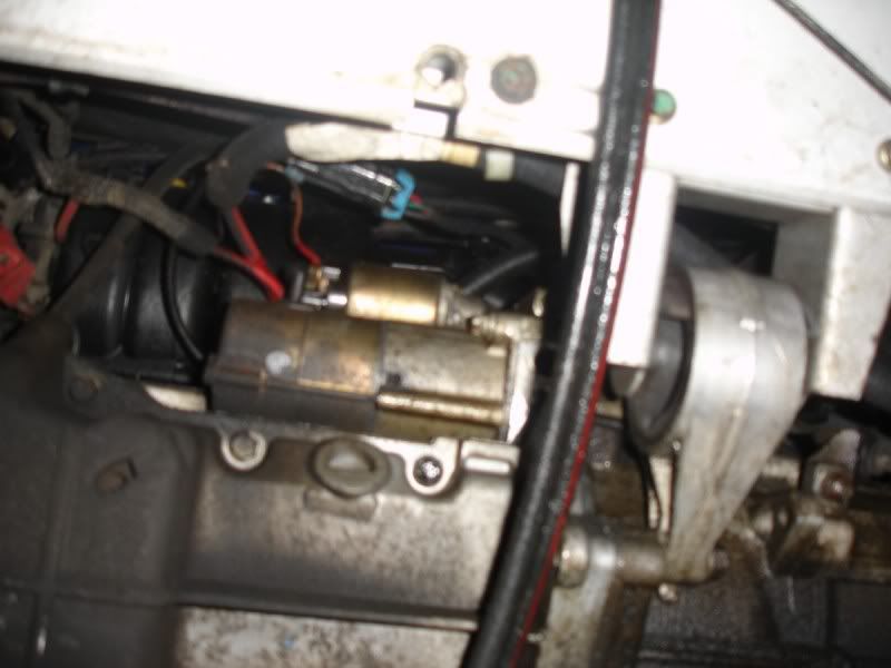

Hi all, I've enjoyed my VX hassle-free this season, it's performing lovely. Yet, as it has an unusual appetite for the black stuff, I decided to remove the bottom plate, to see that my engine is completely covered in oil, it seems to come from above, on the left side. What could be the cause? I'll book it in at Opel next week, but I'd love to know what diagnose to expect. Is this a common problem?

Is it definitely engine oil? Do you have a gearbox breather mod done on your gearbox to prevent it venting oil? Is the CV boot okay and not leaking grease? If it's on the left hand side of the engine, it'll either be from the oil filter housing or the oil cooler/pipework. Chances are it's the oil filter housing though. Quite possible that whoever did the last oil change didn't replace the two metal oil seals either side of the cooler sandwich plate (or damaged one in the process) of tightening everything back up. You may be able to stop it by tightening the filter housing up a fraction but having had it happen to mine after a service (and losing 2 litres of brand new oil :angry: ), I replaced the all of the seals and carefully did the housing back up and have had no further problems.

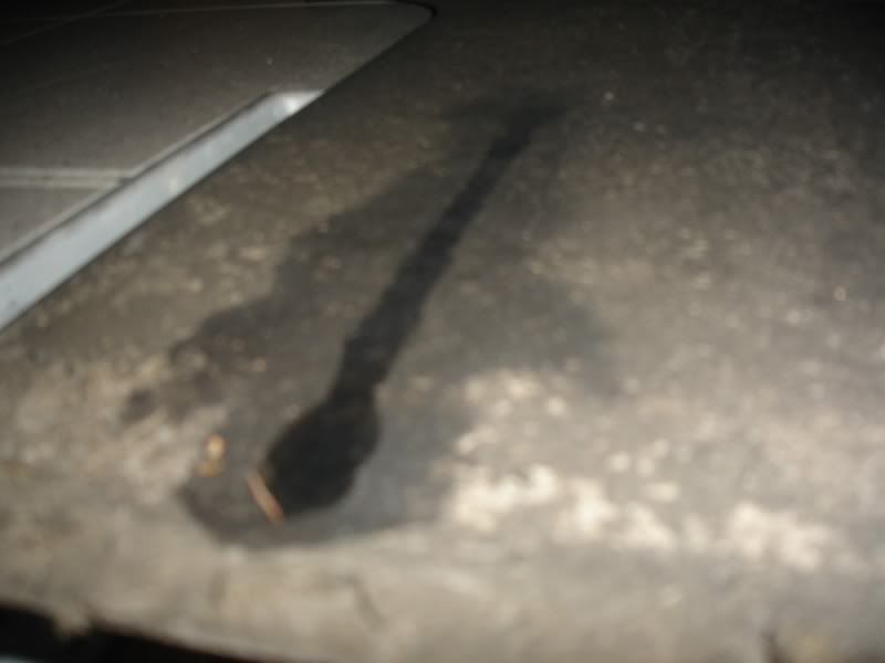

I doubt it'll be the oil filter housing, as it's been 'consuming' litres of oil since I've had it, it's not just since the last oil-filter change. My engine has always been covered in oil on the left side, but not as much as it is now. I'll try to take a picture.
Thanks for your help!
Drops on the bottom plate

Looks even more like the oil filter housing to me, judging by where most of the oil is and where it's dropping down to. Like I said, it's most likely one of the two metal seals between the sandwich plate and the filter housing. Nobody who services these cars seems to bother replacing them but, they are easy to pinch/nick when screwing the housing back in (especially as the oil filter cap and the oil cooler adaptor tend to come out as one). I've had this happen twice now, though the last time was much worse) and replace them every time I change the oil. Last time everything on the block below the filter housing was soaked in oil, the sump, the gearbox, undertrays, everything.
Buy two new seals (item 5 here), change the oil and filter and refit carefully with the two new seals and I'll bet your leak stops.

A friend mentions the oil comes from higher up - too high to come from the oil filter - what would be your guess assuming the oil comes from high up?

There may be some residual oil around from the filler cap where somebody has been a bit messy with topping up the oil. Assuming you haven't got a hole in the cylinder head, then the only place that is higher is the rocker cover gasket. Rocker cover gasket isn't subject to high pressure, so would likely only weep. Clean the engine up, otherwise you're unlikely to spot any leak. Replace the seals in the filter housing (and a new filter all for under £10) and then run the engine up to temperature and check for leaks. Then check the tightness of the filter housing cap again once it's cooled. My money is still on the filter housing being where the leak is. The oil is under full pressure at that point and floods out when you have a leak.
