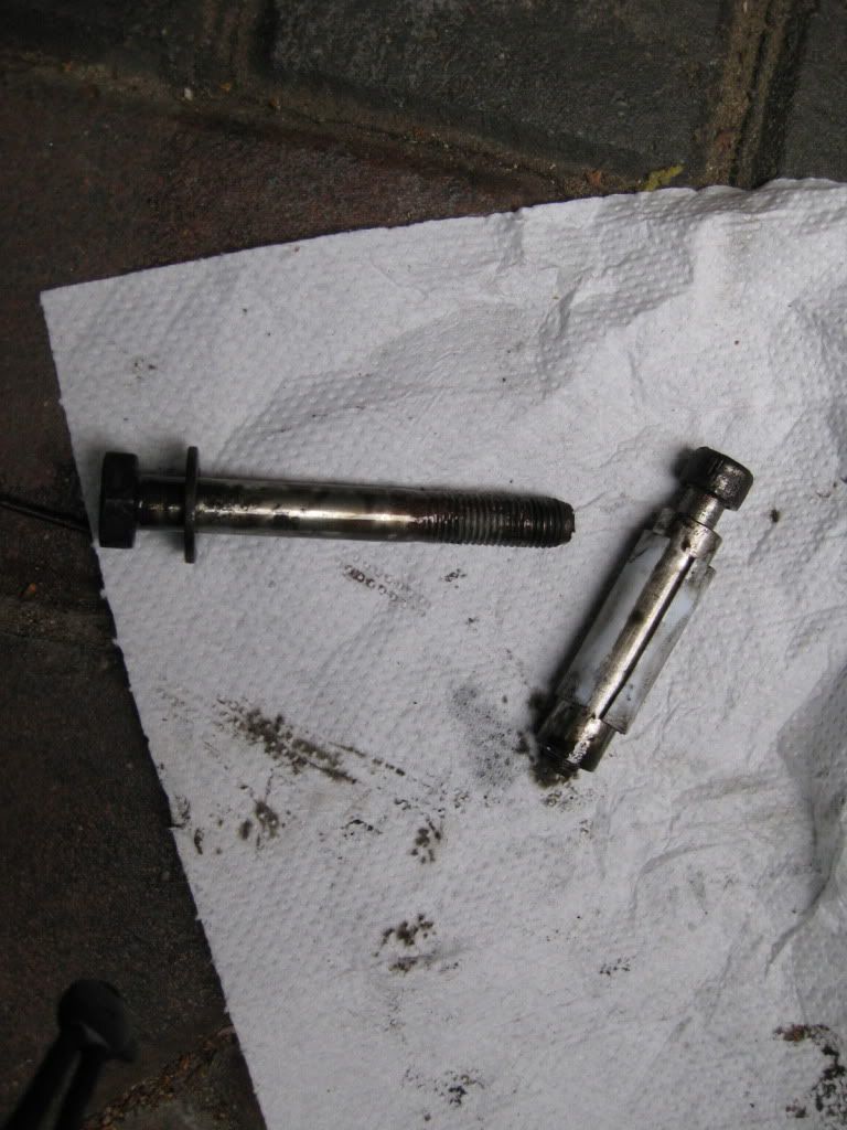

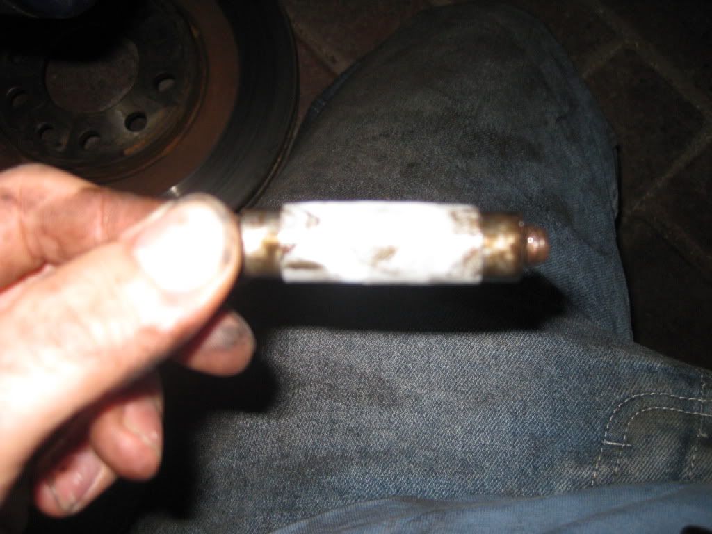

I have just been preparing the car ready for my new handbrake cable and noticed that there is some play in the offending Caliper on it's lower slider. However when I undid the upper bolt I noticed that I could slide the whole caliper straight of the lower one. Additionally as it came out a small piece of white plastic fell out!!!Posted Image Without this piece of plastic the amount of free play on the caliper just gets worse.
I have now had a look at the EliseParts website and noticed the rear caliper servicing kit they do... http://www.elisepart...urbishment-kit/ and clearly there is no little piece of white plastic like this:
or as you can see on this pic:
Now Having had to undo the retaining bolt on the lower slider with a pair of pliers (as the bolt head had previously been chewed before I had got the car it turns out) I need a new one anyway. AutoVaux or Loti I presume.
But my big question is - do I need to replace the caliper given the amount of play or am I likely to find replacing the slider will reduce the amount of play (The other caliper seems much more robust in comparison)

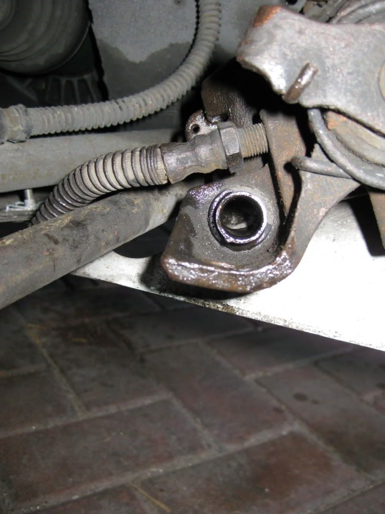

Here is a pic of the whole where the lower slider runs through:
or another
My guess is that the lower slider has worn beyond use at somepoint and a garage has just tried to fix it without really replacing parts. Alternatively I could be alltogther wrong. This car has been such voyage of discovery it is untrue - I am learning a lot, but every time I touch something I end up with more questions than answers.

The slider on the lower bolt should be a metal sleeve, someone has obviously put that plastic sleeve in to take the slack out , sirprised it has not gone sooner :rolleyes:

There was a metal slider on the lower bolt, but also the piece of plastic Posted Image !
I take it the black part on the Elise-Parts site is supposed to be in the caliper itself - there was something in the caliper, but looked more rubbery than plasticky or black metal like!

I've got the white plastic insert on both of my rear calipers. I've also got a reserve pai of rear calipers and one of them has the insert (I guess the other was lost at some point).

The small teflon sheet on the bottom slider is normal on the original setup. Any lateral play in the caliper is most likely caused by the large upper mount/slider having play. This is the part that really fixates and stabilises the caliper. The bottom one is really only there to stop the caliper from rotating away from the disc under load and not there to really stop it moving around. The top slider is a quite substantial steel tube that has a tight fit in the upper guide of the caliper and is the main 'anchor' for the caliper. If the boots are damaged then dirt can get into the slider and wear the tube or caliper hole. The slider refurb kit replaces the bottom rubber insert and is tighter than the original one. You won't be able to re-use the teflon sheet/tube in this case and it's not really needed anymore. For lubrication of the sliders use a thick silicone based grease, *not* a petroleum/oil based grease as this will soften the rubber and seals. In any case the rear caliper design will always allow it to move around a little. This is normal and unavoidable in such a single piston sliding caliper design. You will always notice that the handbrake can be pulled up higher when the foot brake is applied and vice-versa the foorbrake will feel more solid when the handbrake is applied. Bye, Arno.

All the brakes I have done on VXs have all had the white sleeve, I assume it's some kind of PTFE to stop the caliper seizing onto the slider just read above it's Teflon :)

Yeah, I have the white plastic too. If you need a metal sleeve making give me a shout.
