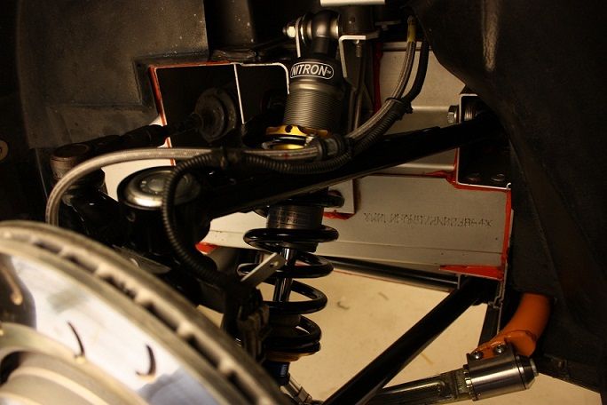

There is a photo of the rear ARB installed?? I would like to install it!
#24 techieboy
Posted 10 February 2011 - 09:11 PM
Some of these might help. There's a few more here but those are the best pics.

Posted 13 February 2011 - 02:20 AM

Simply wonderful !!!! I'll take the kit!! Thanks for sharing the photos,really a nice job!

Matt. Why in Gods name are your wishbones SO clean....????
:blush:
The benefits of powder coated wishbones and a pressure washer. I was actually half way through cleaning up the remnants of the nearly 3 litres of oil that got spunked around the engine bay after a filter seal mishap (you can see the state of the underside of the gearbox in one of the pics) at the time. :angry:

Mine rear arb is arrived,but not straightforward installation,droplinks on mine were replaced with cheaper drop links with ball and integral stud(like the standard on the front arb) not the inox spherical joint shown above,also missing the proper spacers to get the droplinks vertical for correct working position..... Now i need to make the spacers on the lathe :angry:
