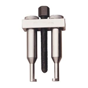

:lol: It's not a Rick Roll. It's a one of these...
