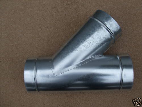

right he is what i am thinking using something like this:
now i was thinking running twin air filters so that there is more surface area that is in direct flow of the cold air coming through the tubby ear
then making a sort of enclosure so that there is no chance of sucking in hot air from the engine
would this be beneficial or chatting sh** :)

we dont run mafs well not yet ;) even if you dont make a enclosure you are still doubling the surface area of cold intake air that the sc is sucking in maybe block off the hot side of the air filter?!

you need to find out how much volume can pass through one then find out how much volume the car needs. if the volume the car needs is actually less than the maximum volume one filter can pass.. its pointless.

but this way it stops hot air making its way into the engine its just cold air

: Yeahthat : but also would you no need to consider the maximum flow rate of the narrowed branch (like fluid dynamics) and the effect of the two paths of air and how the disturbance (slowing each other down) upon each other effects the speed of the air flow. That is unless you were to create Venturi spin so the air effectively melts together and then you may increase the 'volume' of air through the same cross section of pipe!

Save your efforts Joe. If you want twin filters look at the cossie ones. I have a group N cone filter thats 14" long but you can now get one that is larger diameter and is cone in cone. These supply cossies up to 800bhp so should be more than enough for the VX. WRT the air con thing. I looked at this some time ago. I thought that with climate control you could almost dial in the ICT. The rate of airflow and amount of cooling are too missmatched to do anything but take the edge off. Drag racers use a 'one shot' variant where they open a bottle of CO2 over a small intercooler to achieve good ICT's.

There goes that idea then, was just chucking a few ideas out there to see if the cold air intake was able to be improved, but back to looking at over bits and pieces then :lol: I was running a rs500 air filter which was very large! This is the one we use on all of our conversions :D I might just buy a air filter like the itbs ones! So it covers the whole vent but runs through one 80mm pipe this would probably be not a bs solution to be honest!
