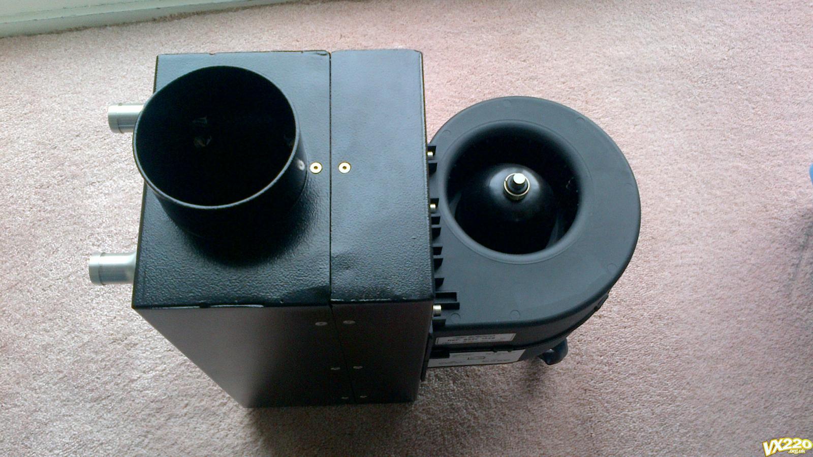

I have got the 2nd prototype unit back from the fabricators and assembled, it will be sending it off to a tester today. This new unit is testing a new 3 speed squirrel cage fan which feels quite a bit more powerful than the standard.

Hi guys, I've received the 2nd prototype from T7 and will b fitting it this weekend, will put pic up in a bit

This one has the squirrel cage type fan, it looks more than capable! End design will look lots different. I'll post up how it performs later tomorrow.

i saw the post noting change in running temps last time round, when i replaced my trashed heater with the smaller one i bought from T7 the temps were the same, when i tried the 1st proto type the heater element was double the size of the small one i bought but the engine temps have been the same. the 2nd prototype has the same larger element but the more powerful cage fan.
To be honest I found that the heater is fine if you do the following:
1. Take the top of the dash off and seal the plastic casing with bathroom sealant.
2. Take the heater box out and seal up any gaps in the box with bathroom sealant.
3. Replace the aluminium ducting with some corrugated plastic tubing making sure it fits properly at both ends.
Certainly on my car less than a fiver's worth of bits has made it work more than well enough.
i did this on mine, definatly helped but a long way off what you would expect from a normal car heater, having a proper heater will improve my enjoyment during the winter months loads, i use mine every day.
here is a pic of the 2nd prototype.
adam said this is just for testing the flow from the new fan as the heat generated seems ample, just need more flow to demist more than 4 tennis ball sized holes on a short trip out!!! :groupjump:

right guys, just got back from a little drive with the new heater fitted. took just over 2 miles to get the car up to temperature, turned the heater on, only got full speed for now but whoooah lovely hot air blowing in my face, had the vents facing me but if its like that in the winter i will be well happy :D the temperature normally sits around 84-85 under normal driving and still does, turning the heater on it drops to 83-84 but im sure it did that before? might be wrong though, i will test it out tonight again when its cooler. but its definatly not dropping more than 2 degrees, i dont know what happened to yours slindborg? could something else affect it like an air lock?

After speaking with moneyhunster this evening and receiving some great feedback and good news we can sign off the rad and fan as the ones that will be used in the production unit. The next stage is to get hold of a car for a number of weeks to complete a final measure up and fitment of the new heater once it has been fabricated. There are a still a number of issues to resolve which cannot really be done properly without a car at the workshop to work with:
