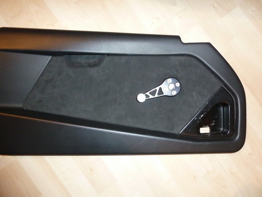

Heres some door cards I did earlier this afternoon. Used some 3M spray mount to centralise the alcantara and a glue gun to glue the edges.

Looks good RSG thumbsup Did you use a second piece of alcantara for the door pull?
Wow, these look great, rsg and very reassuring to see that it IS possible to get a good result. What do you mean by "centralise"? Didn't you spray glue them over the entire surface? And did you first fix it to the handle cut-outs, or to the main surface? And how on earth did you manage to stretch the material and/or avoid wrinkles?? Did you need to use steam or heat?

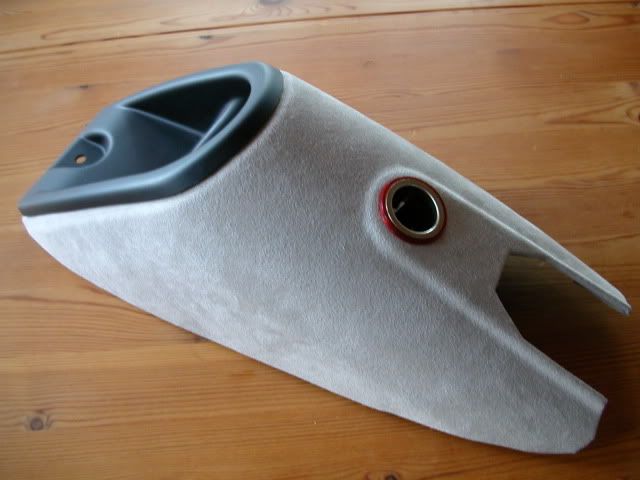

This one went well:

ferg top job mate :) Ghand get some pics up with it all finshed. chinky chinky
