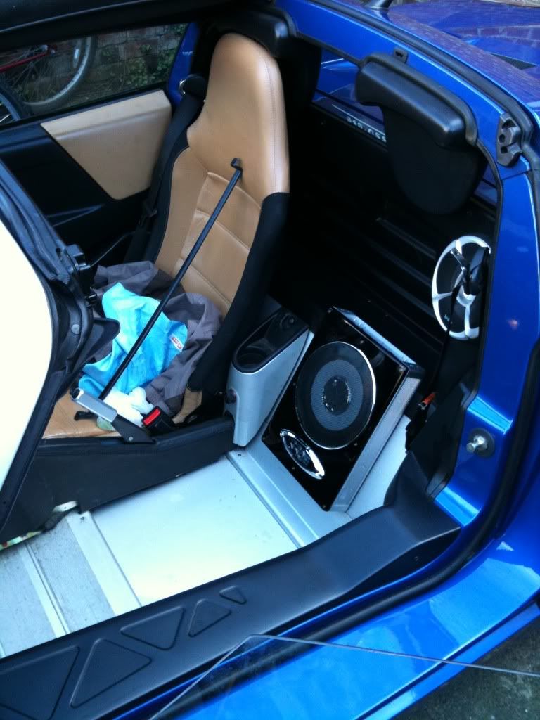

#31 Mangham54
Posted 22 June 2011 - 06:44 AM
Where on earth have you managed to find space to mount a sub!
Only option I thought of for more base was the rear parcel shelf. Was glancing at it today and wondering if I could fab a very small box section, wrapped in alcantara or similar and fit 2 x 6"x9" there. Not sure if it would fit though tbh, or whether you would need an amp to run it. Then you have to mount the small amp in the dash or again behind seats.
Haven't touched audio in 10 years since I had my 1.2 clio (bless it)
May help your imagination:
#32 Cookies220
Cookies220
  • 2,721 posts
  • Location:Beds.
Posted 22 June 2011 - 07:37 AM
I have the very same sub although I put mine behind the drivers seat to give the sound some room to get out(as I'm a short arse)
Sounds awesome!

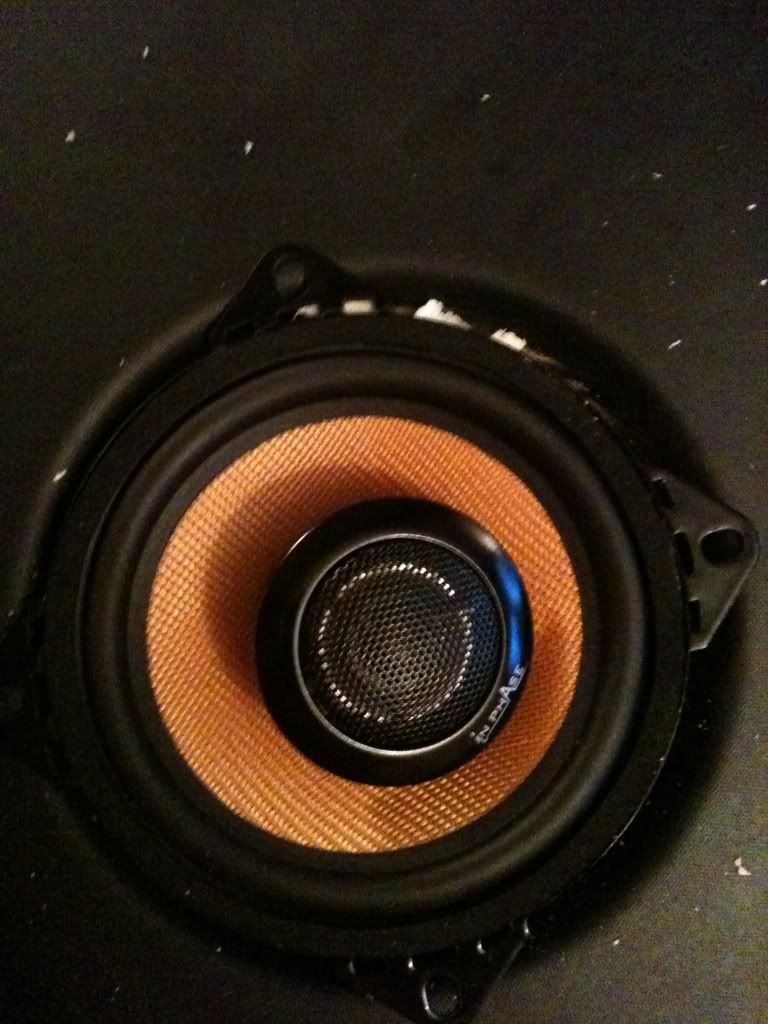

#33 Mangham54
Posted 24 June 2011 - 11:38 AM

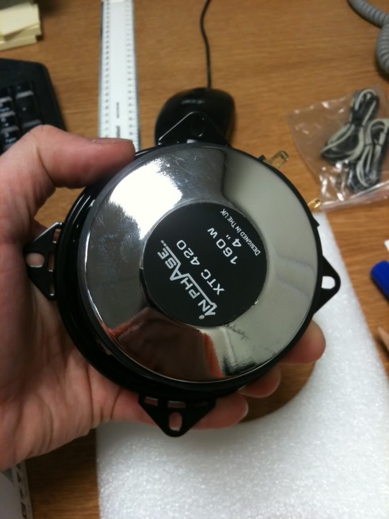

New speakers have arrived and actually look really well made:
Gonna have a look at fitting them tomorrow aft, when I am not looking at/playing with someonelses VX Posted Image
Drivers are nicely 102mm wide, but with a voice coil/magnet arrangement of just 72mm, so should drop in just lovely.
Speaker covers/grill measure in at a whopping 130mm (approx), so some tinkering my well be needed.

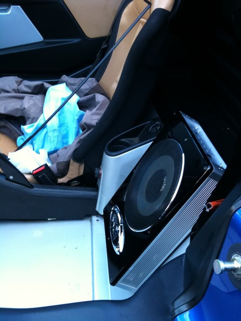

#36 P11 COV
P11 COV
  • 7,686 posts
  • Location:MK
Posted 24 June 2011 - 05:50 PM
Please dont think I'm a chav. I'm nearly 49 so dont go around annoying people with my car shaking with bass.
Its a small powered sub by Kenwood and sits nice and unobtrosivly on the shelf. It is secured with velcro.
Bit like this: There are nrewer and smaller ones out there now. Mines 6 years old.
It produces far more bass than I can handle but used senstivly it enhances the fairly standard speakers to make it sound like a good stereo in a nornal car.

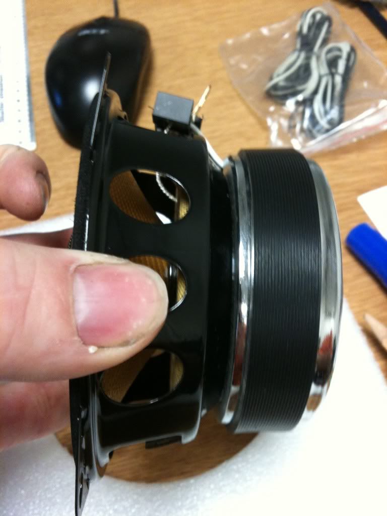

#37 Mangham54
Posted 24 June 2011 - 06:03 PM
Look forward to see how you fab up the grills on those front speakers.
Sub looks very neat. You got a link or a name so I can google it. Looks like the amp might be built in to it?
Yep the amp is built into it. It is the Boss Bass600 and was about a hundred quid.
Very tidy little peie of kit.
Now for the the front speakers, it turns out I miss judged the size slightly and they won't just drop in, as the terminals stick out about 8-10mm too much, so will probably require a small amount of the vent hole chopping out. Fortunately the grill will sit atop of the speaker driver and looks pretty good, finishing off the unit.

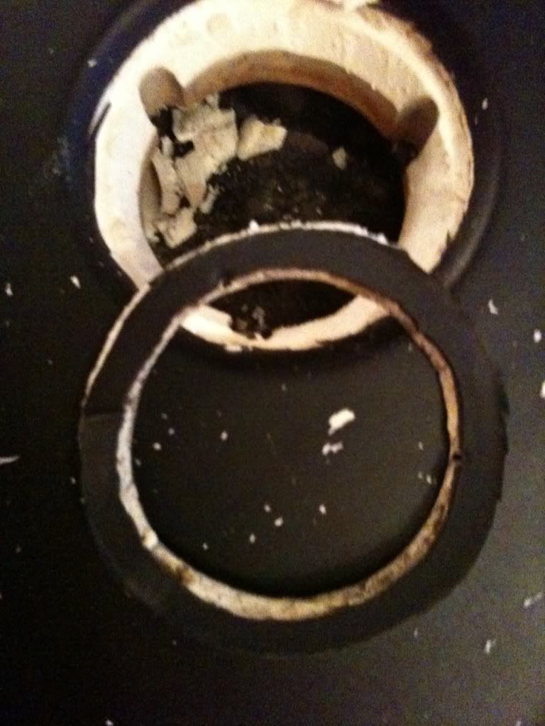

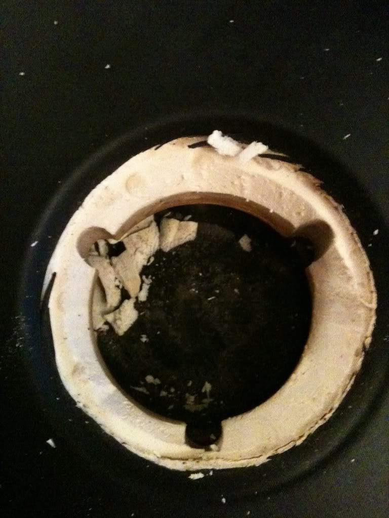

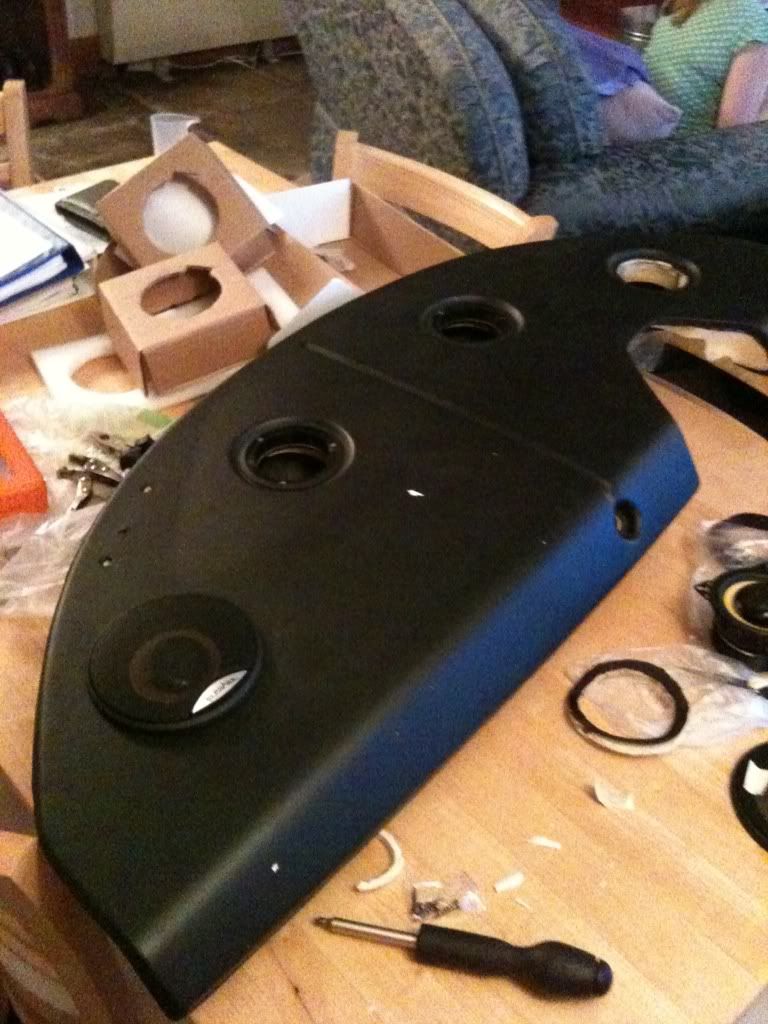

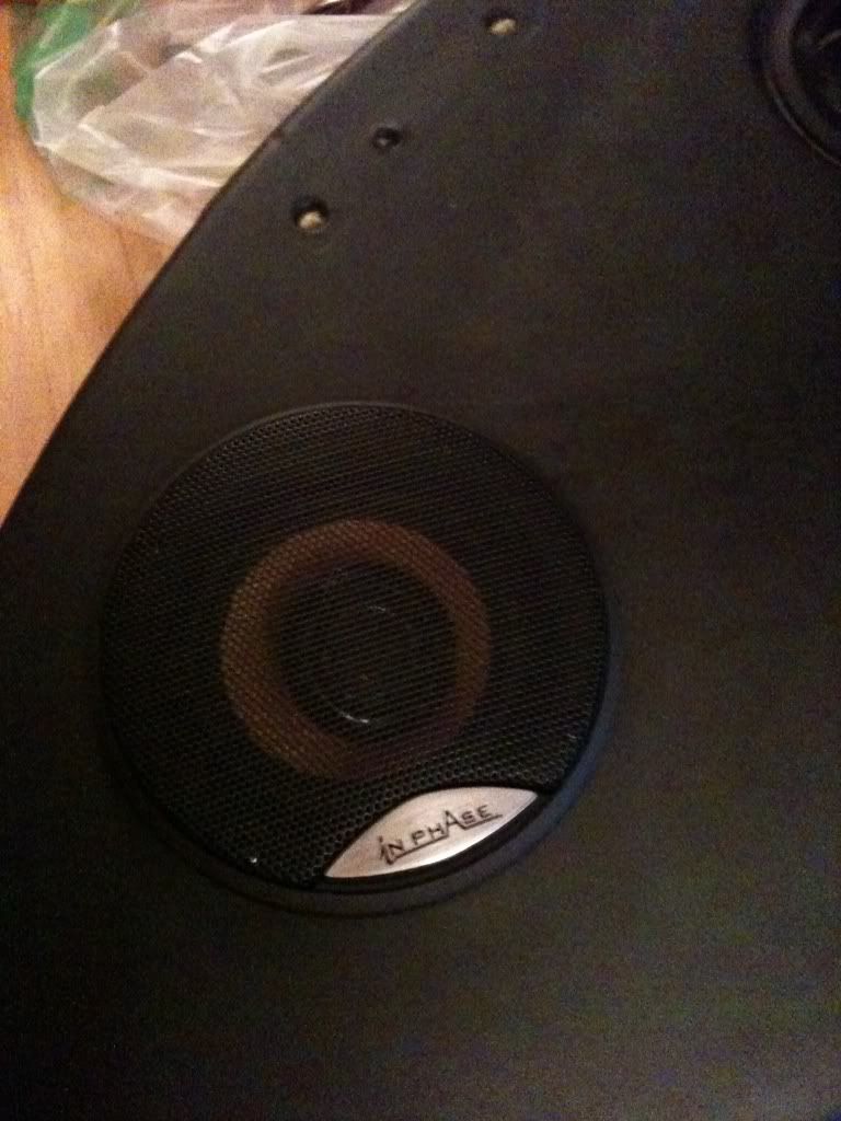

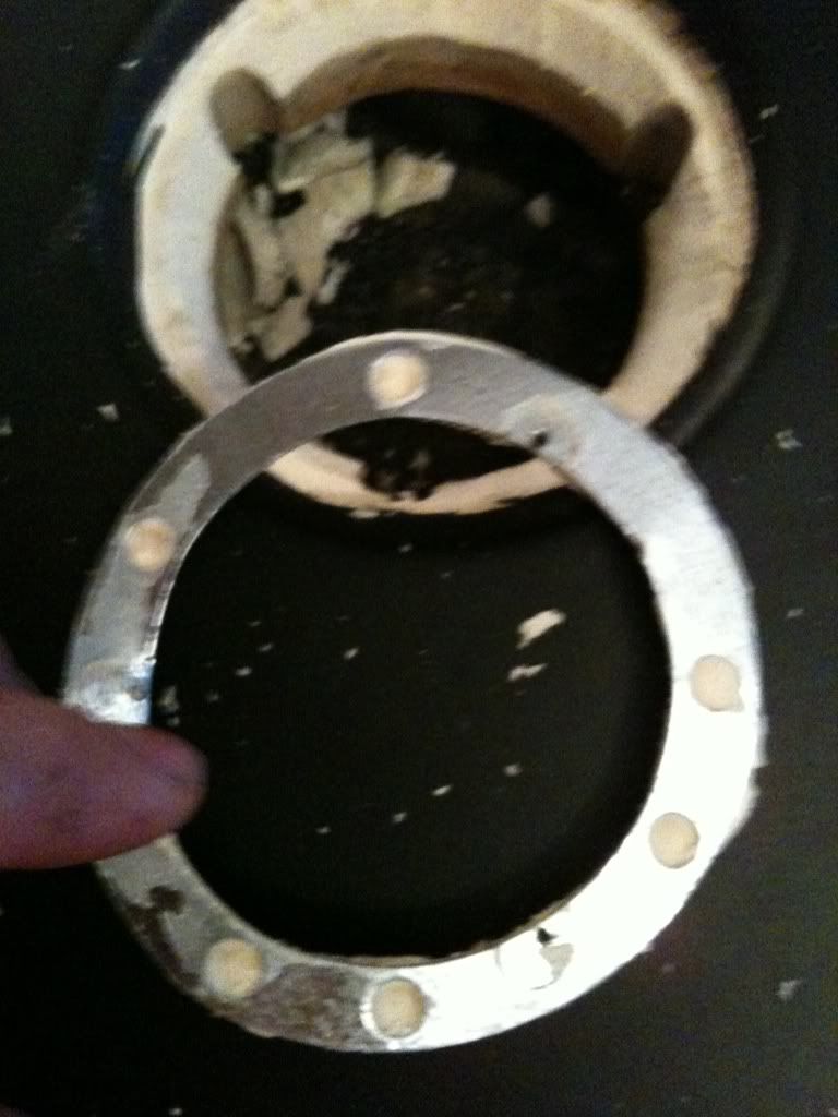

#38 Mangham54
Posted 24 June 2011 - 08:36 PM
Well, I avoided the dremel and used a spare dash unit I have.
Here are some pictures of the work in progress:
Basically, there is a metal mounting bracket under the plastic tube that fits inside the hole. If you have a reasonable vegetable knife you can cut round the edge of it, then juts peel it out.
All you have to do then is gently cut shavings in the section underneath so the carcass can fit into the newly enlarged aperture. Slowly take this away until you have a snug fit.
The beauty with these speakers is that the cover nicely sits on top of the dash and looks pretty much like it should always have been there. In addition the mounting points also sit on the lip and the screws nip into the dash top and anchor the speaker in place.
