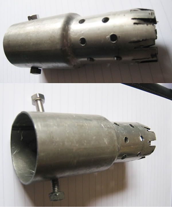

Is that just some pipe cut to size with thread for the bolts? Or does it have a capped end with holes?
#123 CocoPops
Posted 15 April 2012 - 07:40 PM
As per Martin's pic here.
It reduces the trumpet effect of the tailpipes. They amplify the sound. It's noticeably less boomy with them in place.
They start as 12inches long and have been cut down to fit. 3 holes drilled and tapped to allow m8*20 bolts to hold them in place.

Did you get them from DT in the end then, as per the link?
#125 CocoPops
Posted 15 April 2012 - 07:48 PM
Yep. £19 inc postage. So, even if they turn out to only make a 1 or 2 db difference (which might be enough for some track days) it's hardly an expensive exercise. I'll get a with and without noise test done at Abingdon to see what they do.

Abingdon was it's first track day under my ownership.
I used the db reducers above and got 92.3db, so well under the 100 requirement.
#132 smiley
Posted 05 May 2012 - 11:35 AM
How did the power feel with the reducers in?
#133 CocoPops
Posted 05 May 2012 - 11:38 AM
No different. All they do is reduce the trumpet effect of the large "decorative" part of the tailpipe. The flow isn't changed.
