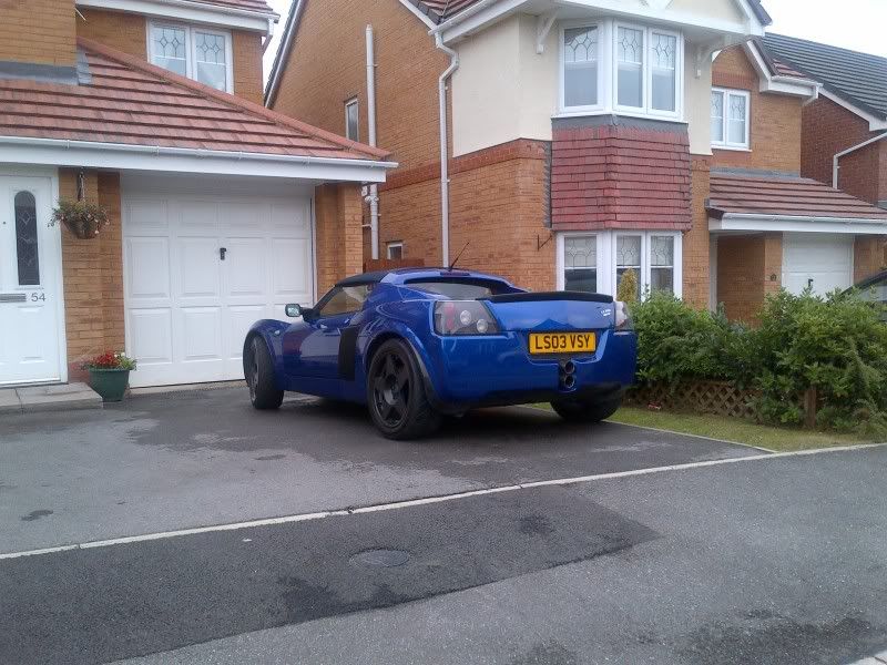

Quick Piccy:

Quick Piccy:
Looks good. thumbsup
