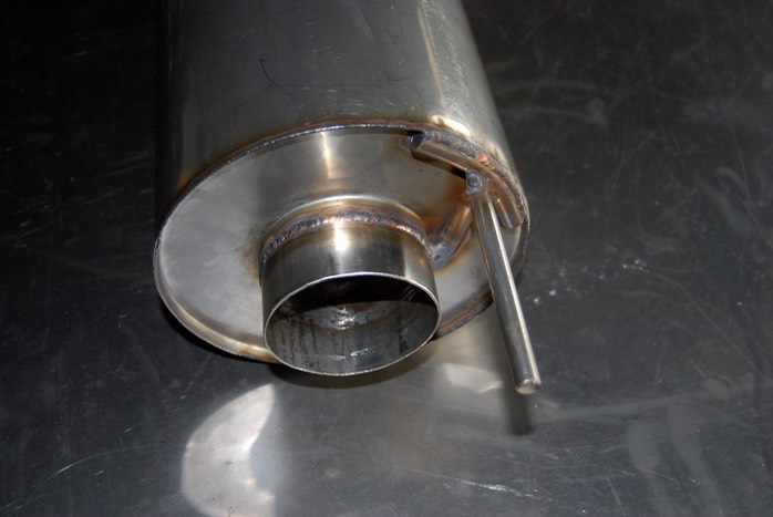

Progress so far on the silencer, 28" long x 7" diameter. I have made it so I can swap outlets to see if it makes any difference to the noise, will be trying a single outlet to start with.
Once I get this finished and in position I will see what room is left for a "pre silencer" and make accordingly.
Packing is from Thermal Velocity.
Dave

How many chambers in it Dave? I think mine had 3 chambers, but it's noisy as hell. Noise is really big issue for use 300+ BHP lot, so worth really concentrating on that.
Looks like great fabrication (as usual !).

Nev there are 2 chambers as there is a support for the perf' tube in the centre.
Tim you are welcome to drop in some time, I also work late a few nights a week just give me a ring to make sure I'm there.
I've fitted the silencer today, It's certainly quieter now and there is room for a 5" x 13'" pre silencer which I will make in the next week and see what effect that has.
I'm using a single tailpipe angled towards the floor at the moment but I can change this later for a twin or oval again to see if there are any differences.
