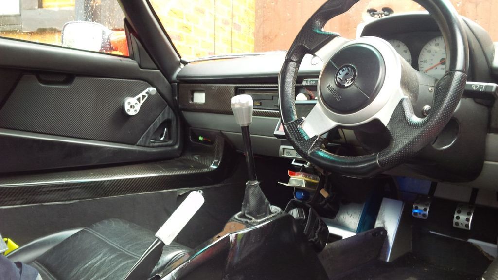

Sorry for the late reply. To extend the lever I just:
Bought some steel tube that was suitable for (internal) tapping the same size thread as the gearknob. I cut a section off the tube about 100 mm long and internally threaded both ends.
Then I cut some studding (threaded rod) to about 100 mm. I slotted the 100 mm of studding into the gearknob.
Then I used the intenally threaded tube to connect between the gearknob and where the gearknob would normally be screwed.
Result including use of short shifter:
Less chance of selection 5th when you are trying to select 3rd because the left to right movement is increased due to the lengthened throw.
Similar movement front to back to standard setup due to shortshifter cancelling out effect of long gear lever.
I have tried various combinations of std, longer, much longer, a little longer extensions until I found the desired result. Overall happier now than totally standard

Paul, How much longer is your lever now?
I will go and photograph.....
Kindly Paul
#47 Paulus H
Paulus H
  • 2,063 posts
  • Location:DE65 5NX
Posted 16 June 2016 - 11:03 AM
Kindly Paul
Here is the picture. Gear knob now closer to wheel, easy precise shifts. I would say around 70 mm longer
    I will go and photograph.....   Kindly Paul
Paul what's that screen? Thanks
