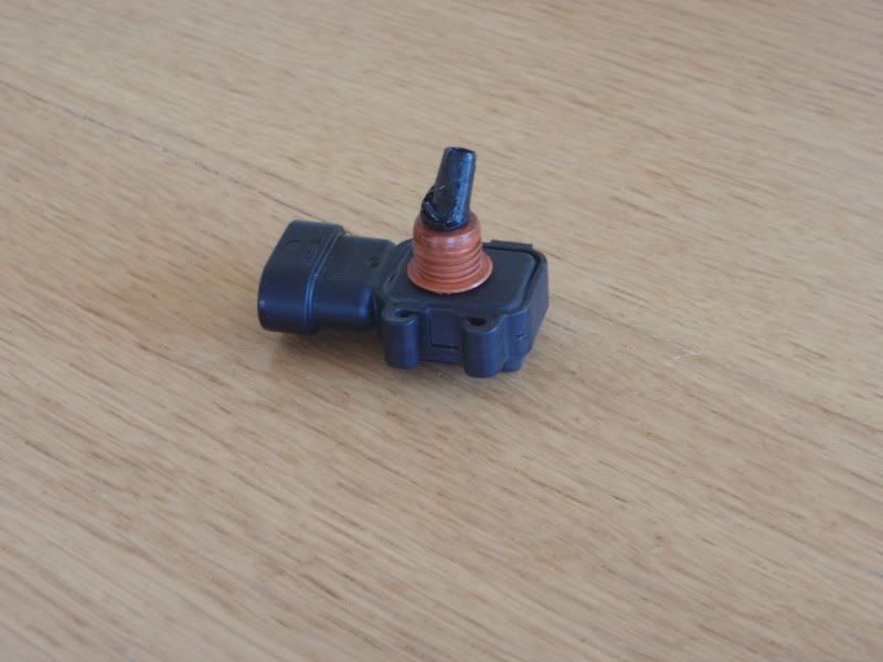

Got the time to take away the old MAP sensor today while the new one is on it's way.
I think the old one might be broken.......
But why?
Have I done something wrong that might cause this?
Edited by OneYet, 01 May 2012 - 09:03 AM.

Did you seal it or fit it dry as with this map sensor it doesn't fit perfect you want to smear some sealer around it so it doesn't move or leak . Once changed car will be good as that is well buggered lol
I fitted it dry with a home made alu clamp holding it in place.

I think it requires a Joe mod with some electric tape at a specific location for a tight fit.
Wait for someone who can tell more details on this.

EEEHHRR! :blush: Joe Mod. Insulation tape, tight fit. It all came back to me. My face turned red. The black thing that looks just like insulation tape in the pic is insulation tape. Applied by myself under the orange seal to increse the diameter to make it a tight fit. I am so ashamed. And happy in a way. Now I know the rootcause. I knew it was a bad idea to modify my car myself..... Is tigerseal around the base of the sensor the next way to go?

silicon it in place, let it go off and jobs a good'un

Still use your Ali clamp but put some sealer around it clamp it down not to tight job done .:-)
