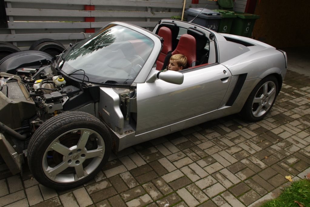

Finally my JOY/TOY has arrived, and can't describe how happy and exited I am :groupjump: Always wanted a car toy what I could upgrade, modify, and have fun even cleaning it :)
Have done prety the same project diary for my motorcycle, and i liked it, get some great ideas and suggestions from the side, and even for my self after some time it was fun seeing the progress from the beginning.

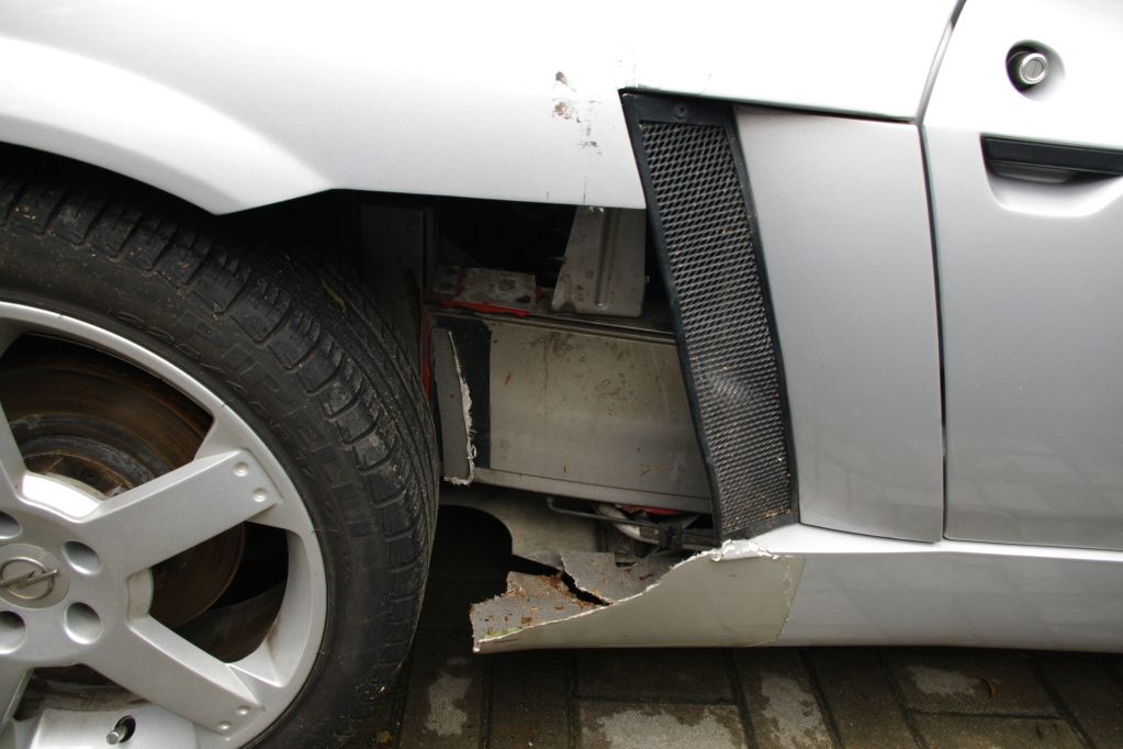

It's 2002 silver N/A, absolutely stock with 70k km on the clock, with front and right side damage, just plastics, the frame, bottom and chassis are mint... Oh and haven't figured why, but the clutch is not working, has checked the DOT fluid, and it was missing, added, some, but there is a leakage somewhere....
The test driver is already in his place :

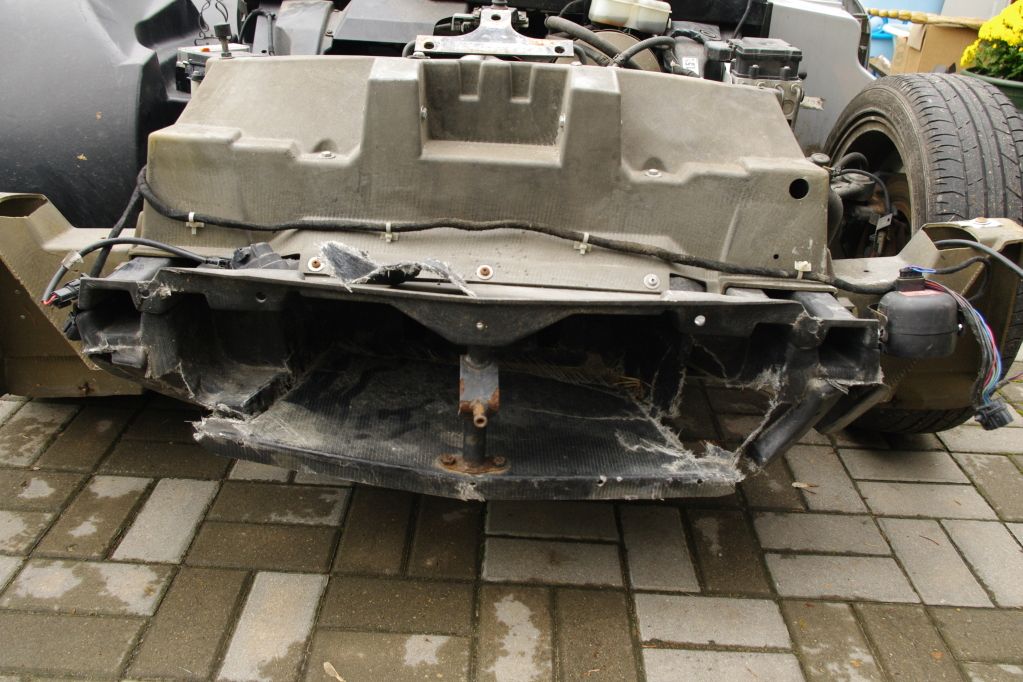

from the photos didn't expect crash box to be damaged, but it is as it is. Think it's an easy fix:
That part will need replacing:

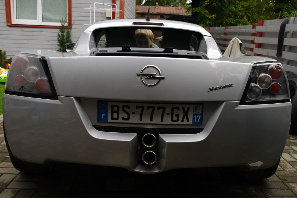

some cracks on the rear:

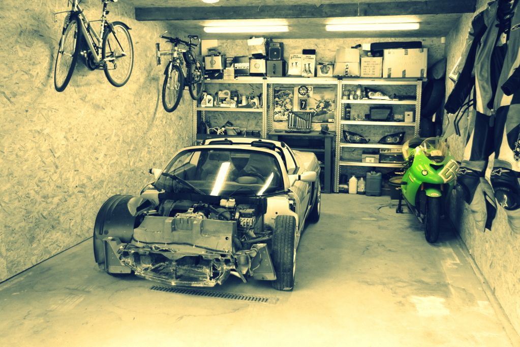

And here is my hobby room ( wife hate this place :angry2: ) :
The whole car will need respraying. Wife is already asking the car to make red, friend is telling that it cheaper and more simple to spray it in the same color... But why live in the easy way, when you can do it in the difficult one :) ? Have seen few photos of a mandarin VX from sweden, and i liked it so much, amybe will go mandrin, Kawasaki green is also an option... probably will change my mind million times before the time comes to respraying.

You mean before you are perfect and can then do mine ;) I wll be watching this thread with interest, although witht he condition of your crashbox, I would probably reccomend a replacement. If the bit that was damaged was the bit that got broken, it would be the same in the next instance... I would always replace a crash box as i would rather be safe that the car will keep me safe again ratehr than have a repair fail or not work in the designed way.

both of side sills are damaged, so some how i'll need to take off it to fix one, and to replace another, so probably the car will stay in the garage, I'll just need to take the plastics to the painters. Could any one tel if there is any difference in side sills for N/A and turbo model?
#7 vocky
Posted 10 October 2012 - 12:44 PM
you would have to fit the vxT side vents if you use the vxT sill
Might be better to repair whats on the car, you can get that section on ebay http://www.ebay.co.u...=item1e654b7aae or http://www.ebay.co.u...=item1e6dfb652d
genuine used sill http://www.ebay.co.u...=item2ec1e7d4b7

That crashbox really needs to be replaced. Damage is extensive and it's probably compromised. :blink: It's quite specific in it's construction and if repaired it most likely won't perform correctly in a crash when it comes to absorbing the crash impact energy by de-laminating in a specific way. Your decision of course, but I would source a new or un-damaged original one and replace it completely for peace of mind. :poke: Bye, Arno.

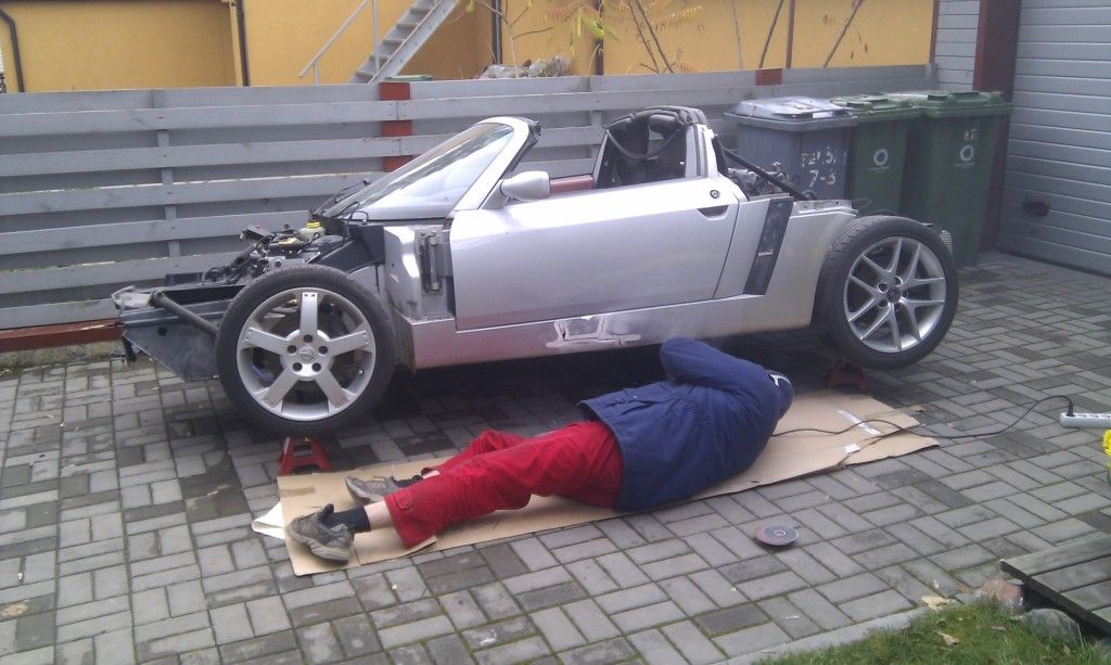

Few evenings in the garage, no rush and the car is striped down :

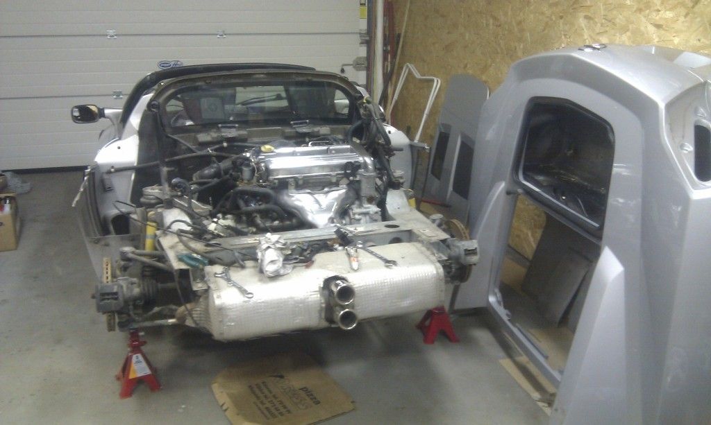

Waking up from my winter sleep and getting back to the project at full power! Did some body fixing during the winter, bought some stuff for a car like drilled brake discs, armored brake lines...

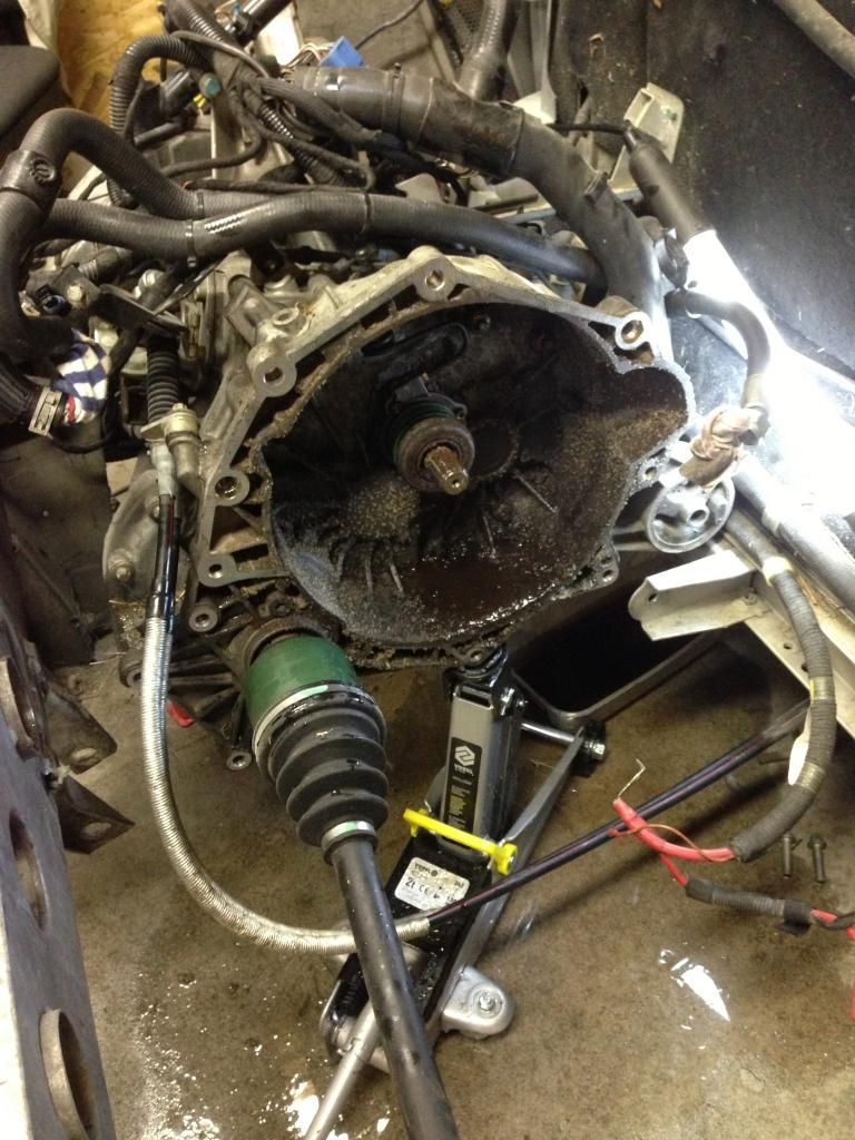

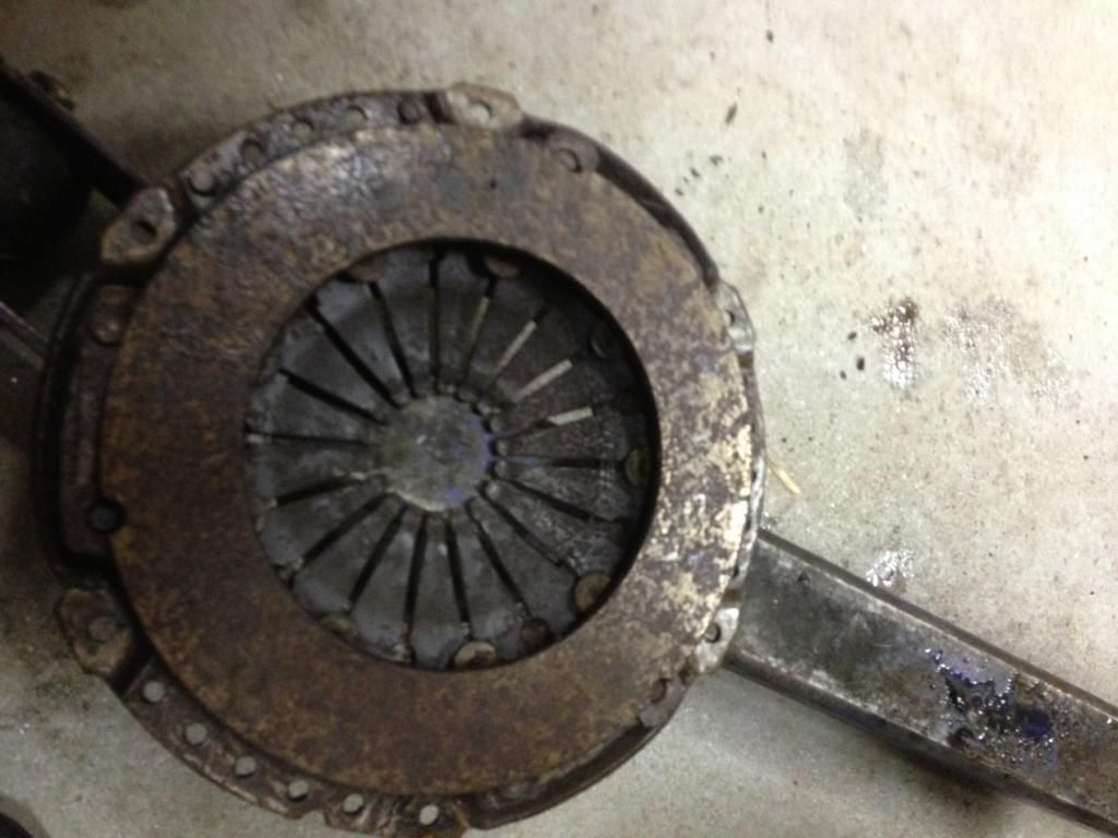

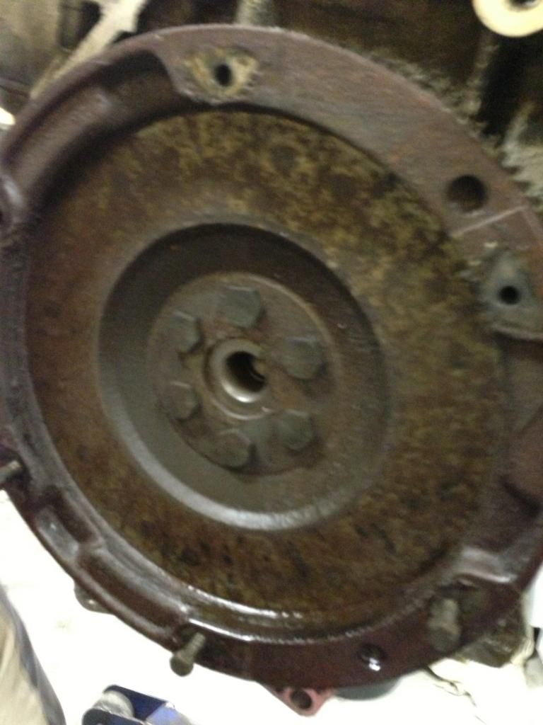

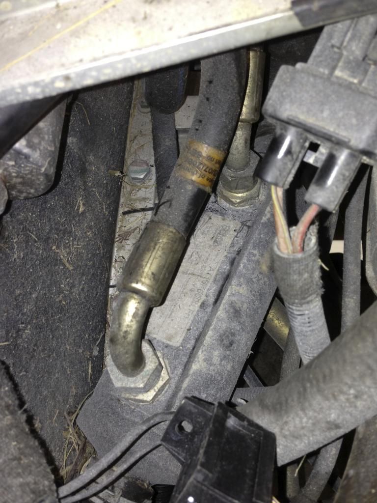

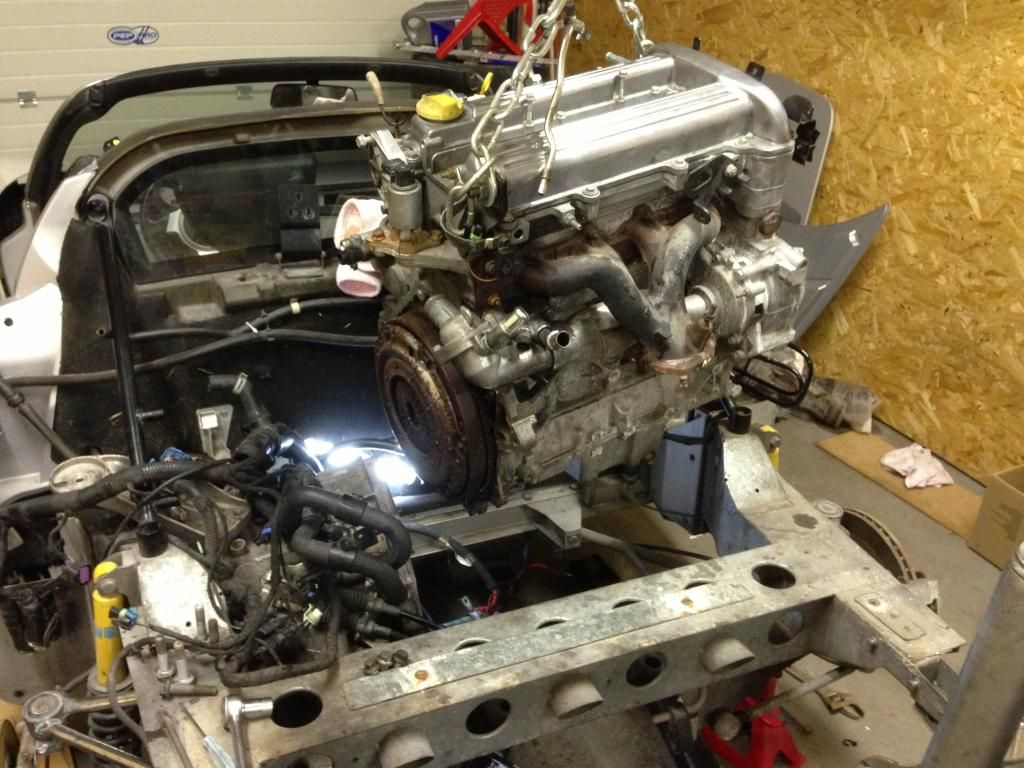

As mentioned before the clutch was gone, and as the brake fluid was disparaging the diagnosis was - dead slave cylinder. So decided finally to change it. After seeing some photos in the forum with engine out, add gear box hanging in place, decided the easy way to change the clutch cylinder is to remove the engine. Actually didn't want to disconnect drive shafts from the gear box. So after few hours the engine was out:
not sure it's the easiest way to change the clutch, but as you'll see next it was the right decision to take the engine off.

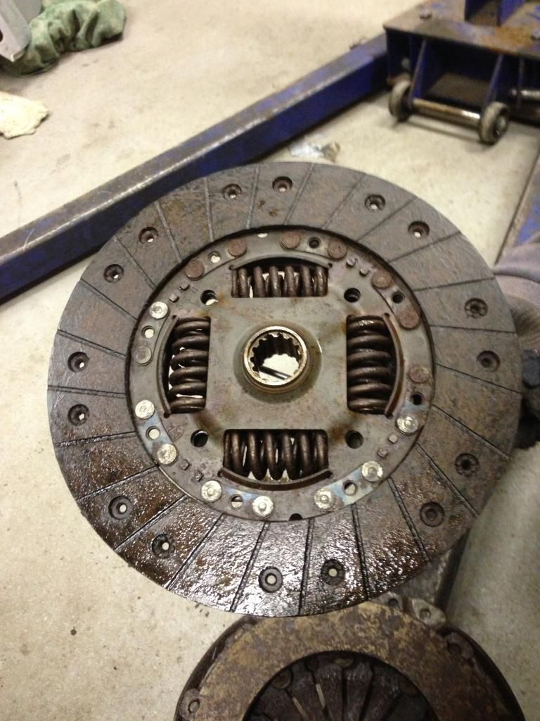

That's how it looked inside the clutch room:
Looks like not just slave cylinder needs replacing:
even the car has covered just 70k kilometer I was planing to change full clutch kit, so wasn't disappointed about what I have found, it even gave me the reason :) but thats where the good stuff ends, and my nightmare begins:

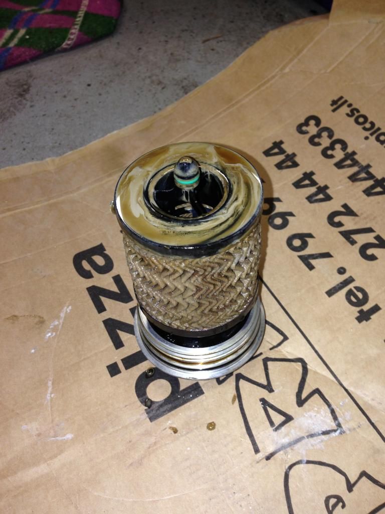

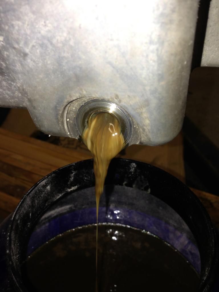

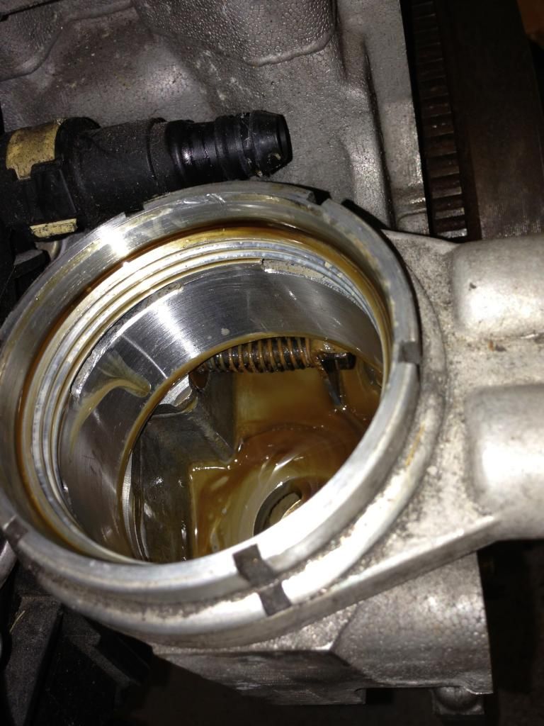

My friend, who's helping me with the project, while disconnecting oil cooler hoses noticed strange oil color, so we opened the oil filter cap to see what's going on and that's what was waiting us:
s643.photobucket.com/user/stafas/media/Speedster/IMG_0299_zps6060445d.jpg.html
You can imagine ho happy I was, as I bought a car after a car accident, not expecting to find a bad clutch cylinder, and especially not expecting coolant in the engine .... :wacko:

After reading some few hundred posts in this forum, I am almost 100% sure that this mother f#@ker is guilty for this:
few pictures from oil drain :
there were no oil at all in the cooling seestem.
Any diagnosis approval from authoritative members ?

are you sure your car has not been in a flood or submerged under water ?
