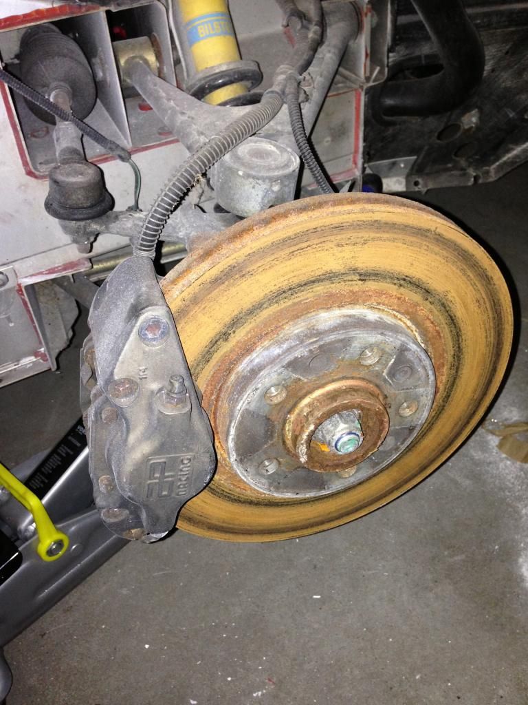

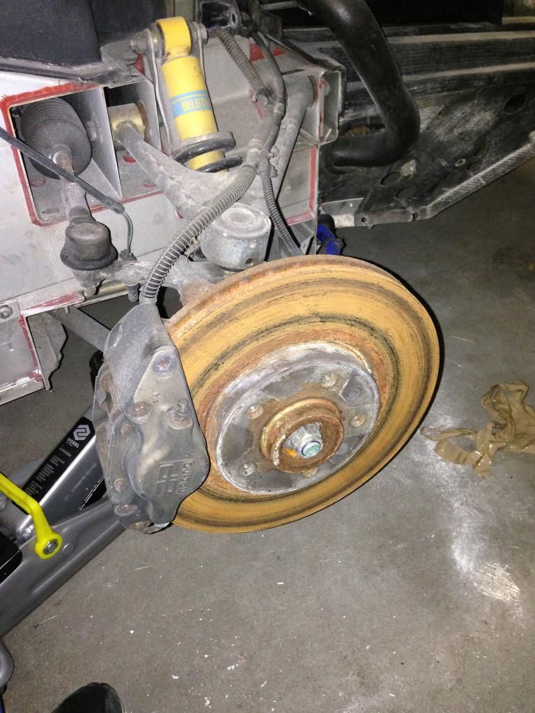

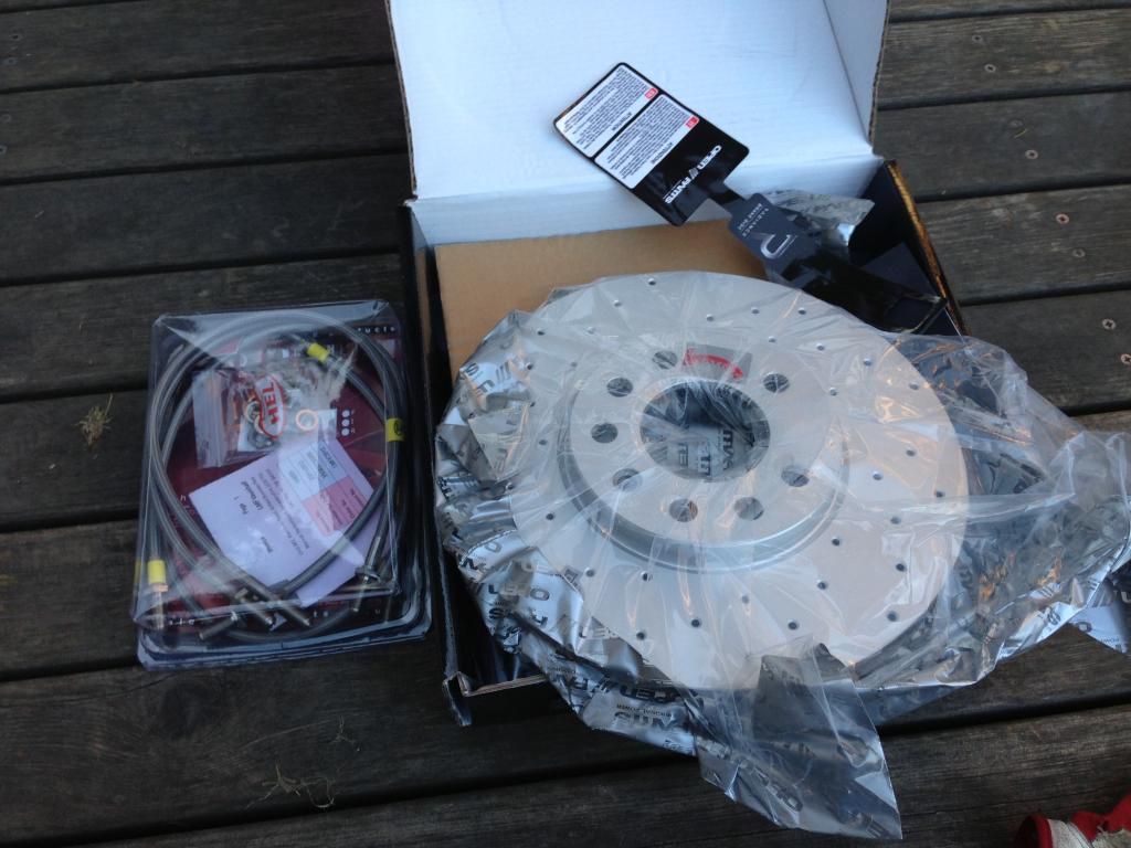

The old brake discs had a plenty of life in them, but there very rusty:

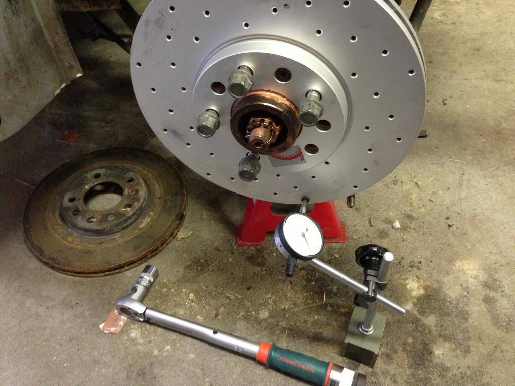

so decided to change them to new nicer looking drilled and painted discs + armored brake lines:
did the installation according to all instructions :) :

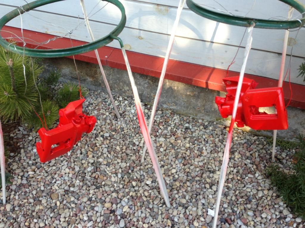

after a lot of thinking, decided to go for a red brake caliper color (think best choice for a silver car):

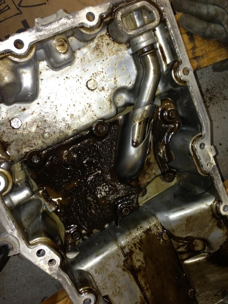

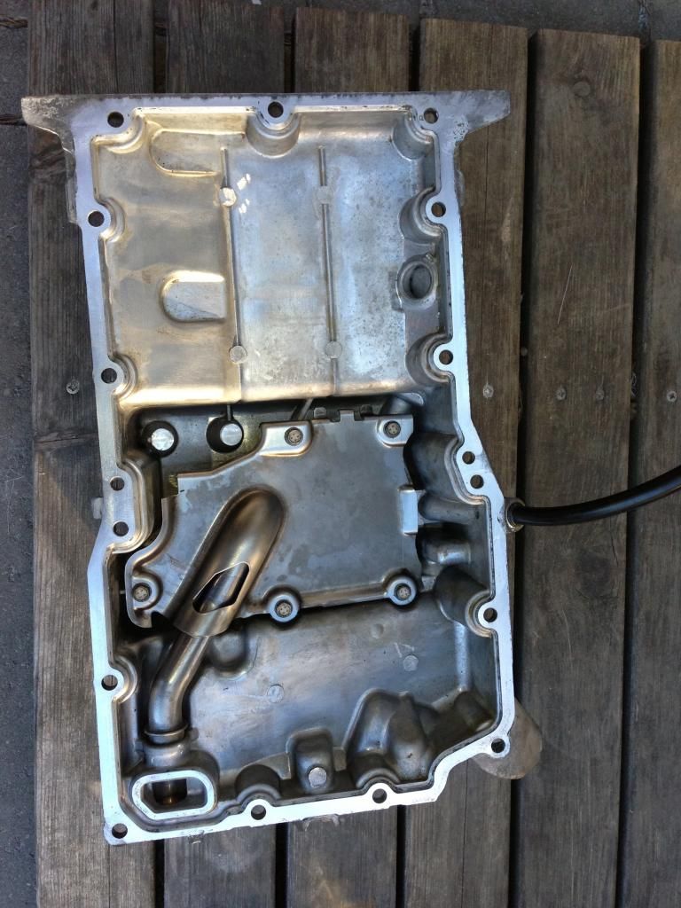

the engine was disassembled to check the head for a crack. The answer was negative, so with new gaskets and valve seam seals, new belt tensioner, new clutch was assembled back. Some pictures of the oil pan:
before:
and after cleaning:

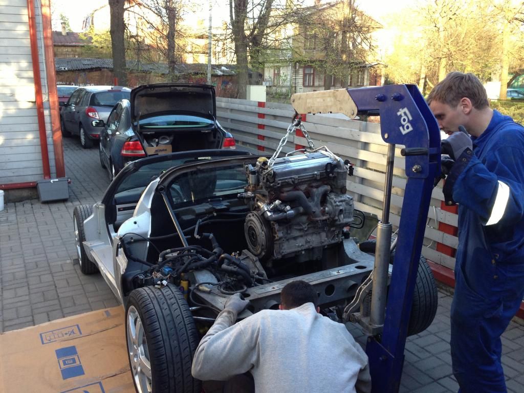

Putting back the engine in to the car was way easier than getting it out:

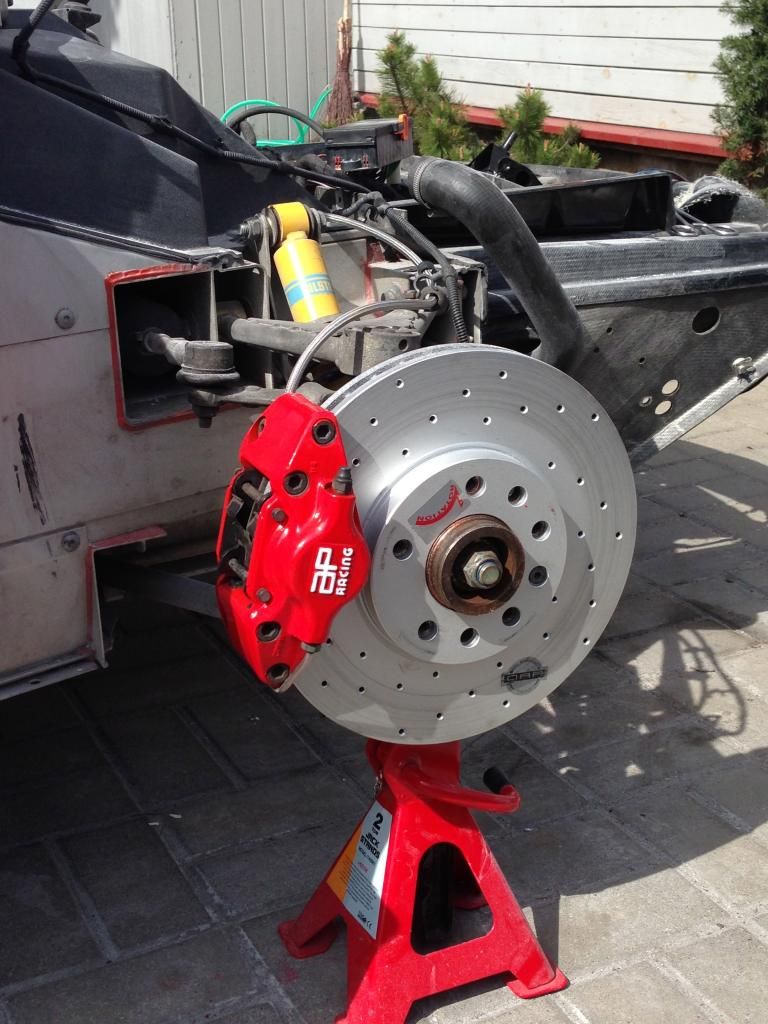

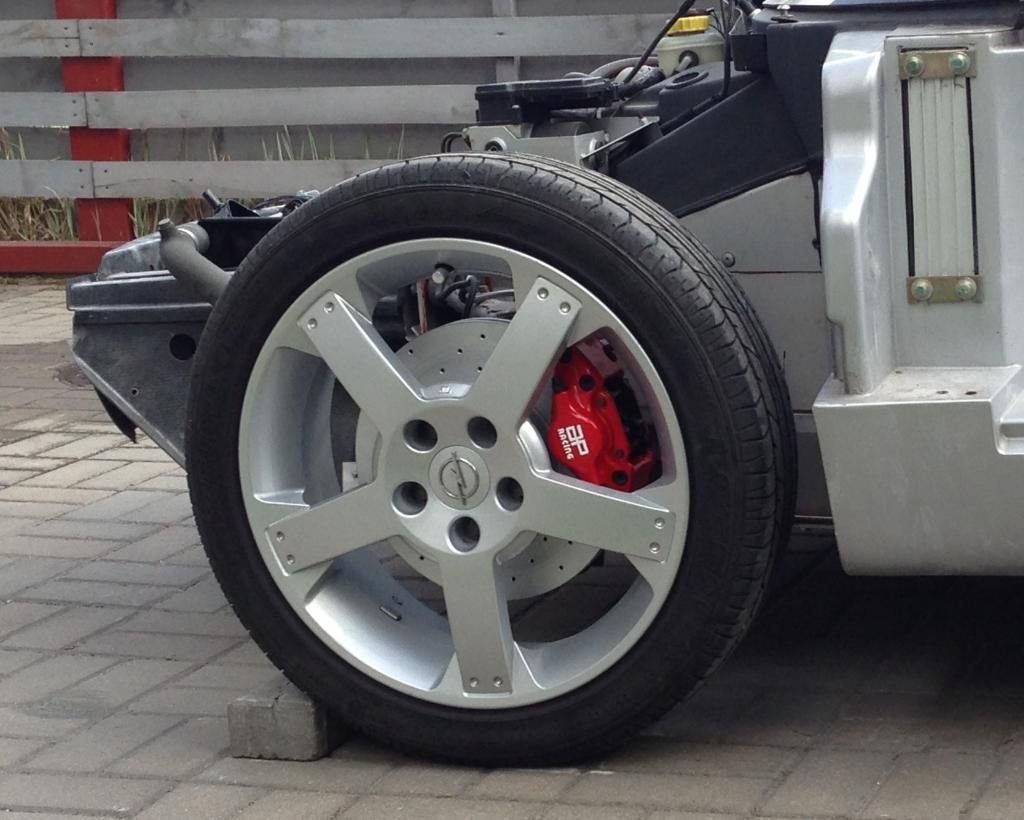

some changes in the brake system:
before:
and after ( new drilled discs, Hel brake hoses, painted calipers, Ferodo DS perfomance brake pads):
with a wheel on:

Those calipers look great one job I still need to do on mine.
#40 Bumblebee
Posted 09 May 2013 - 09:24 PM
:yeahthat: although I'm not sure if its best to leave them as they are as the paint might go flakey,they do look good though :)
