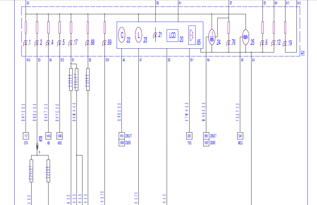

OK so on the following electrical diagram --
The airbag is connection H1 - .4 (black and violet)
The ABS is connection H1 - .5 (black and yellow)
The Coolant level is H1 - .69 (green and white)
Each control an LED on the dash.

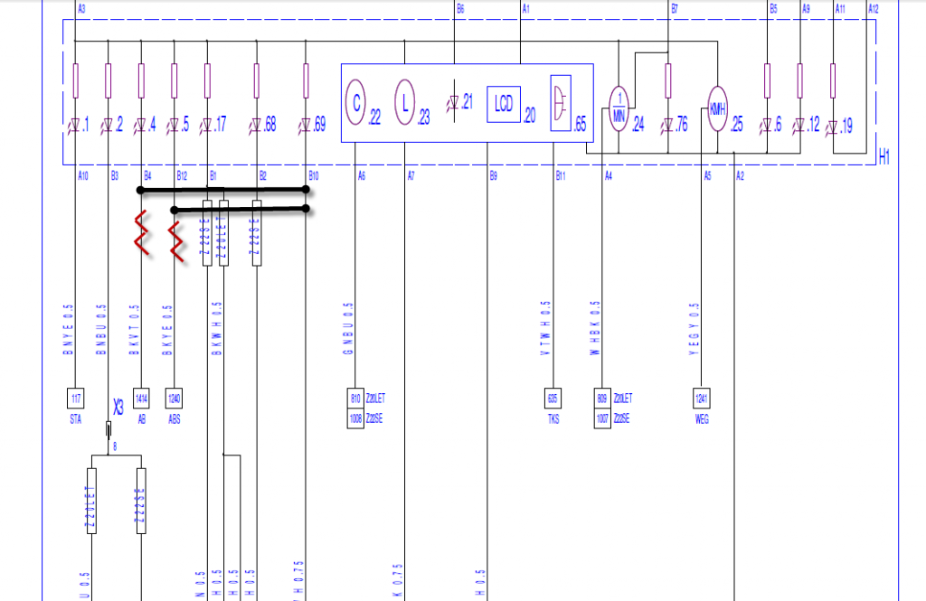

So if I cut the cables and wire the secondary ends from the signal cables of the airbag and ABS and splice them into the signal wire of the coolant level switch I'm assuming I will have three LED's which now operate simultaneously with the coolant being the actual signal which operates them no....?
Can anyone envisage any issue doing this? Don't want to short anything out and kill my stack!
modified wiring

In the second diagram though I'm talking about 'slaving' the abs and airbag light onto the signal wire for the coolant level. Worried it may cause an issue I've not considered.....

The current condition of the car is that the error lights are on all the time as the systems are gone (an mot failure). Disabling the lights then re-establishing this condition for an mot at a later date is no good as it's still a failure. I'm not going to refit the abs or airbag, just looking to maybe put the car on the road one day as it is. They have to light up on ignition (lamp test) then go away whilst car idles. I can't see why modding the circuit wouldn't work as there's plenty of wattage either as I'm not looking to short it to ground like Vocky mentioned I'm looking to slave it off another output but I'm paranoid about frying the stack completely..... Which spring rates did you go with in the end George? What's yours like on the road?

They'd work, certainly less risky and would avoid the embarassing moment when my coolant runs empty and the dash lights up like a christmas tree :lol:

Personally I wouldn't have a problem with my dash lighting up like a Christmas tree if my coolant ran low! Zoobeefs solution is much more elegant, yours should work but you may get different brightness across the 3 LED's as the different Colors (or aare they all red? Shows how much attention I pay!)will have different resistances. And as said your will all go on and off together. Which is not what should happen!
