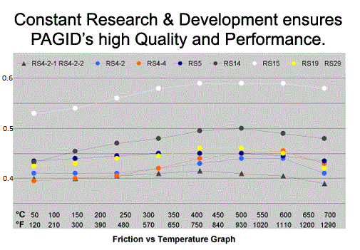

Typically compounds from the same manufacturer follow similar temperature profiles - so look at the graphs ideally when mixing pads. That is a recognised route...hawk even state a particular pad is used mostly for that purpose.

As for coefficient curves then the Pagid RS42, RS14 and RS15 all follow the same trends
