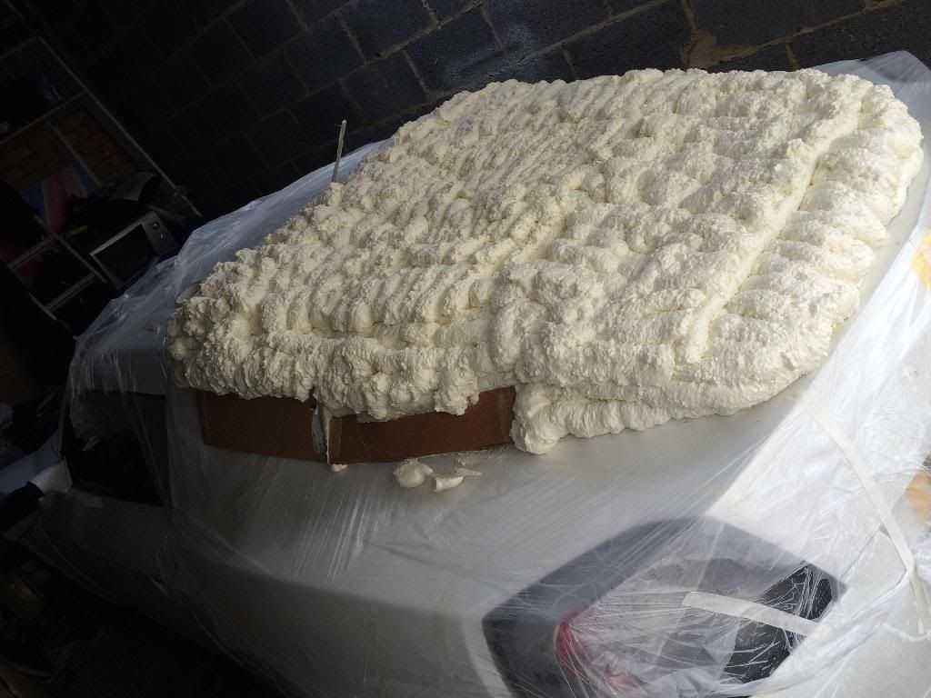

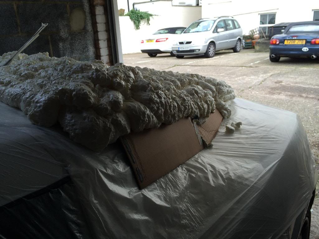

So I finally gave in to the spray foam Gonna let it cure And attack it with a sharpe blade soon

I hope you have put some sort of barrier on your car.

#5 FLD
Posted 17 February 2014 - 03:24 PM
Good job.  You might've had a permanent coupe otherwise!
Piece of kingspan might've been easier though.

#8 Baron Von Scubadaddy
Posted 17 February 2014 - 03:27 PM
Finding it hard to resist taking a blade to it But I know it's still soft inside !!!

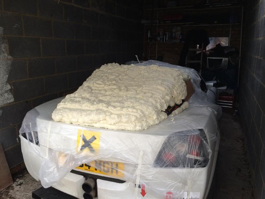

#11 Baron Von Scubadaddy
Posted 17 February 2014 - 03:41 PM

How many cans/tubes of foam was that BVS?
#14 Baron Von Scubadaddy
Posted 17 February 2014 - 03:54 PM
It's gonna get all vac bagged and carbon various later on I do love a bit of arts and crafts !!!!
#15 smiley
Posted 17 February 2014 - 03:58 PM
So this is the creation of the form, on which a mold will be taken, and then the final product?
#16 Baron Von Scubadaddy
I used 8 cans I have a gun for the cans makes it easier to use Didn't fill the whole void I packed it out a bit
Edited by Baron Von Scubadaddy, 17 February 2014 - 04:07 PM.
#17 FLD
Posted 17 February 2014 - 04:00 PM
8 cans!  Jesus.  Would it not have been easier / cheaper to by PU foam board?
#18 Baron Von Scubadaddy
Posted 17 February 2014 - 04:07 PM
yep
but I'm kinda not near that kinda stuff and screwfix sells their cans at £3.45
and the foam goes where you spary it so u minimise the time spent shaping and cutting
well in my mind I do.....
shape and then coat with a layer of filler
then a layer of grp and fill and sand and then it should be next christmas and I will have more time to finish it off !!!

#20 Baron Von Scubadaddy
Posted 17 February 2014 - 04:11 PM
I'm not sure about how high to have the the rear section
I quite like it raised but not as high as it is at the moment.
