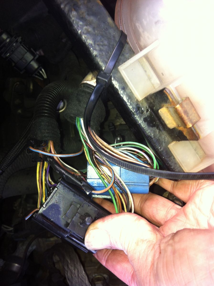

We were looking at the above too, one of the connectors done, time ran out in the end anyway. There has been some wiring altered with the blue and black plugs. Neil has a pic, the one on throttle pedal has deffinate bad corrosion on second from bottom pin, plug side. Not sure on condition of corresponding pin. Ran the throttle body actuation from opcom, that works and the pedal position voltage does change when depressed. Actual fault says no correlation.

#10 Acidpopstar
Acidpopstar
  • 3,556 posts
Posted 14 March 2014 - 08:33 AM
Above is a pic of the altered wiring on blue and black plugs. Ivan, if you have any time over weekend I would appreciate your guidance :)
#11 fezzasus
  • 7,689 posts
Posted 14 March 2014 - 08:37 AM
That wiring looks a mess. I would set it back to how it should be before continuing to trouble shoot.

Posted 14 March 2014 - 08:58 AM
Bit difficult to see on the phone , what are the colours of the wires that have been messed with in that pic? Any continuity checks been done?
#13 smiley
Posted 14 March 2014 - 09:20 AM
Your wiring seems to be making a fast u-turn.
Here's how they are stuck oem.

#14 Acidpopstar

#16 Crabash

#17 Crabash
Crabash
    Scared
  • 1,686 posts
  • Location:Durham
Posted 14 March 2014 - 11:25 AM
Cant remember the wiring bodge properly but Im sure there aas a wire or 2 linked from one plug to the other or cut off o e plug and spliced into a wire from the other.
