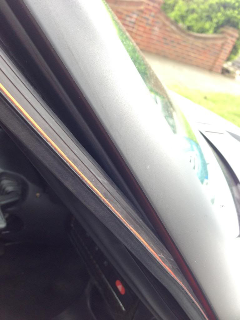

I've just fitted these, they seem to have stuck really well just using the sticky strip. I just cleaned up the surface using meths spirit beforehand.
Worth noting for people that didn't know, the ribbed flappy bit (hehehe) on the seals slots under the windscreen surround, it pretty much clips in.
Like this:
Posted Image[/URL]
See at the bottom it's pushed in, once all of it is slotted in it holds it in position quite well. Then pull the backing off the sticky strip and it's all done :)
