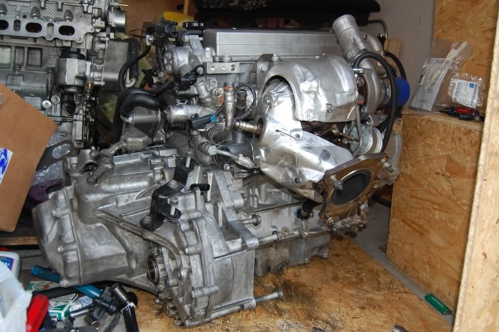

Well, you can simply bolt-on the factory turbo gobbins of the latest DI 2.0 LNF/NHH) engine onto the Ecotec head. But not in a VX without sacrifying your boot space.
Currently looking into a turbo conversion for someone and already spending way too much time on R&D-ing a suitable manifold... :sleep:

get rid of the bulky precat and it will fit , remove the bolted on turbo intake pipe extension as well

You have to go down with the turbo to make it fit (NA trunk that is).
We're figgering out how to make an affordable and good manifold and then.... Turbo's for the win!

The boot will have to be chopped, almost inevitably, but if you can keep the turbo outlet below the level of the cam cover, you should be able to avoid messing with the boot lid drainage channel and catch, so just reshaping the inner profile of the boot - a few like Vocky have done this for different NA manifolds.
For big turbo's yes, a different manifold design maybe, but I highlighted the above LNF (or current Astra VXR, and other Vauxhalls) as it comes with a completely bolt-on option with a twin-scroll manifold / turbo design, and all the coolant / oil lines ready to go. You could also in theory go fit something from the likes of ZZP which are designed for LSJ's or Z22's
