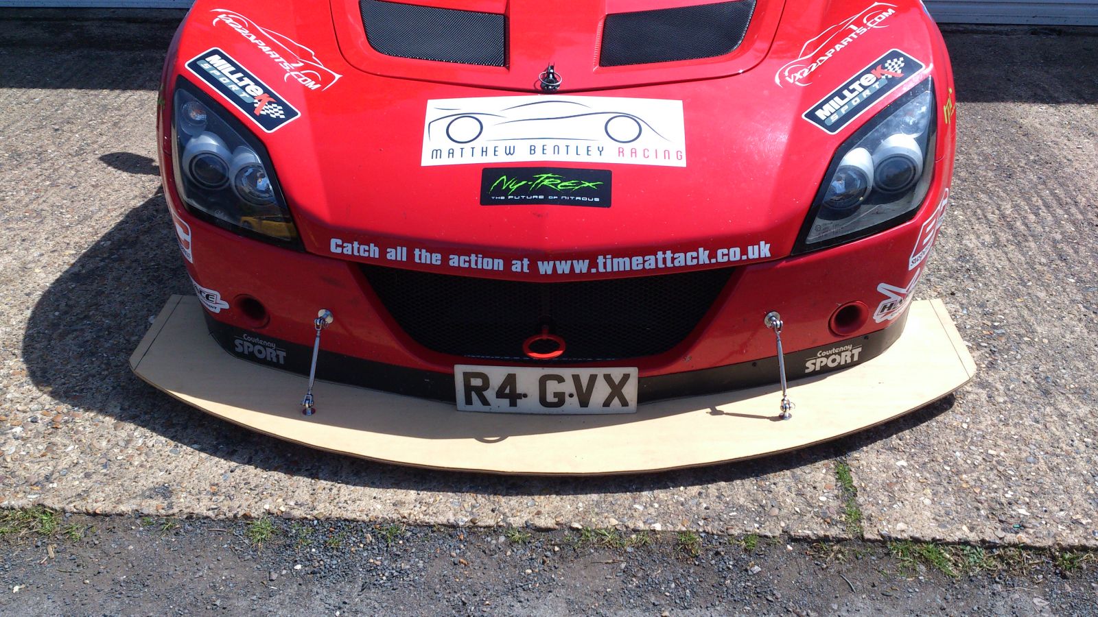

Have you thought of making a splitter out of wood? Some guys in here have done it and painted it black??

I fitted a splitter to a friends lotus elise s2 yesterday, really shocked how different sizes the front clams are The wood splitter keeps crossing my mind, check mikes time attack car in Google images

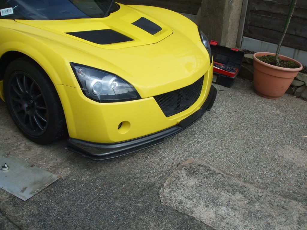

#5 FLD
Posted 01 November 2014 - 01:29 PM
Make some infills like this:

#9 FLD
Posted 03 November 2014 - 06:27 PM
That one is on stueys car

#11 FLD
Posted 05 November 2014 - 08:46 AM
Yeah, its one I made a while ago.

#18 mbes2
mbes2
    Someone say Plasti Dip?
  • 8,516 posts
  • Location:Feering, Essex
    "Yes, I built it"
Posted 25 January 2015 - 01:13 AM
An old thread.... But MBES2 can you please tell me where you got those turnbuckle bolts from? I'm considering a similar splitter and fixing method, but the only turnbuckle's with nut and bolt ends I can find are £20 each (bit steep when chandlers sell handsome non-nut-and-bolt equivalents for about £3 each). Cheers in advance. Ben.
PS: If anyone's got a photo of the 'steel cable through the towing eye' fixing solution for splitter, please post. Thanks.
These ?
http://www.carbonmod...s-tie-bars.aspx
#19 Andrew aka Stuwy
Posted 25 January 2015 - 01:31 AM
