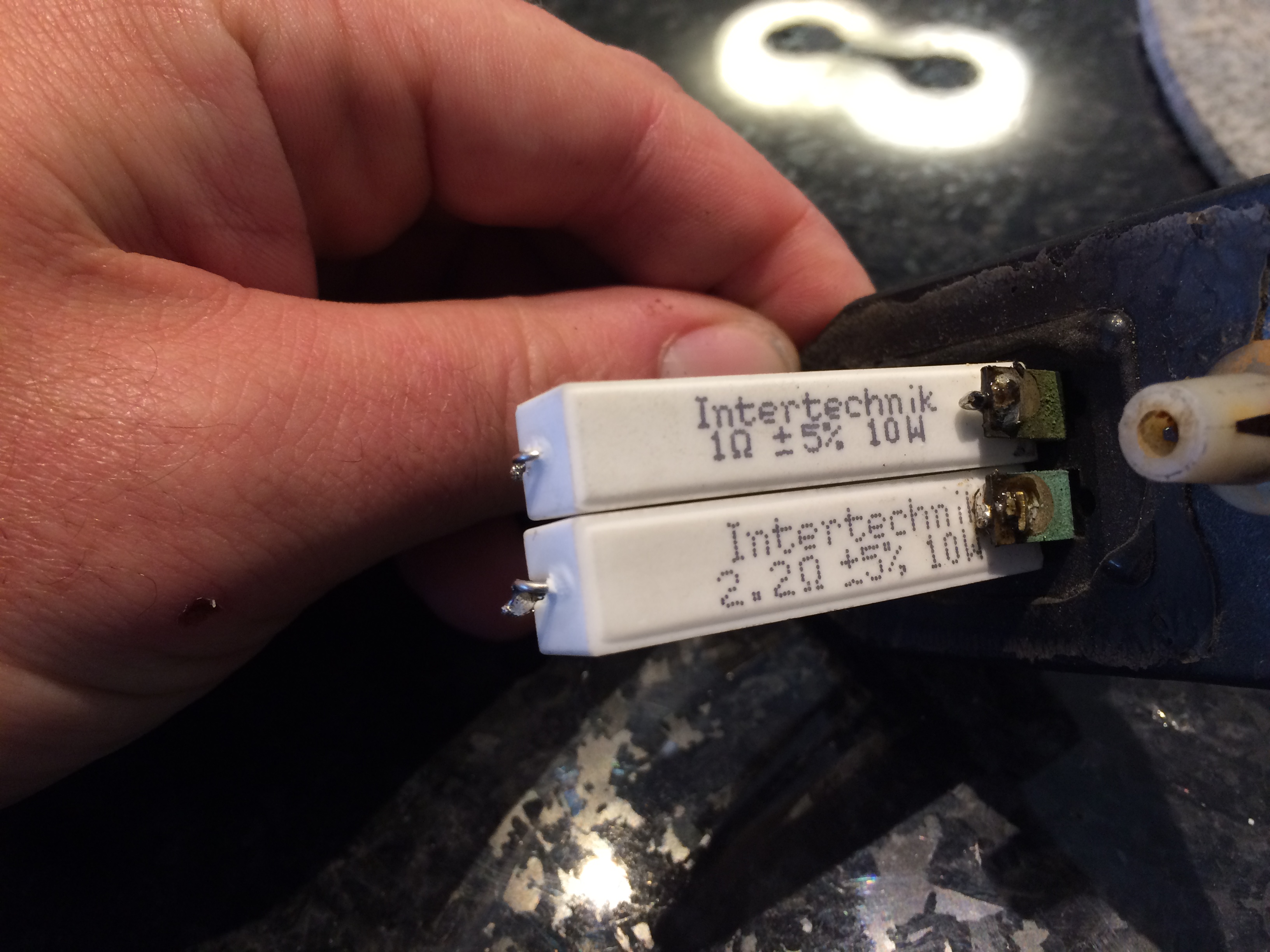

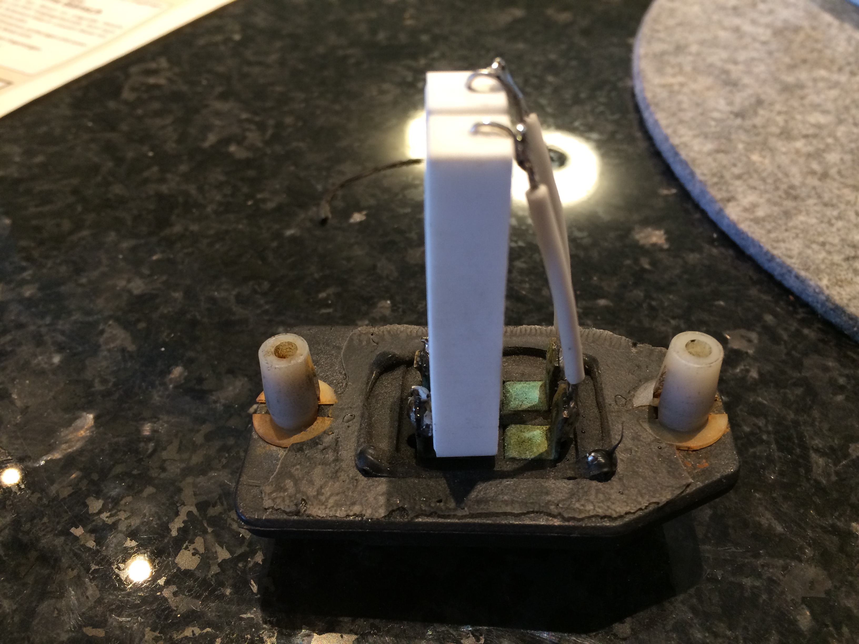

Heater resistors replaxed

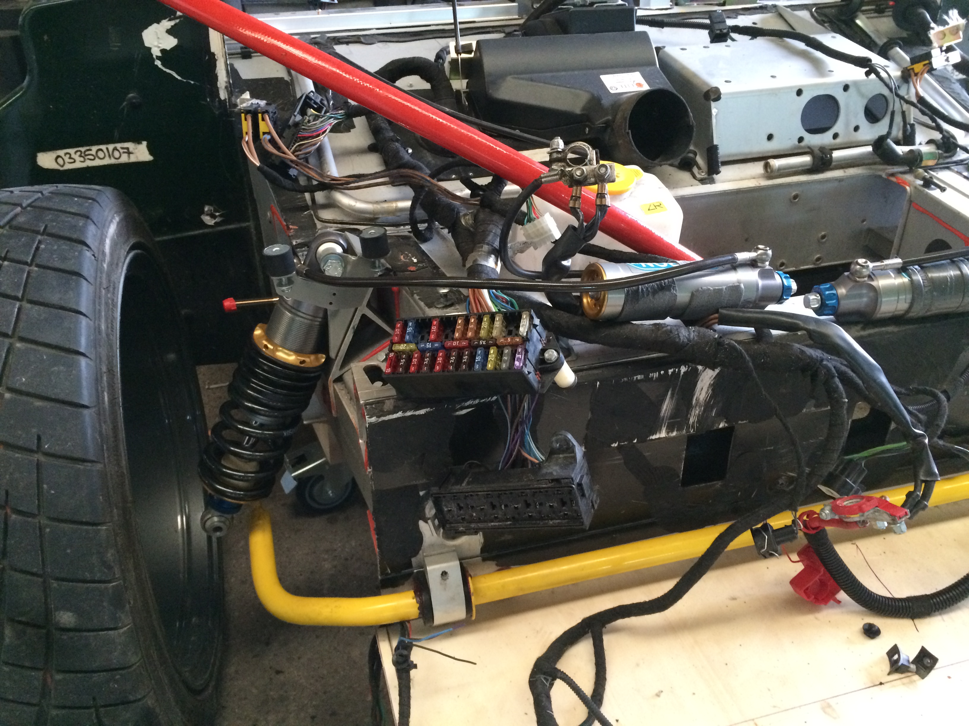

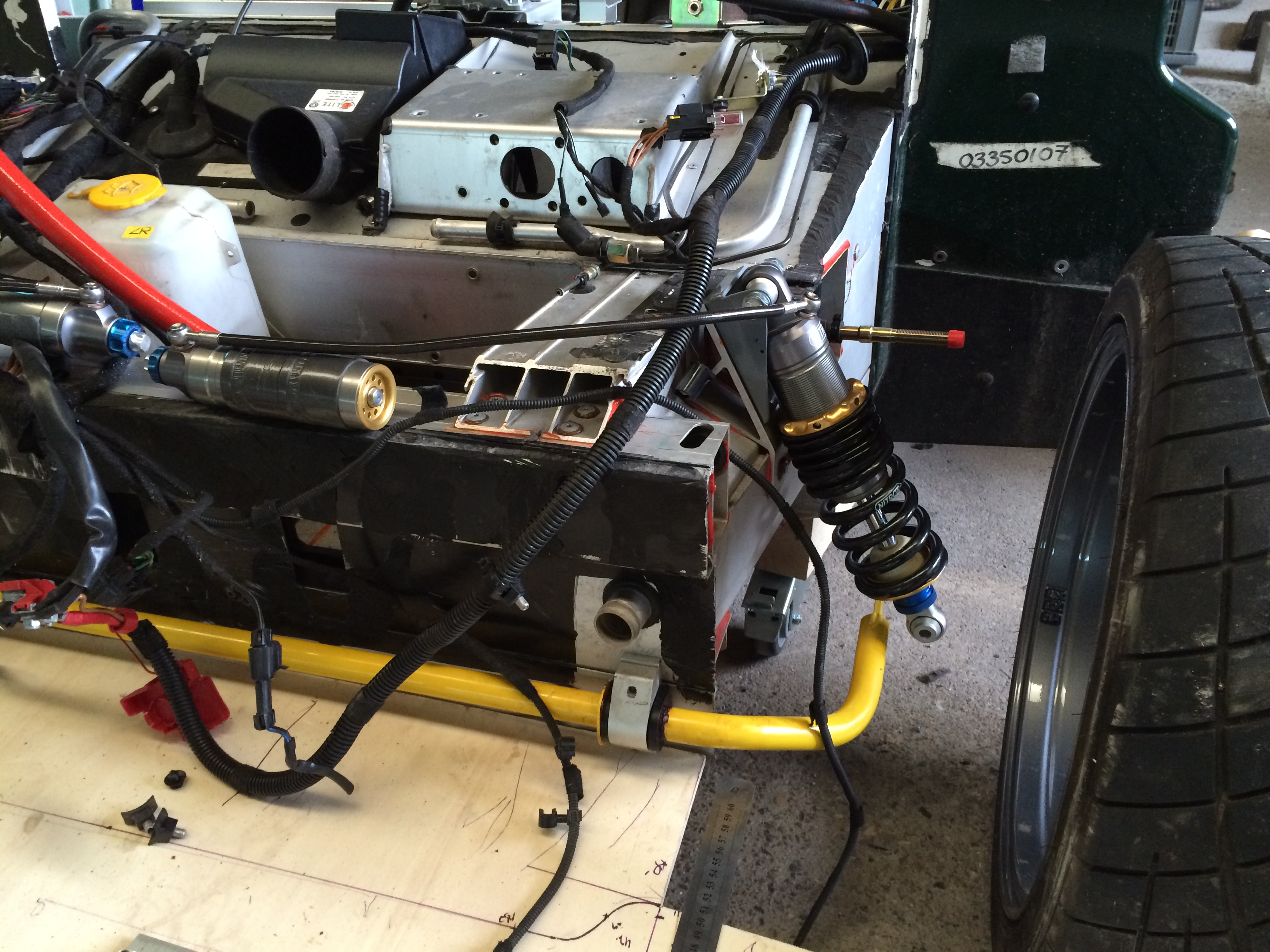

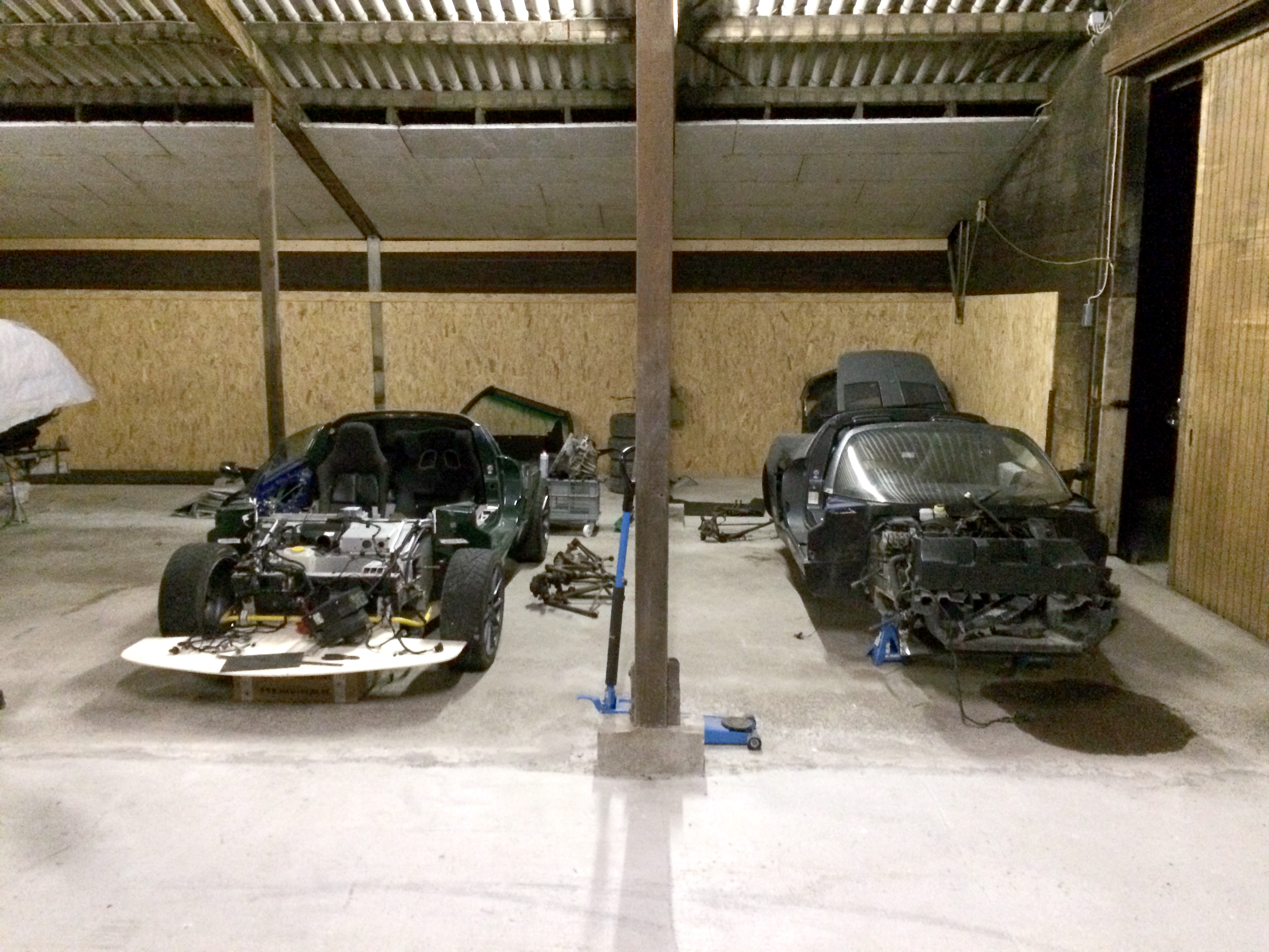

and an overview of 'progress' at the end of last night

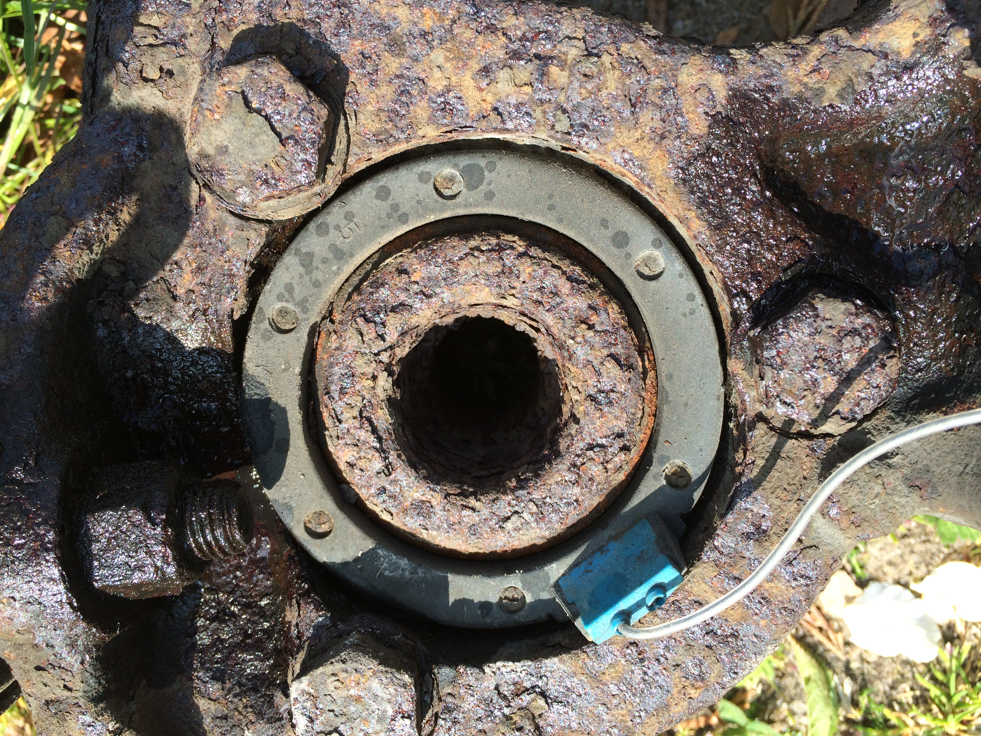

Didn't know you'd been scavenging things from the bottom of the sea.

Looks like you are making good progress, but that bearing is going to need some oil to ease it up again :P

WD40, blow torch, breaker bar, angle grinder + cutoff disc = Job done Those uprights and hubs aren't going back on. I've got a complete set of the tesla bits which are in near new condition. I will strip these and keep them for spares though (although the hubs themselves are toast). Nitron brackets turned up today (thanks to Alex at nitron!), whilst the wishbones themselves get packed up into a box for blast/powdercoat and new joints/bushes Fwiw ... After a bit of stewing in things, decided to go with OEM exige bushes Yup, the donor is a turbo. For the time being though, the plan is to try and sell the complete engine/gearbox/loom/ecu/intake/exhaust/driveshafts etc as a single unit. Bolt in, drive away. If that doesn't happen, then I'll split it up :)

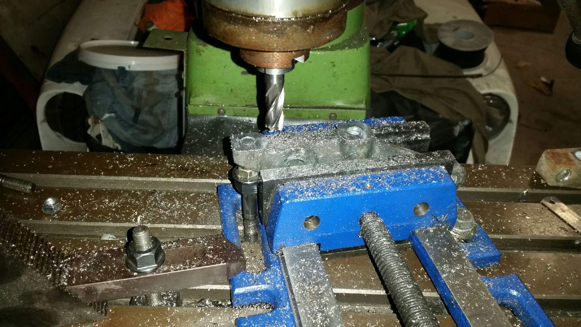

annnddd... Finally disassembled (read: blowtorch, sledge hammer, angle grinder) the wishbones for blasting, powder coating, new bushes and balljoints. Got them boxed and sent on Friday, so hopefully that'll be close to done by the time I get back, which means the front end will be approaching finished.

been stewing on the best compromise, setting up the W2A lines.
so far ive got the following bits:
PWR 6" barrel with 19mm fittings
PWR heat exchanger (only about 35x300x350mm) with 19mm fittings
EWP115 nylon pump with 38mm fittings
I figure a lot of the circuit resistance comes from the long runs front-to-back, so maximising flow here seems to be worth the effort (and theres space for good chunks of pipe), and after doing the maths and seeing whats available in terms of off -the-shelf tubing, I think ive settled on the following:
- lightweight 32x1.6mm HDPE pipe for the long runs front to back, including formed hardpipe radius bends, and proper diameter transitions. so basically that's a 29mm ID for 50-75% of the circuit length in smooth-walled, constant-diameter hardpipe, which doesn't weigh that much.
whats im a bit undecided on is whether to step down to 19mm ID from the 29 hard pipe (as that's the size of the core and exchanger fittings, and would be simpler) or wether I should bite the inconvenience and step down to a bigger 25mm hose, with a simple 25-19 reducer immediately at the fittings.
Either way the 32mm HDPE pipe is a fixed variable.
Im tempted to try the 19mm ID hose, and just get good hose to avoid diameter loss around bends etc. if its not good enough, ive got both the exchanger core size which could be an issue, plus I can upgrade the 19 to 25mm hose if required.
the 19mm is certainly easier to handle

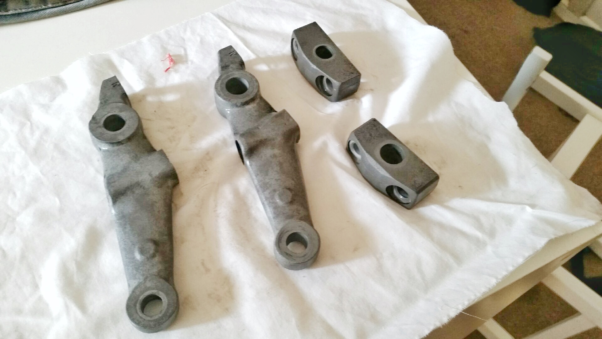

Balljoint mounts all finished
Wishbones should be back from the powdercoaters this week, bushes and joints all ordered ready to go in.
Only thing left is to see what hub carrier bolts they decided to put in the tesla, and if needed swap in some 10.9s. Hopefully the teslas got them from the factory though. Maybe a lick of paint, and then it's all back together :)
