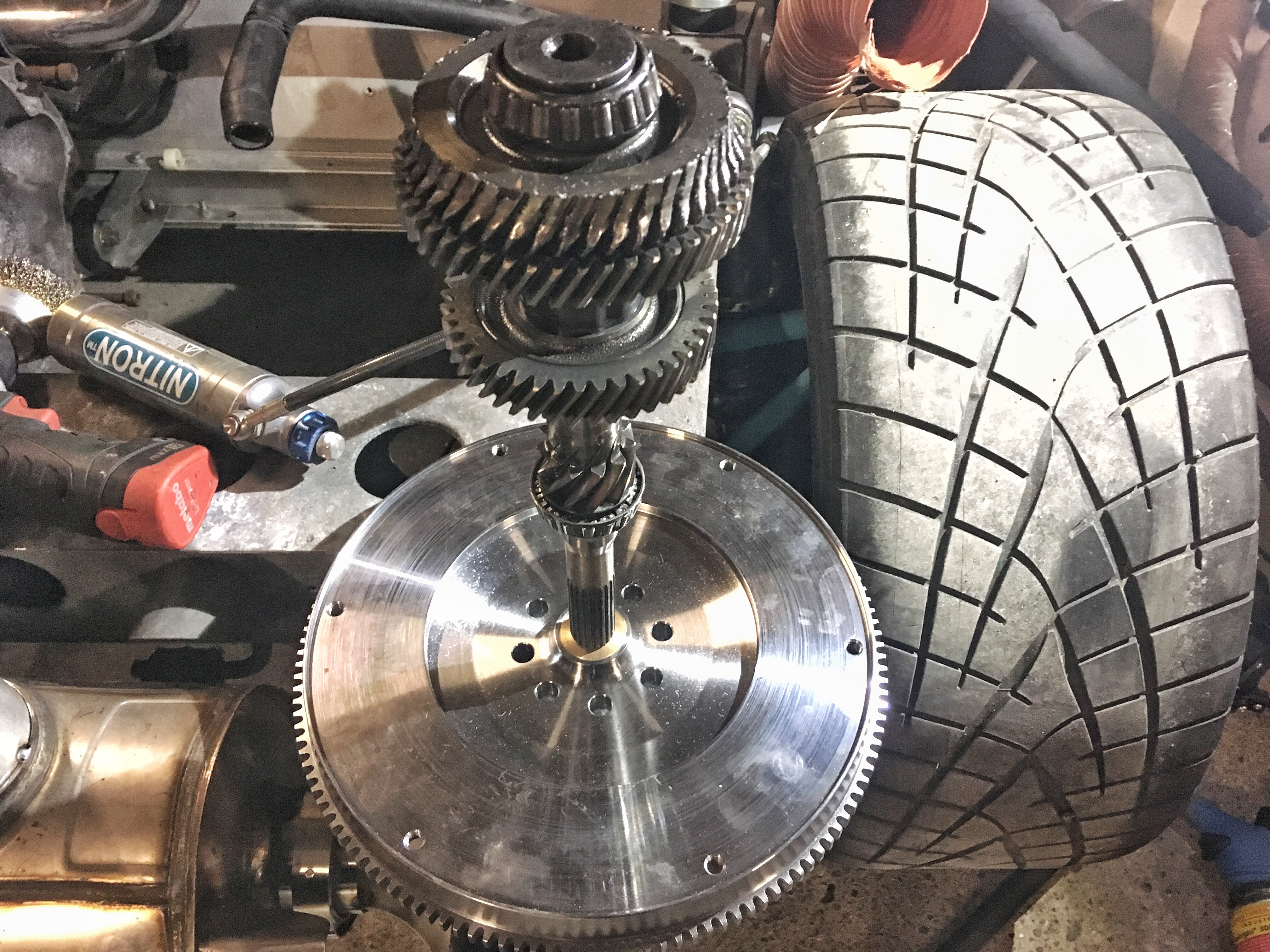

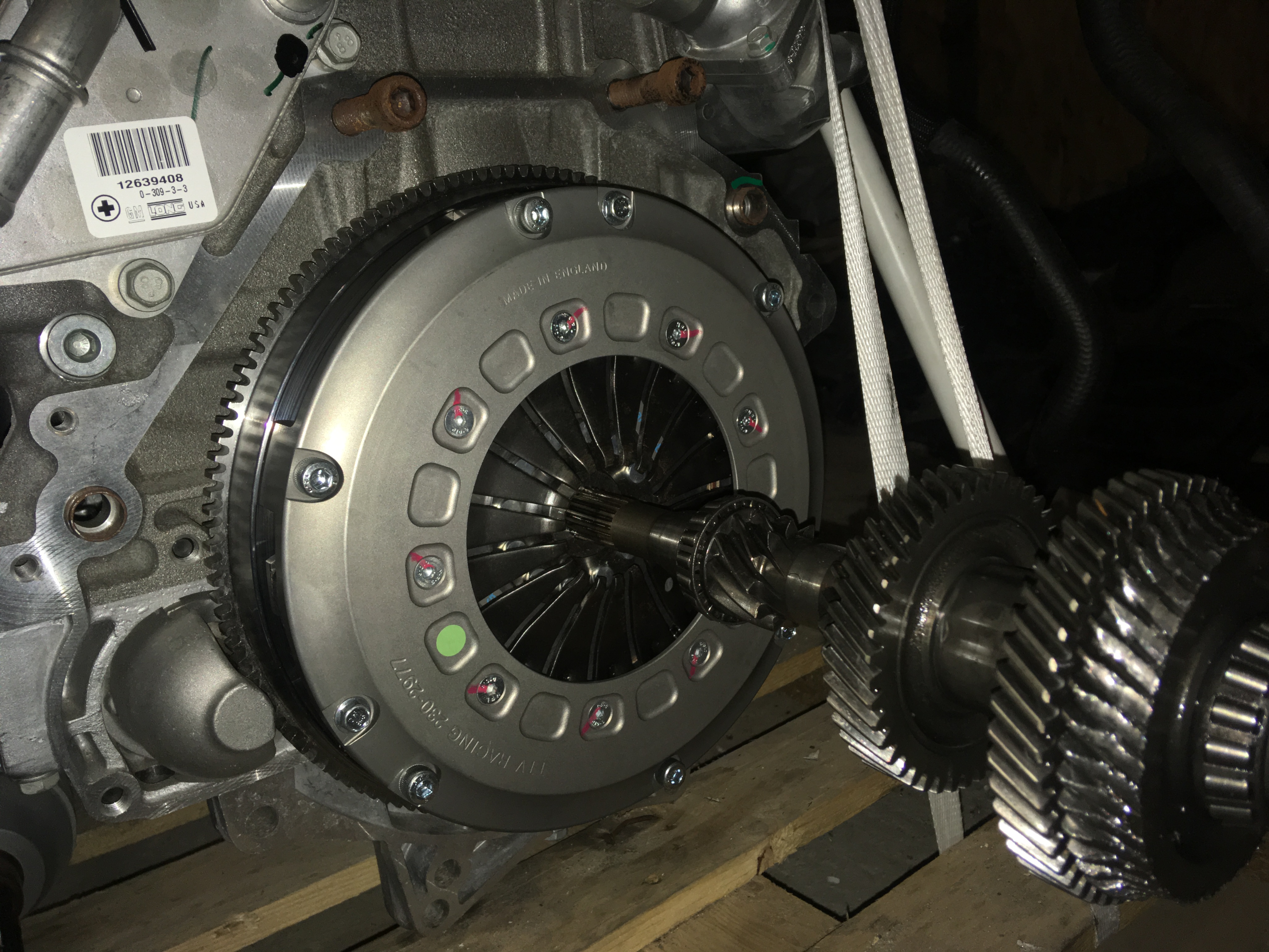

Posted 29 November 2017 - 09:23 PM
Expensive clutch alignment tool...
#783 Nev
Posted 30 November 2017 - 02:15 PM
Bloody useful to have a clutch alignment tool though, I know how much time I've wasted in the past without one.

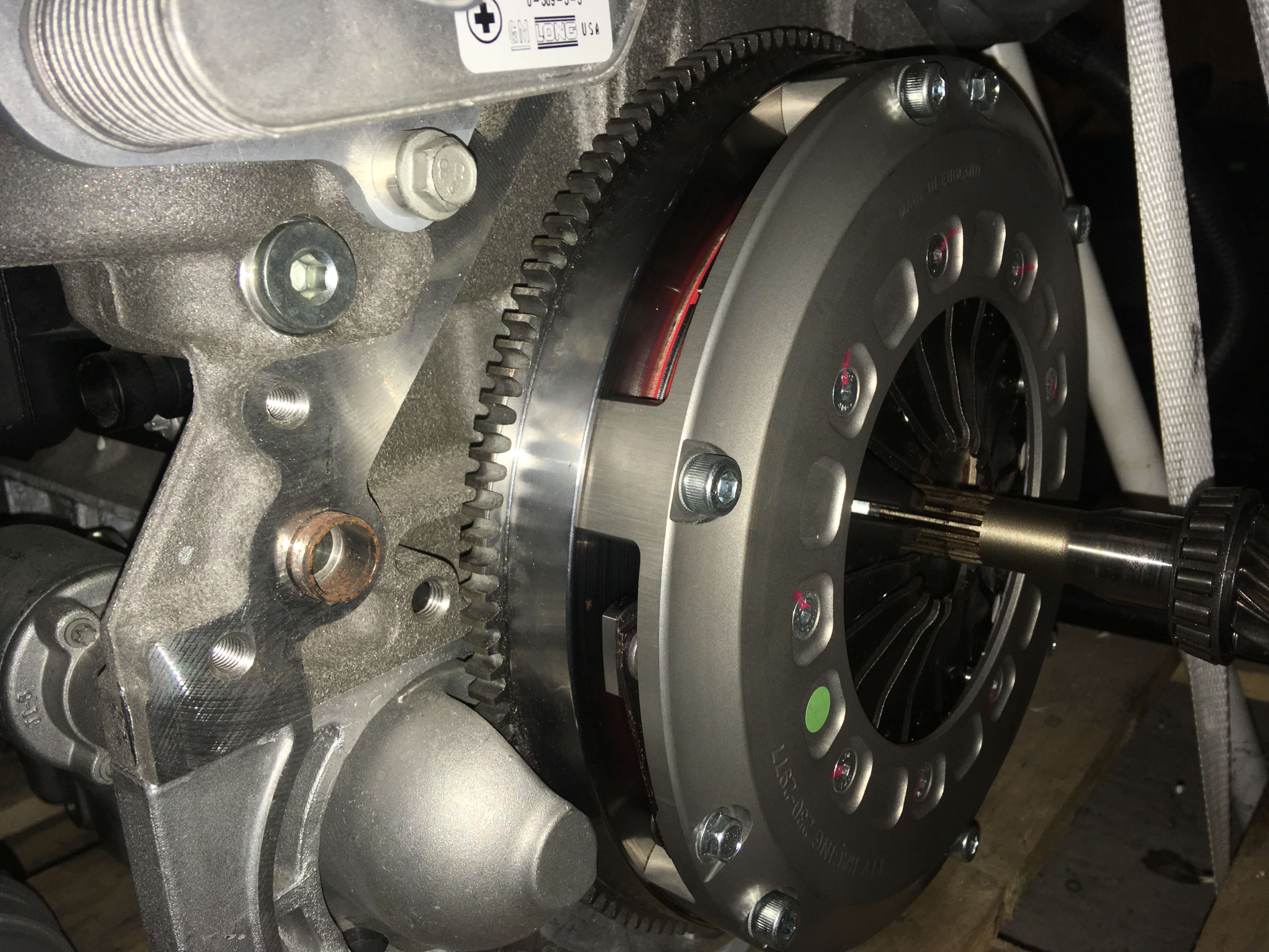

#792 Doctor Ed
Doctor Ed
  • 1,188 posts
  • Location:Germany
Posted 19 December 2017 - 08:45 PM
ARPs lubed, loctited, and torqued :)

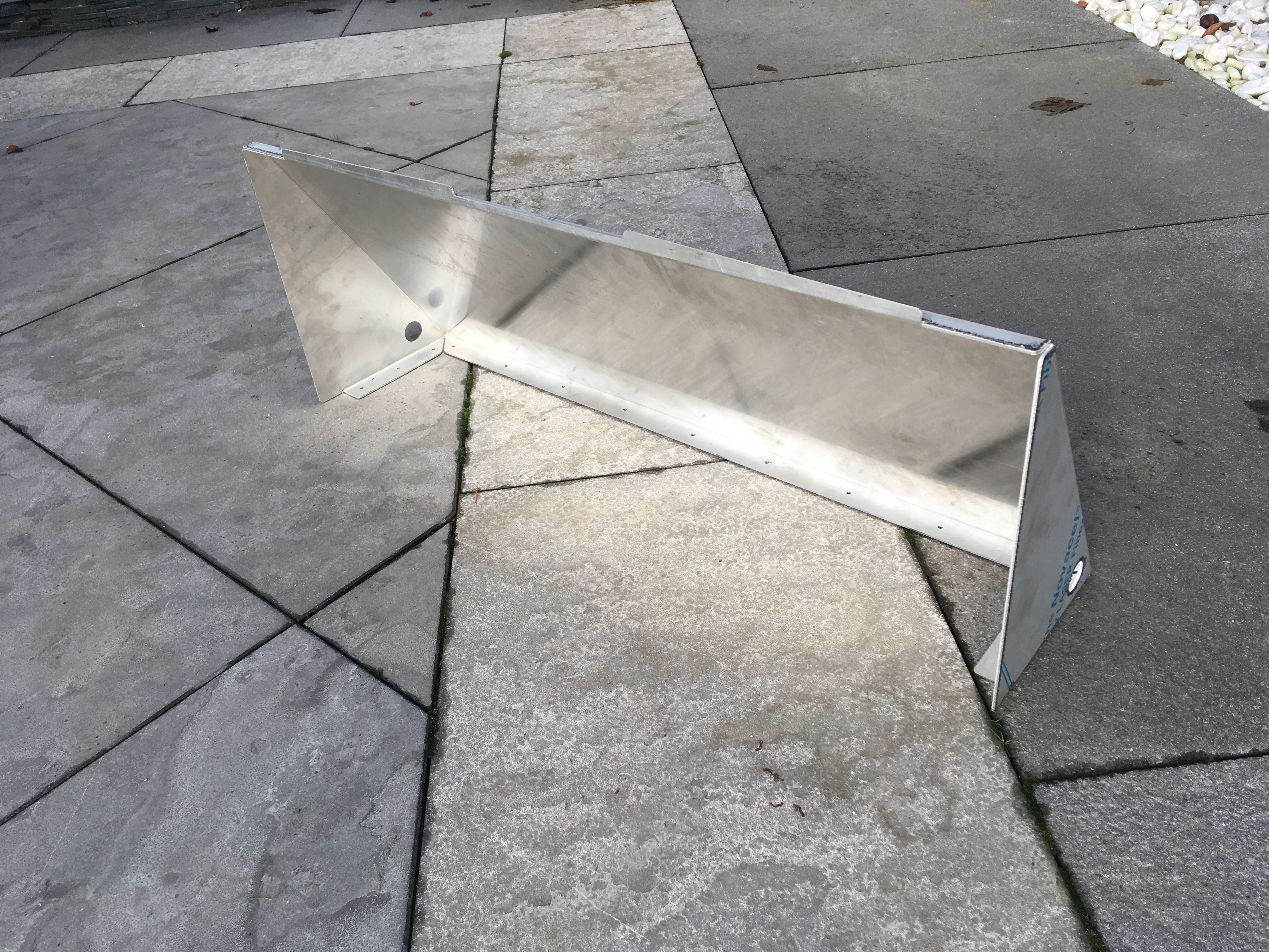

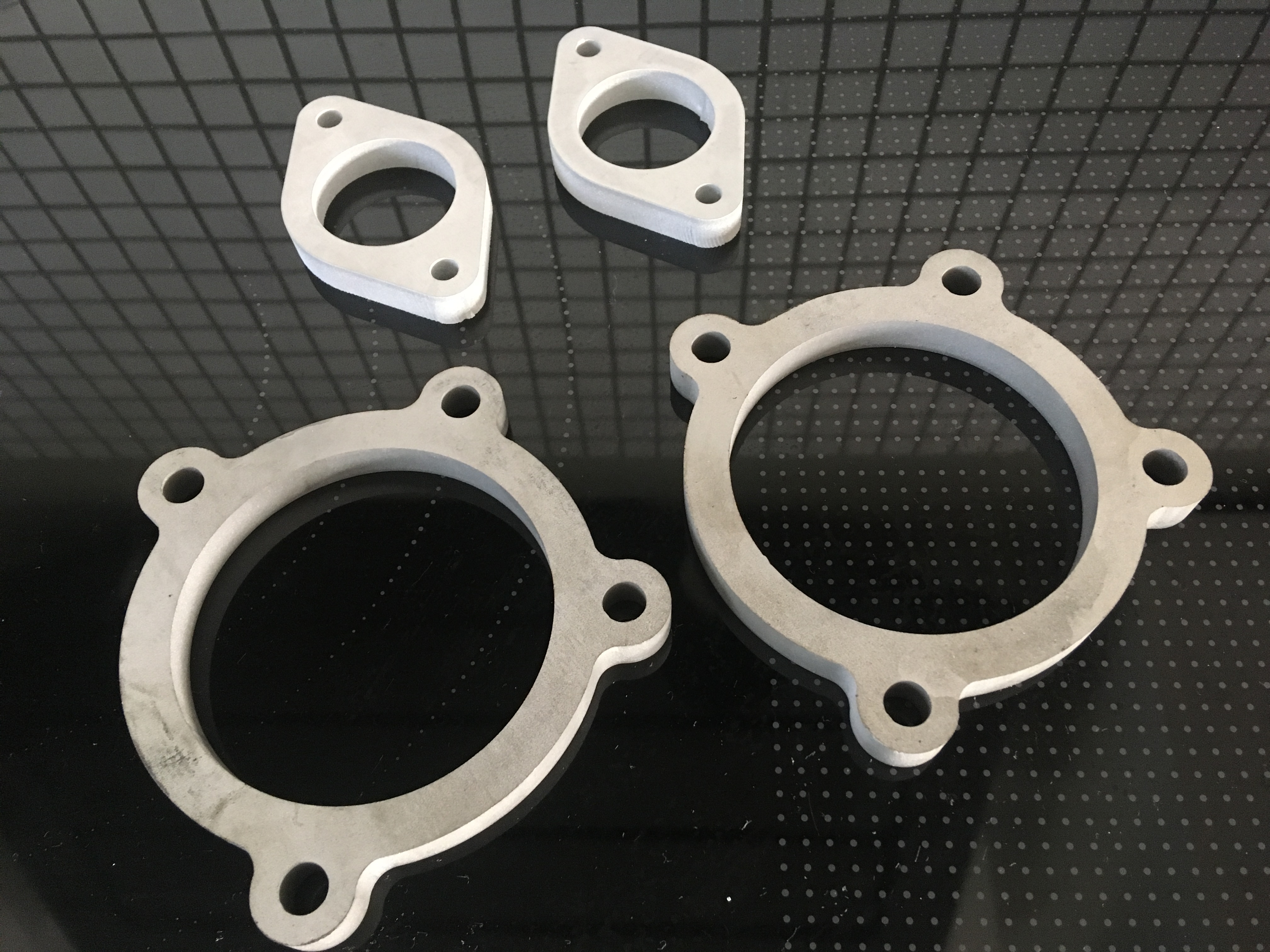

Fabricator guys got me my stuff before christmas, yay :) if anyone needs a good, reliable, affordable laser/water cutter who also does CNC folding on a single unit/low quantity basis... https://www.essexlaser.co.uk/
So sometime over the next few days I can get my firewall finally installed, plus I can get the flanges off to a machinist to have some receiver grooves machined into them. Flanges are 12mm (stainless/Alu) water cut. Firewall is 2mm alu laser cut
