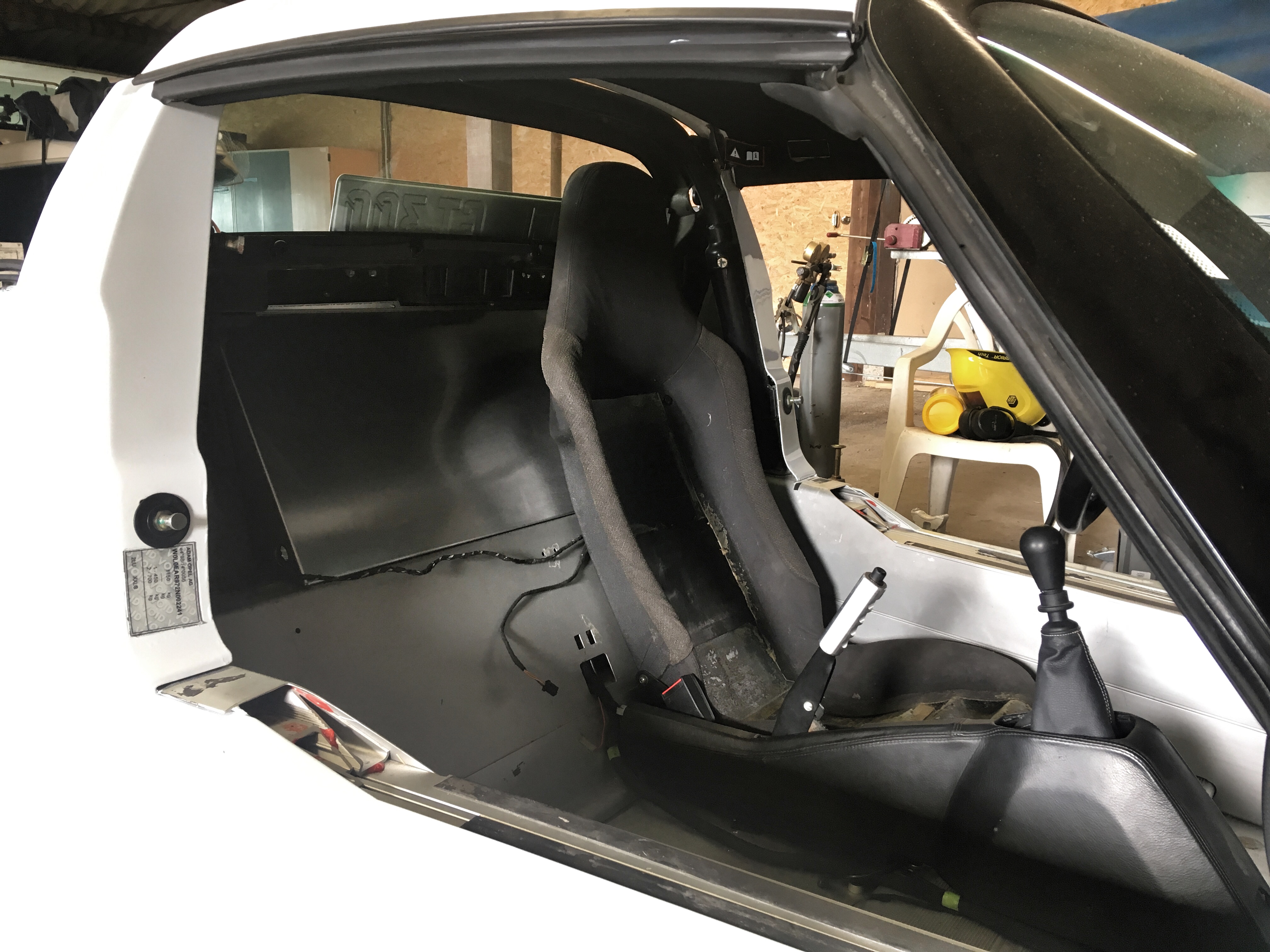

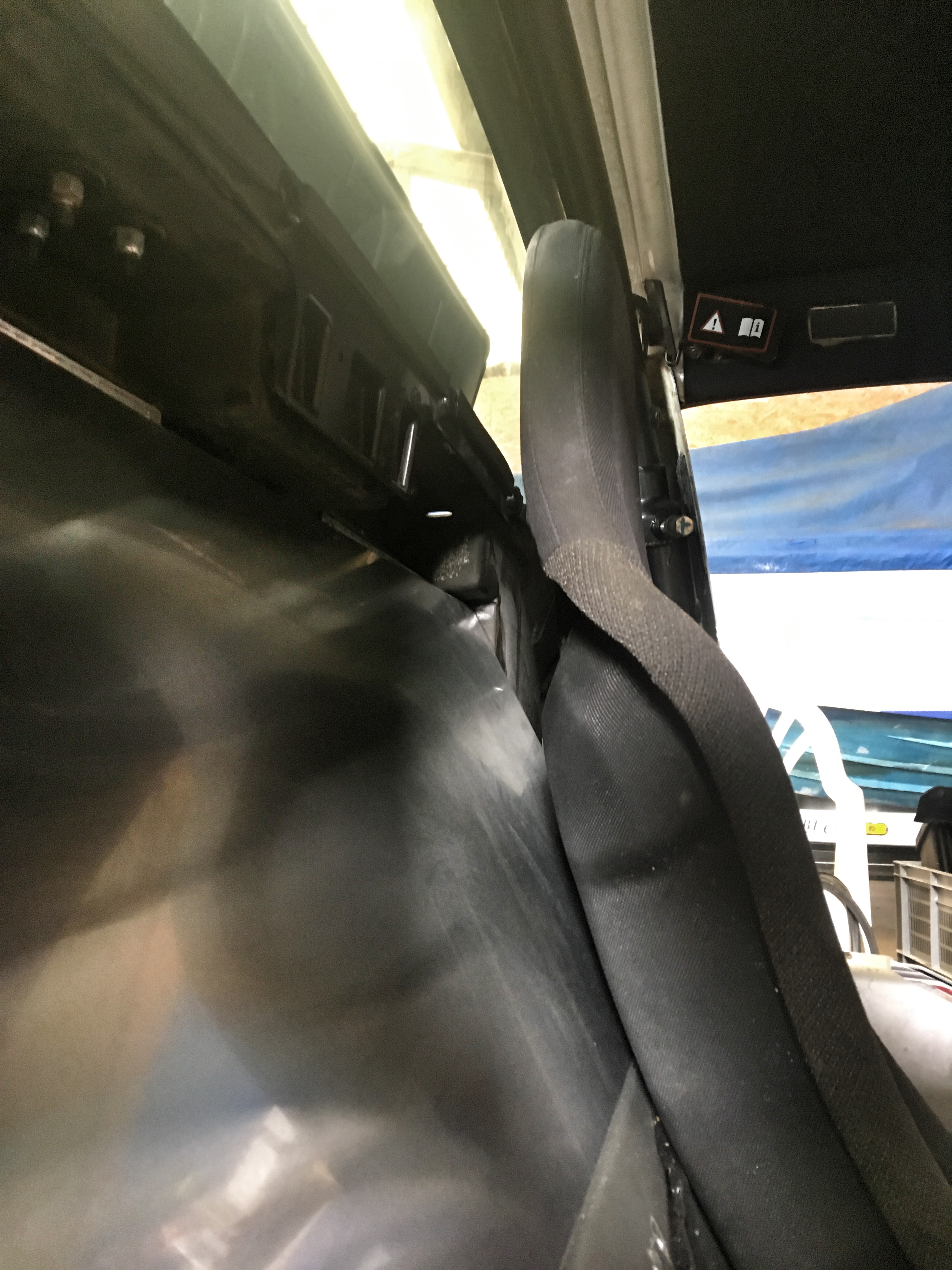

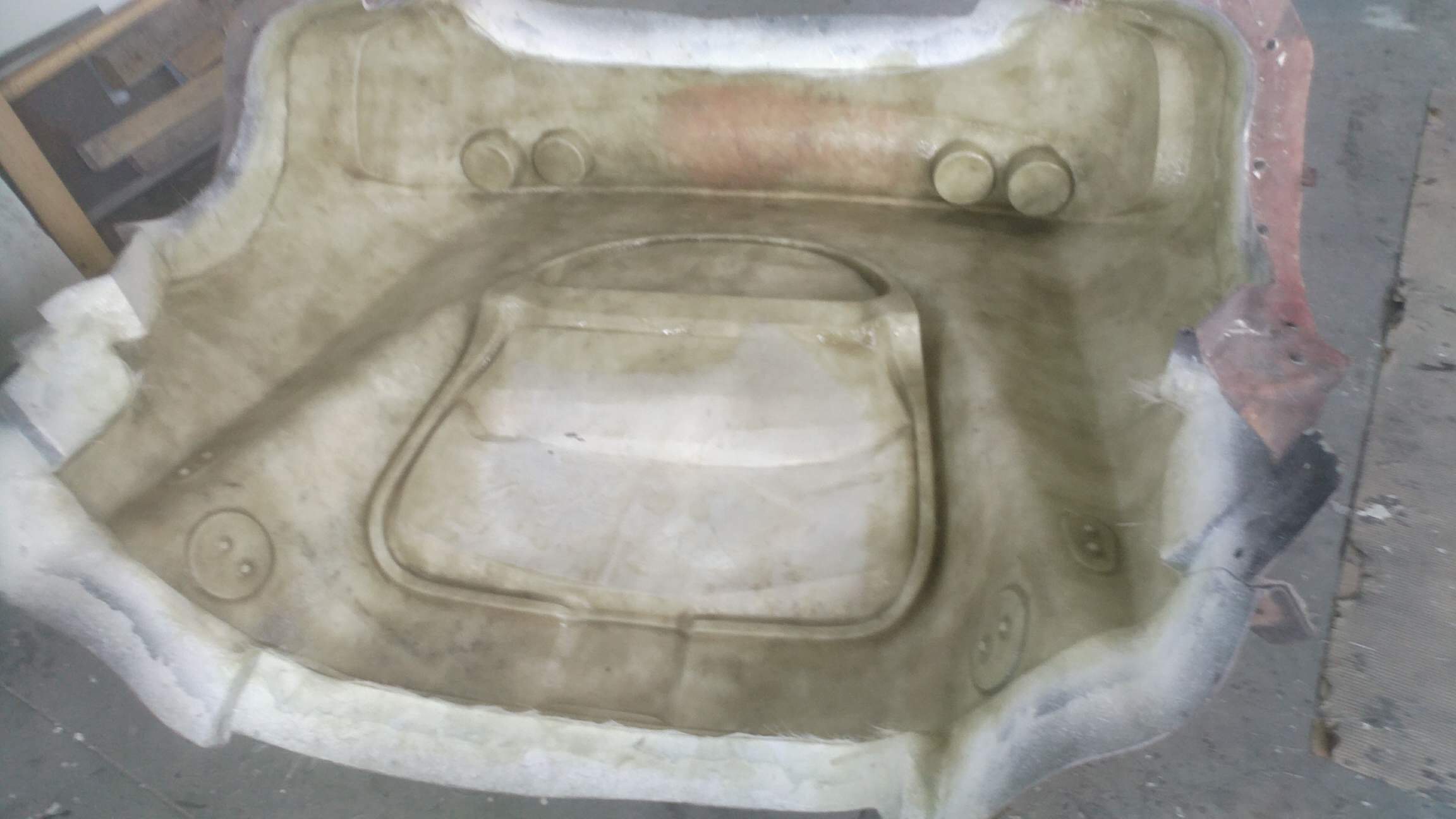

Couple of pics of the new firewall and how clearance to the seat worked out (with my new seat brackets lowering and reclining the seat a chunk over stock)

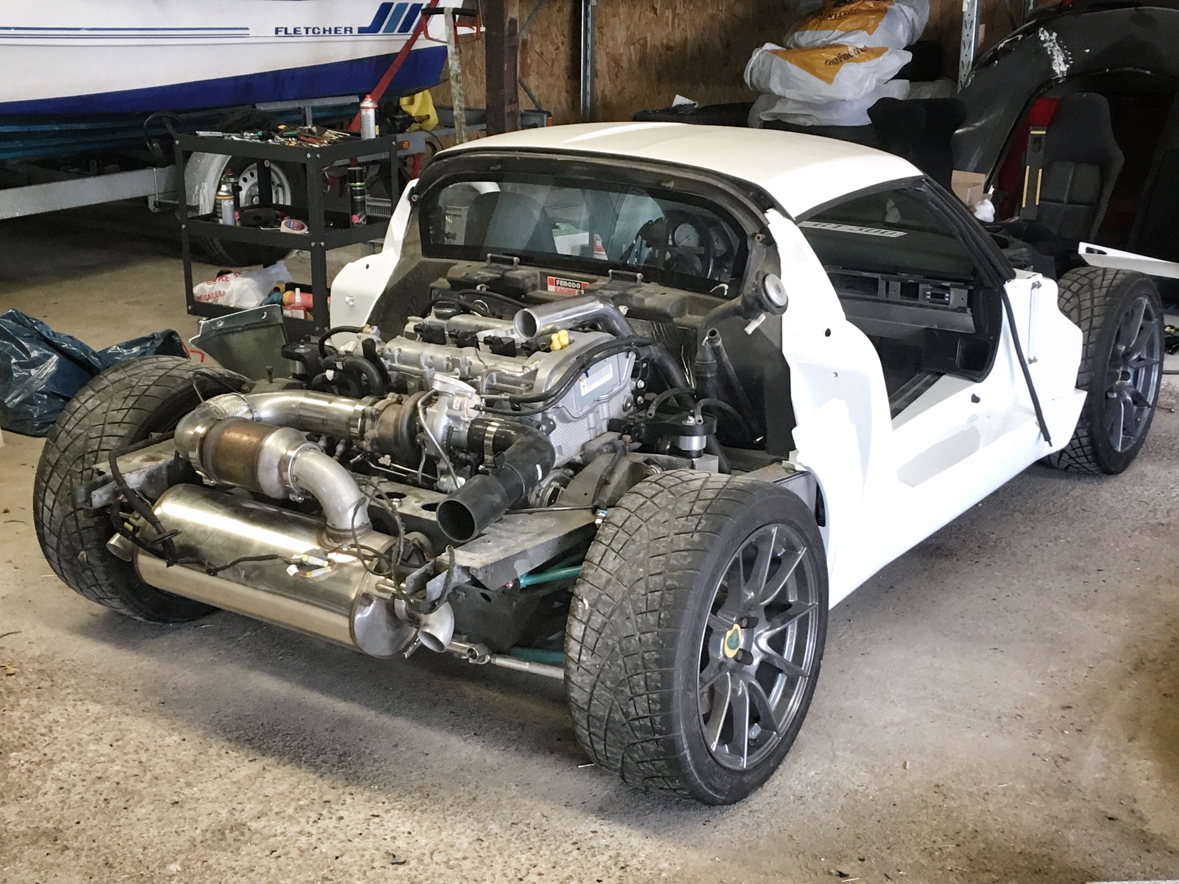

And a bit of a step back - current state of affairs in the shed...

Does a harness bar clear or arent you running one?
#864 Doctor Ed
Doctor Ed
  • 1,188 posts
  • Location:Germany
Posted 21 February 2018 - 03:47 PM
Yep, fits mm perfect!

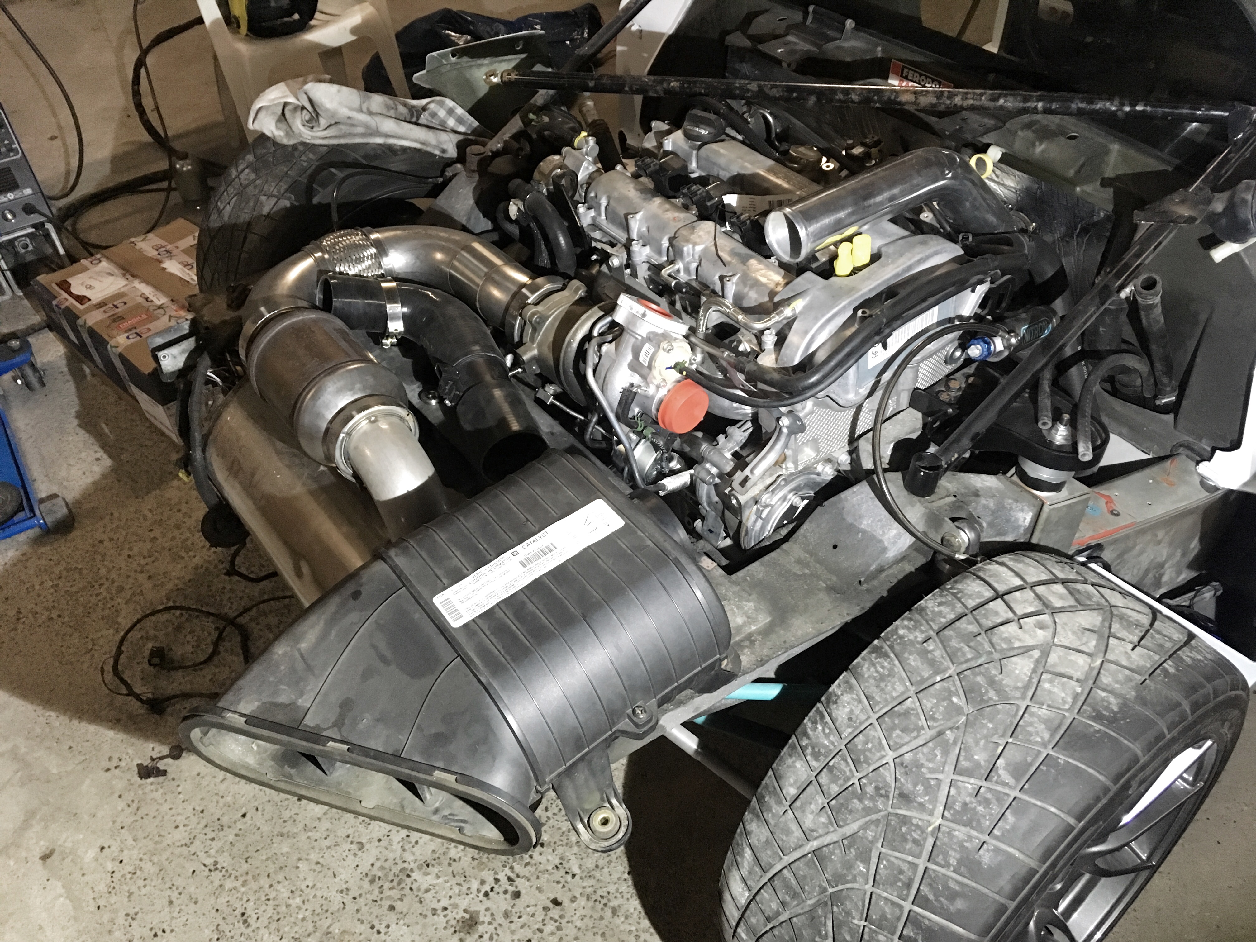

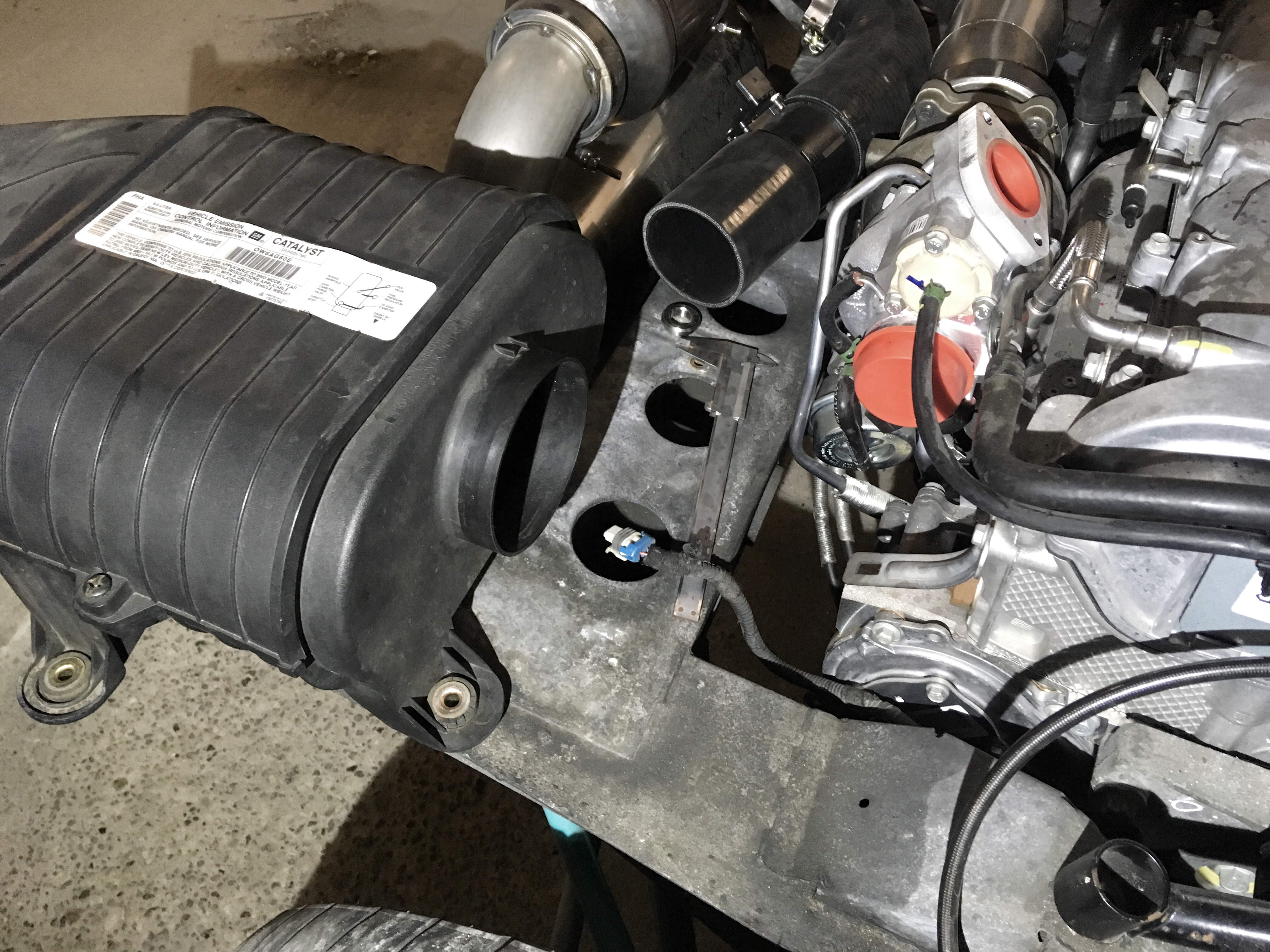

H2 Hummer Airbox is a tad bigger than expected. Not too bad, but still impressively large. Filter outlet fitting is a random 108mm - matches perfectly to my 80mm MAF and 60mm compressor inlet. lol. Need to figure how best to mount it, but for now I just want it bodgied together so itll run :)

I hope your MAF doesn't spazz out due to the short preceding runner length, presumably you are putting it directly after the air box so it gets an even flow as much as possible?
I mention it, as I had hassles with my MAF (back when I actually had one) and had to install a hex mesh before it to try and even the flow out.
GL, keep spannering. :)
Edited by Nev, 05 March 2018 - 11:17 AM.
#869 vocky
Posted 05 March 2018 - 11:47 AM
The factory MAF on the A20NFT is very close to the air filter, so should not be a problem

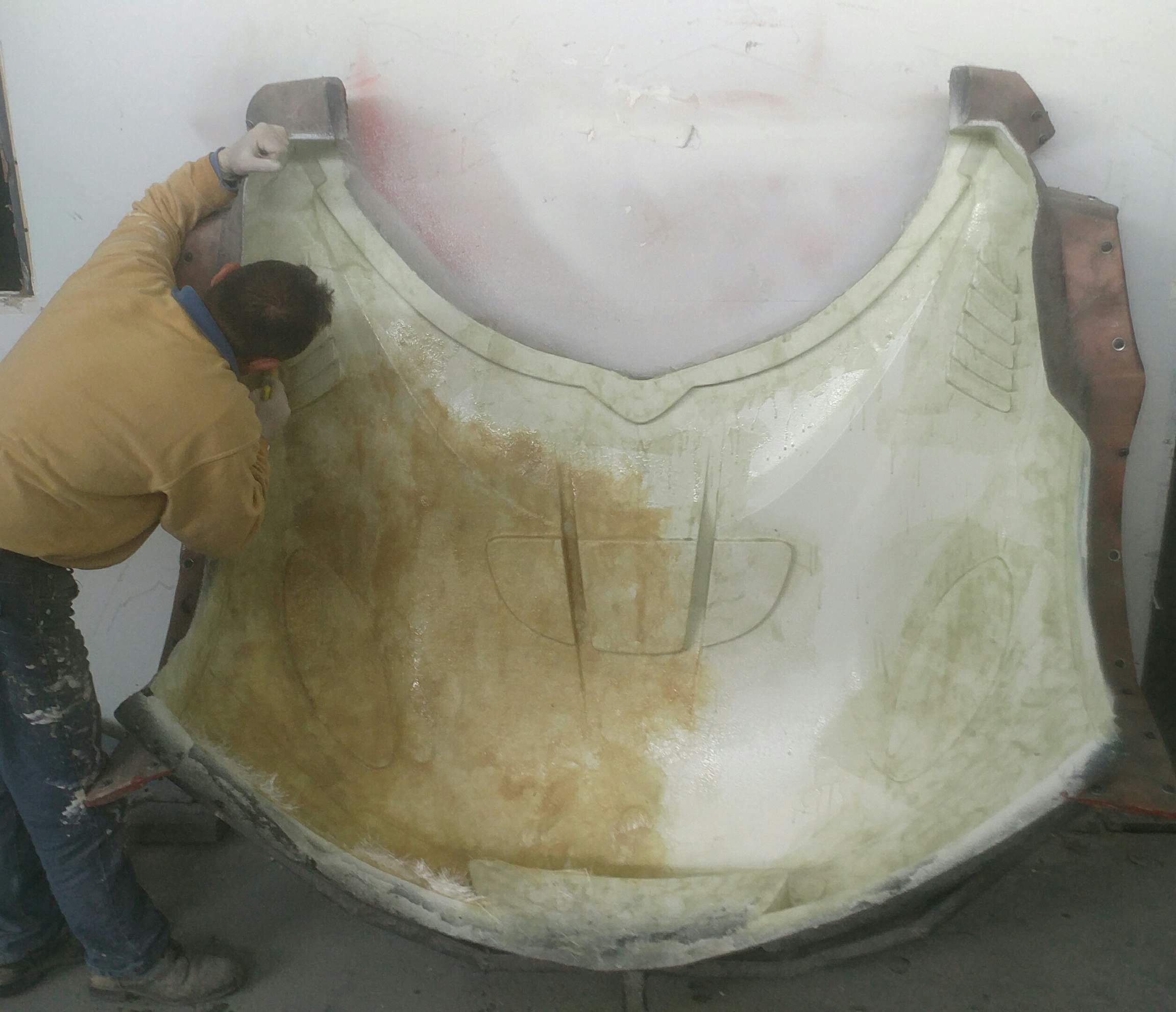

Posted 27 March 2018 - 12:14 PM

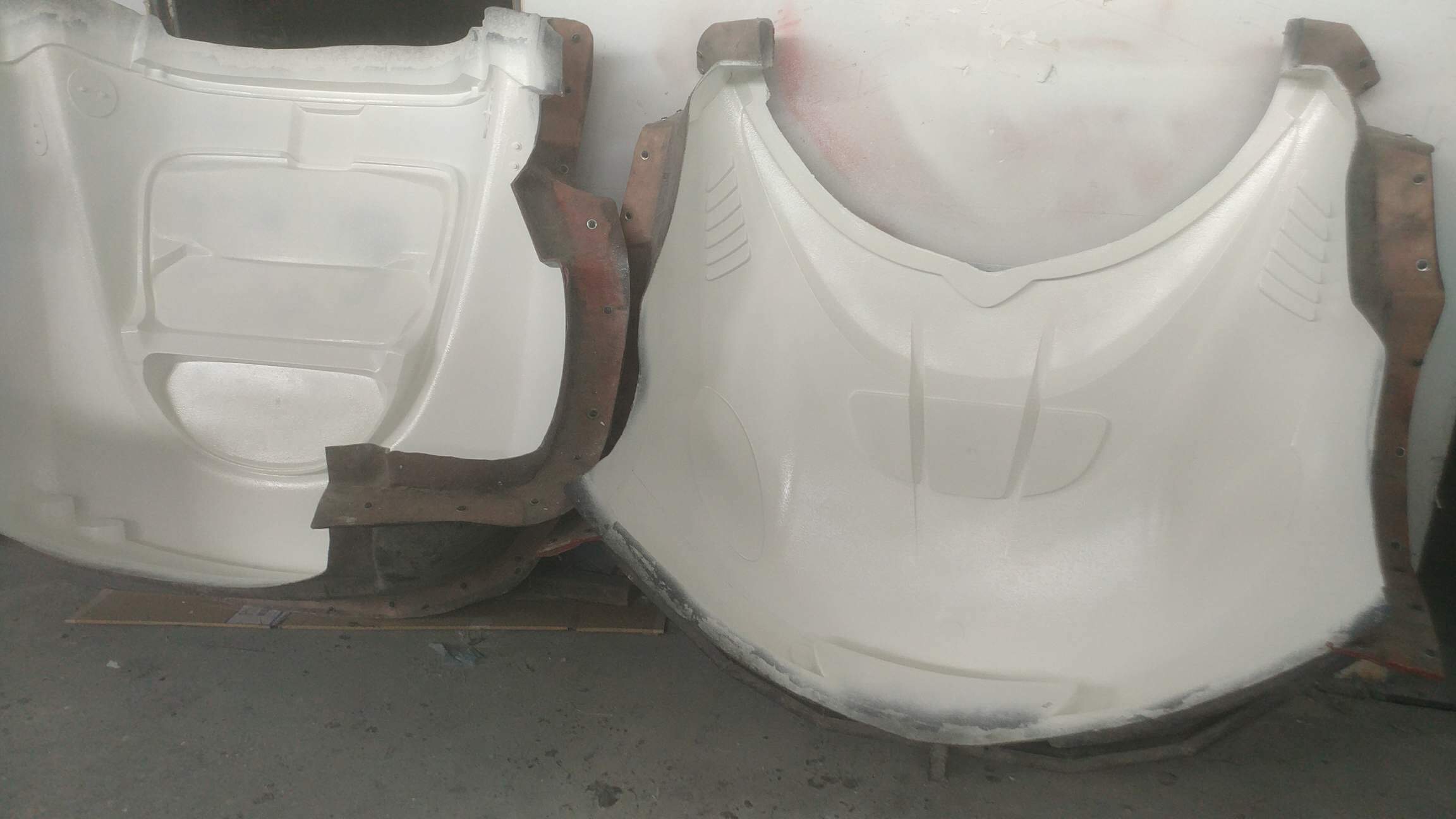

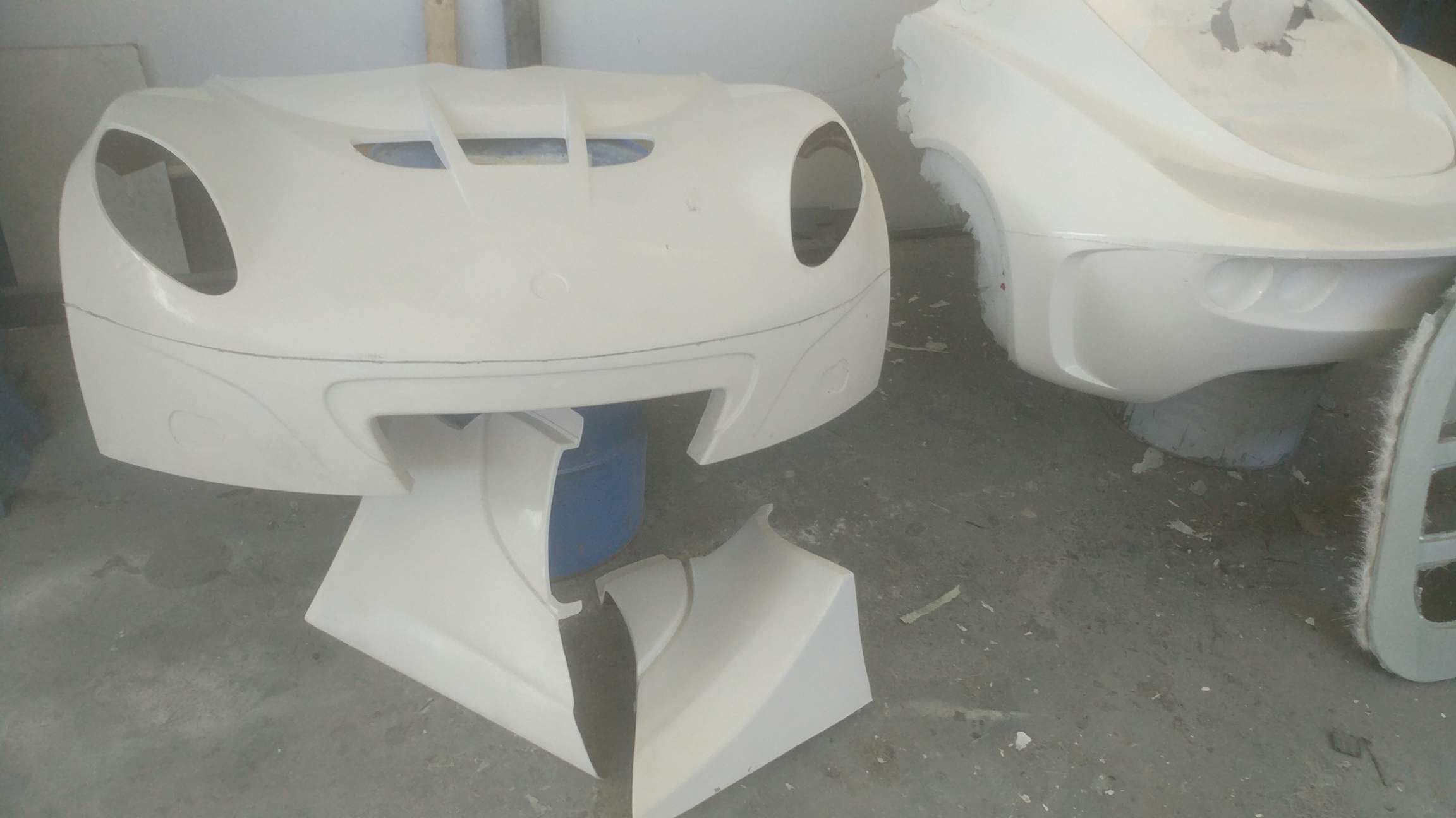

Body progress...
(easy to make progress when i can point at other people to make stuff happen! lol)
#871 siztenboots
Posted 27 March 2018 - 04:18 PM
MAF has air straighteners , a plastic grid upstream
#872 Hopegreen
Hopegreen
  • 94 posts
  • Location:Spain
Posted 27 March 2018 - 07:24 PM
Can't wait to see the bodywork fitted. I'm very intrigued how will the side sills follow the lotus design.
#873 Doctor Ed
Doctor Ed
  • 1,188 posts
  • Location:Germany
Posted 28 March 2018 - 11:58 AM
i can pretty confidently say it wont line up great, but the way the quarter panels differ, and the way the GT3 clams aer designed, it should be pretty 'easy' to get it to blend. my only concern is the shape of the air inlets, and how best to make it work aesthetically. Keep square, and leave a trace of the vx origins, or somhow make the curved inlet work despit the square edge of the door
#874 Doctor Ed
Doctor Ed
  • 1,188 posts
  • Location:Germany
Posted 29 March 2018 - 02:58 PM

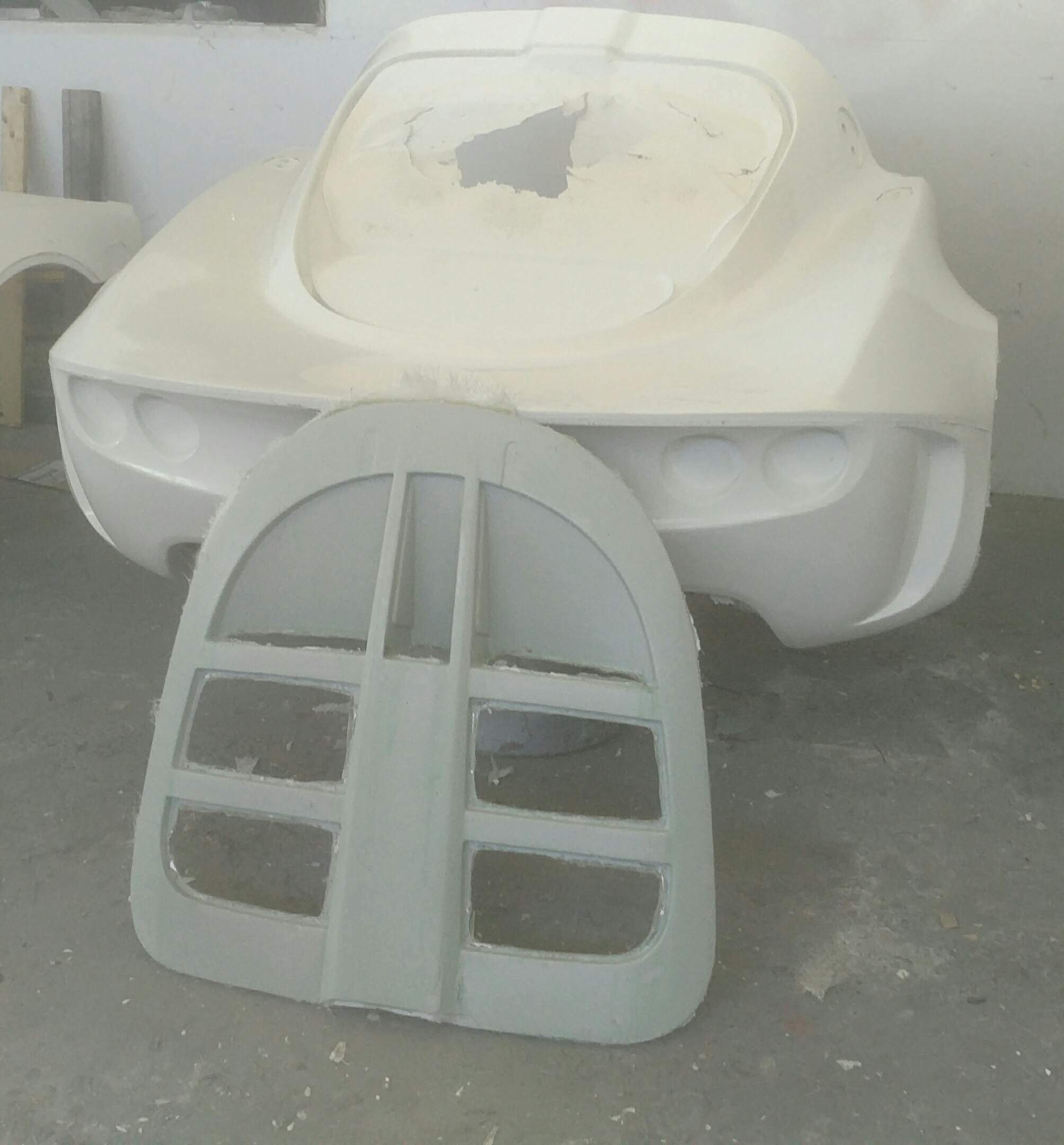

More body progress from the chaps in Greece...

do you need the cups for the lights?

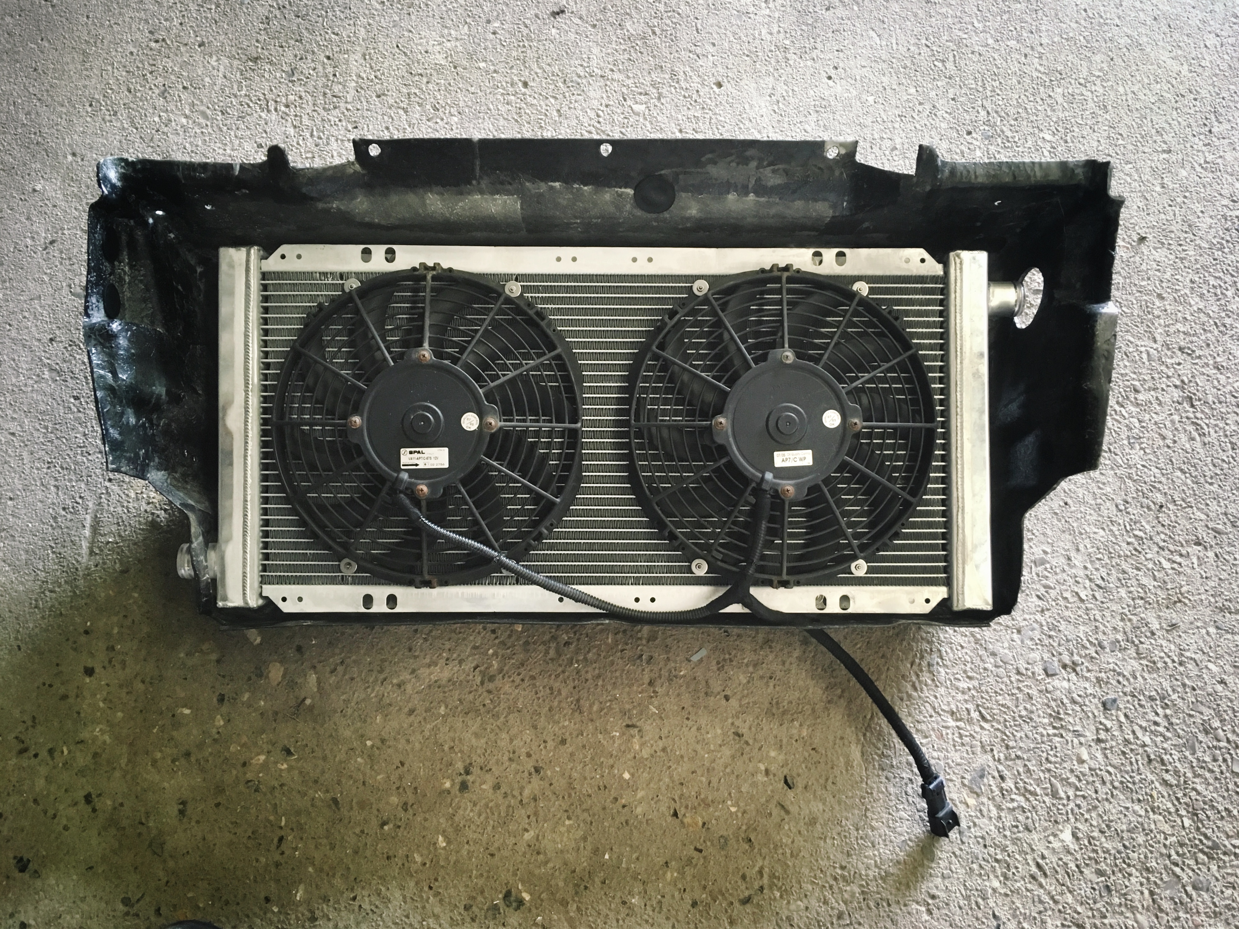

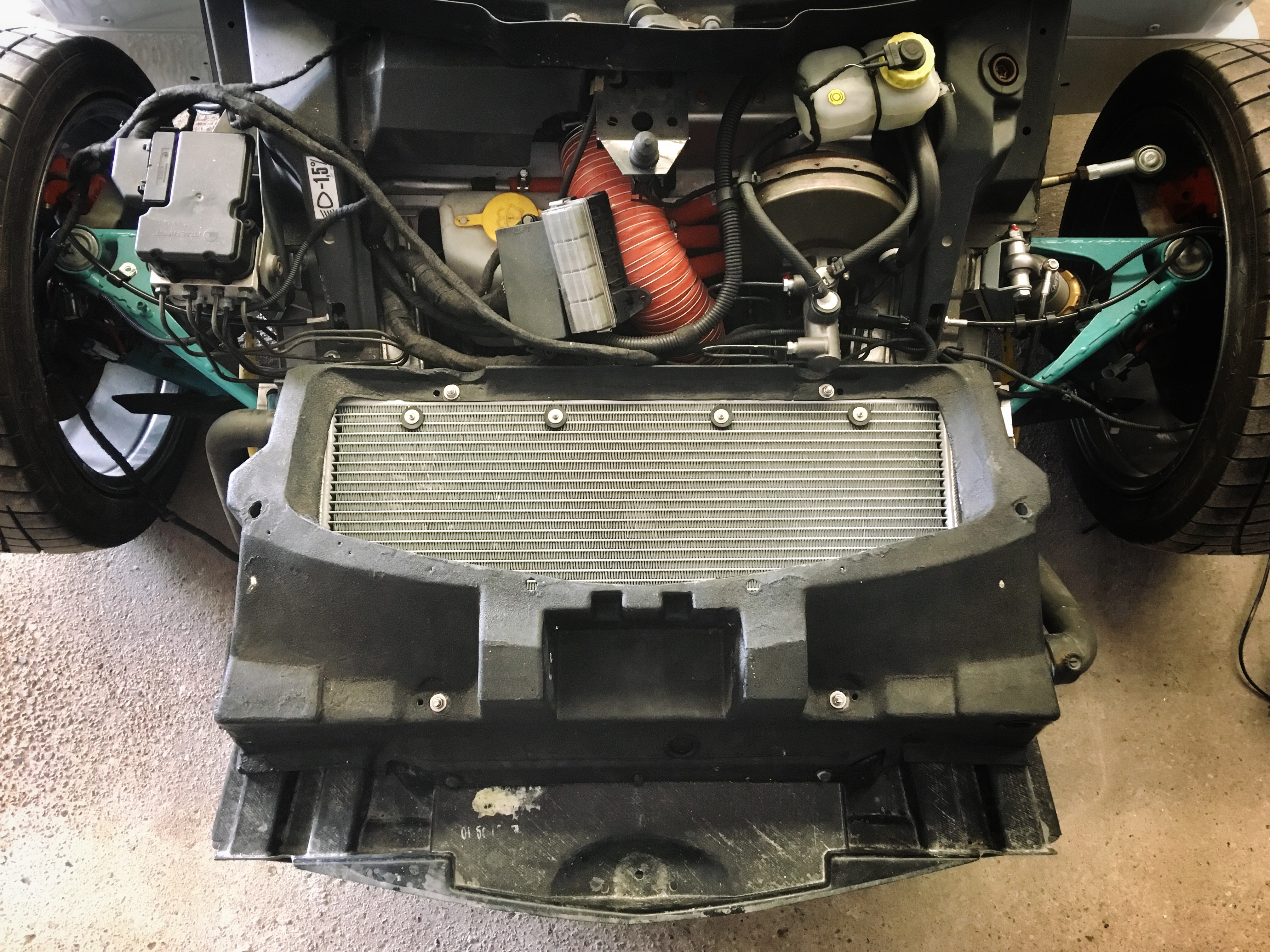

Finished the front end of the cooling circuit. The 68mm core was too fat, so sold it and got a smaller one. Ditched the old single spal which sounded like a chinook, and got 2 slightly smaller used lotus spals for not much. New loom and plug, panel fasteners, mounted, doneski.

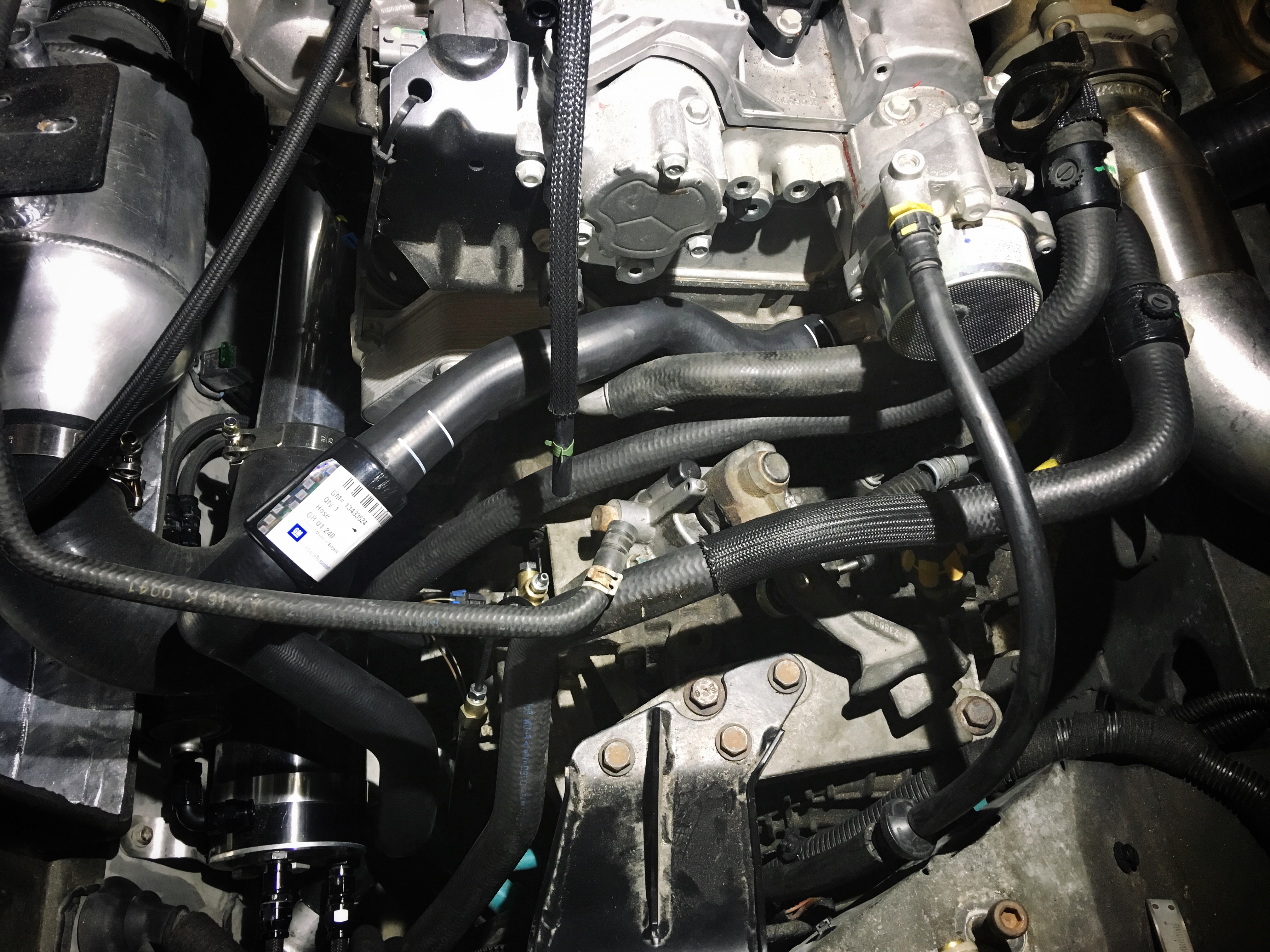

So this has been happening to try and get enough boxes ticked to facilitate the start of loud noises TM
Cunty mish mash of coolant pipes from various cars all working harmoniously together in a tangle of eye cancer
