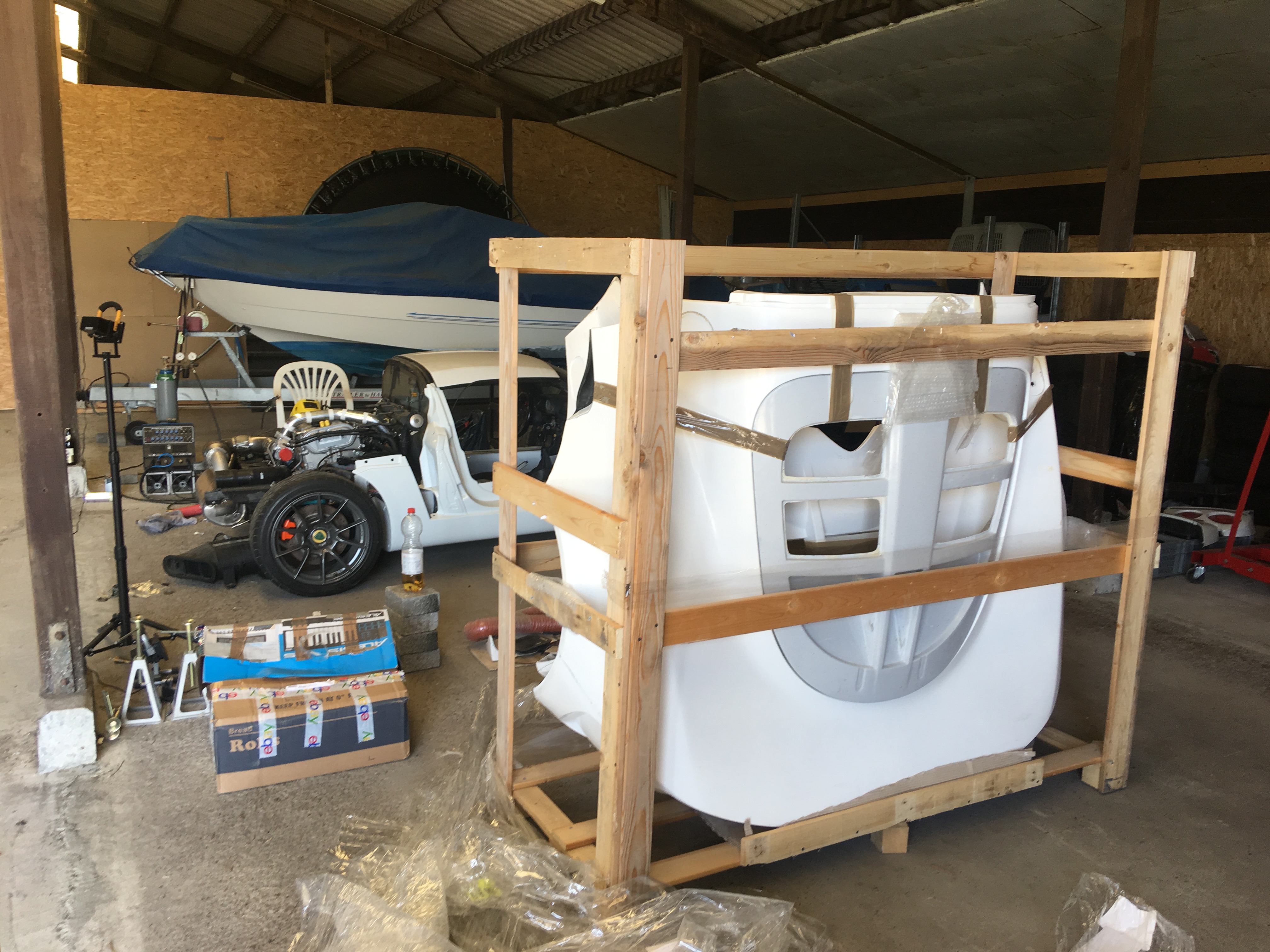

#904 Doctor Ed
Doctor Ed
  • 1,188 posts
  • Location:Germany
Posted 18 April 2018 - 02:44 PM
Focus RS white. Then wrap to taste :)

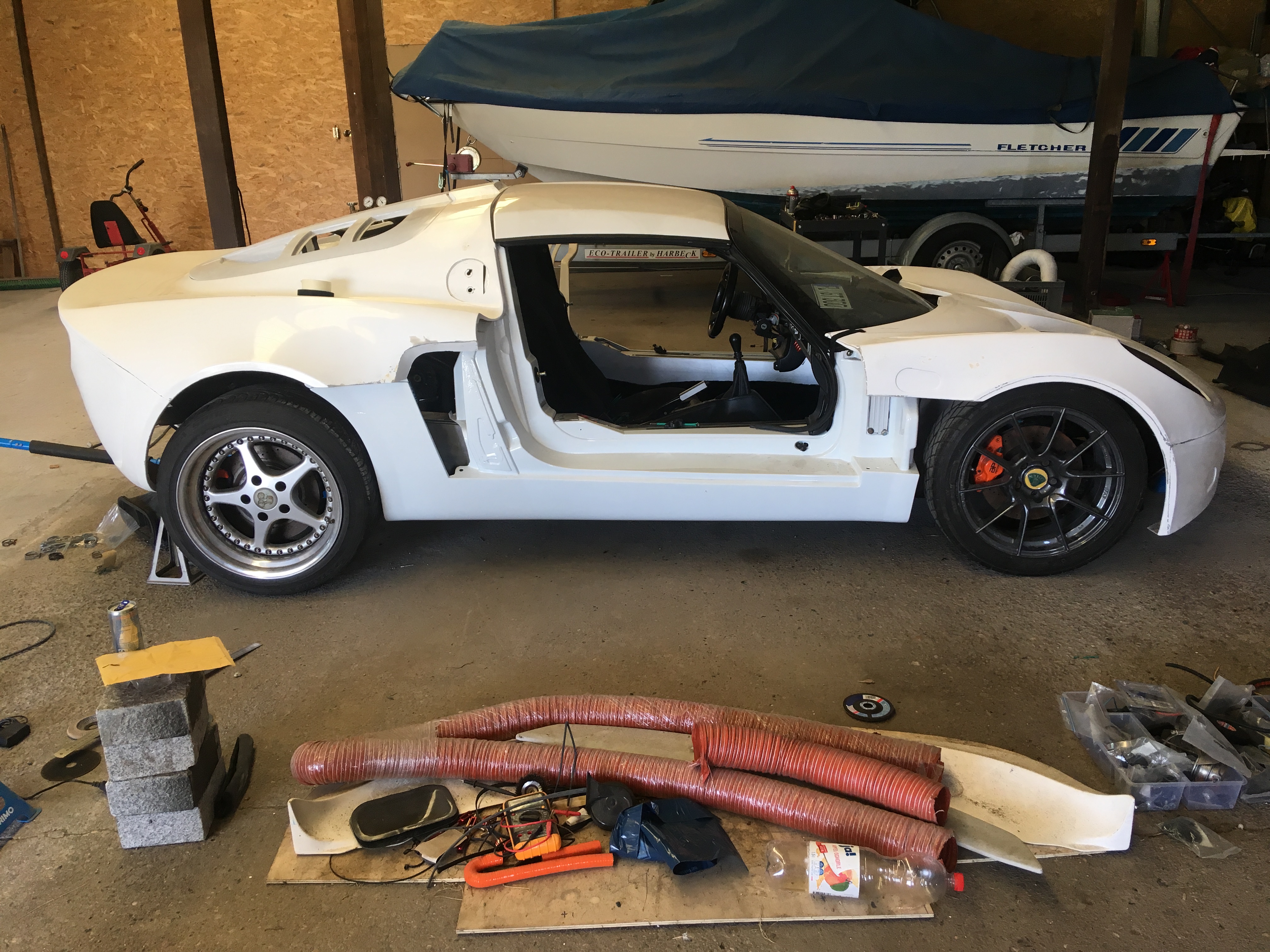

#905 siztenboots
Posted 19 April 2018 - 11:38 AM

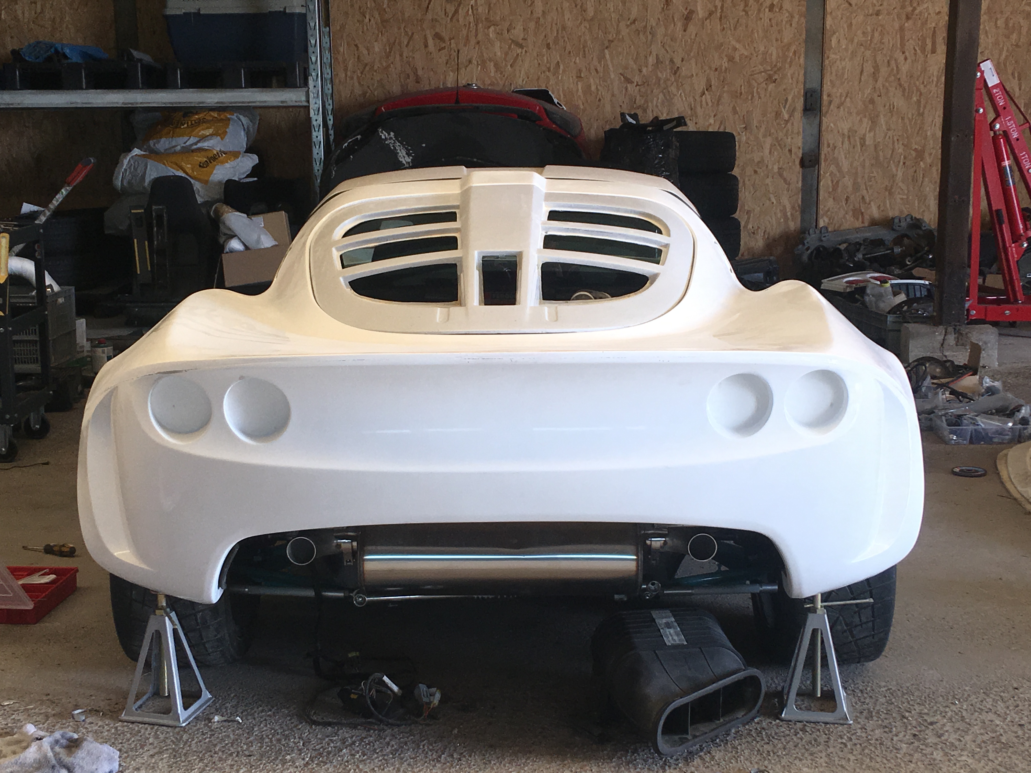

I see you have the Porsche brake ducts 'fitted' to the lower arm
#906 Doctor Ed
Doctor Ed
  • 1,188 posts
  • Location:Germany
Posted 19 April 2018 - 02:36 PM
Yep 997 GT3 Fitted ok all things considered. Cableties add an extra element of not coming off. Part number you can read off the pic :)
Edited by Doctor Ed, 19 April 2018 - 02:37 PM.
#907 chris_uk
Posted 19 April 2018 - 09:41 PM

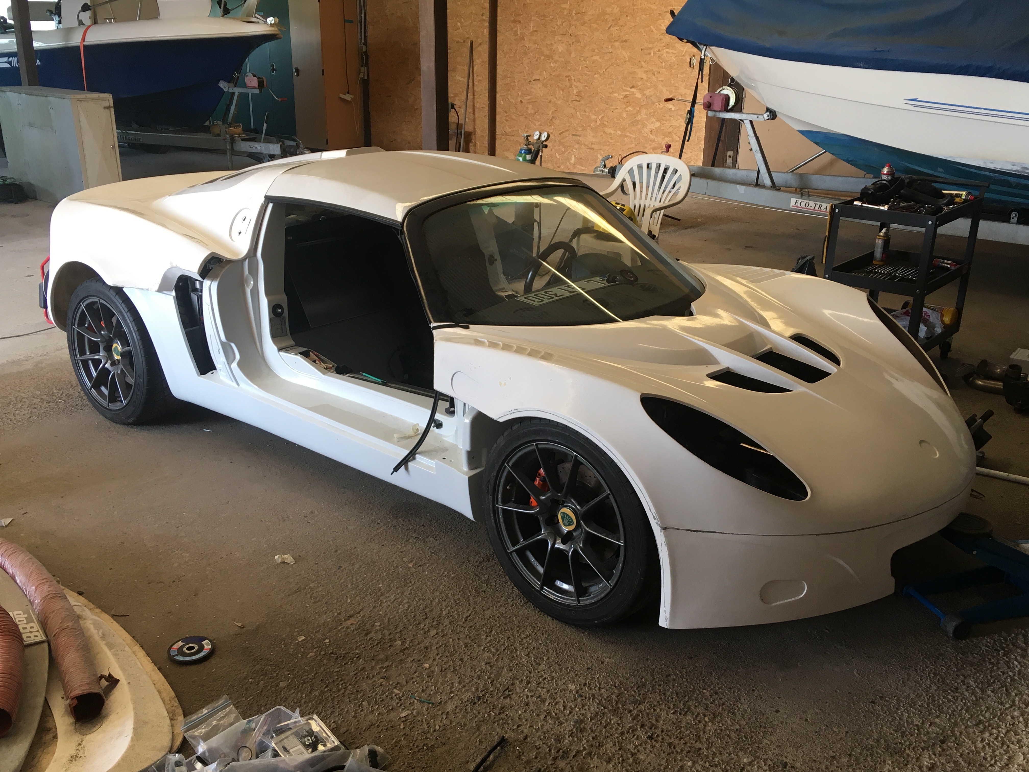

i love the front of these, i remember when nick ives did the same conversion (albeit on an actual exige) the clams were totally miles out, yours look pretty good.
#908 Doctor Ed
Doctor Ed
  • 1,188 posts
  • Location:Germany
Posted 20 April 2018 - 10:16 AM
yeah, the fit is pretty good! Needs a bit of loving/trimming to sit on the vx properly, but it's 90% good. lengthening the back 30mm shouldnt be too bad. blending the quarters isnt looking as bad as id first imagined either

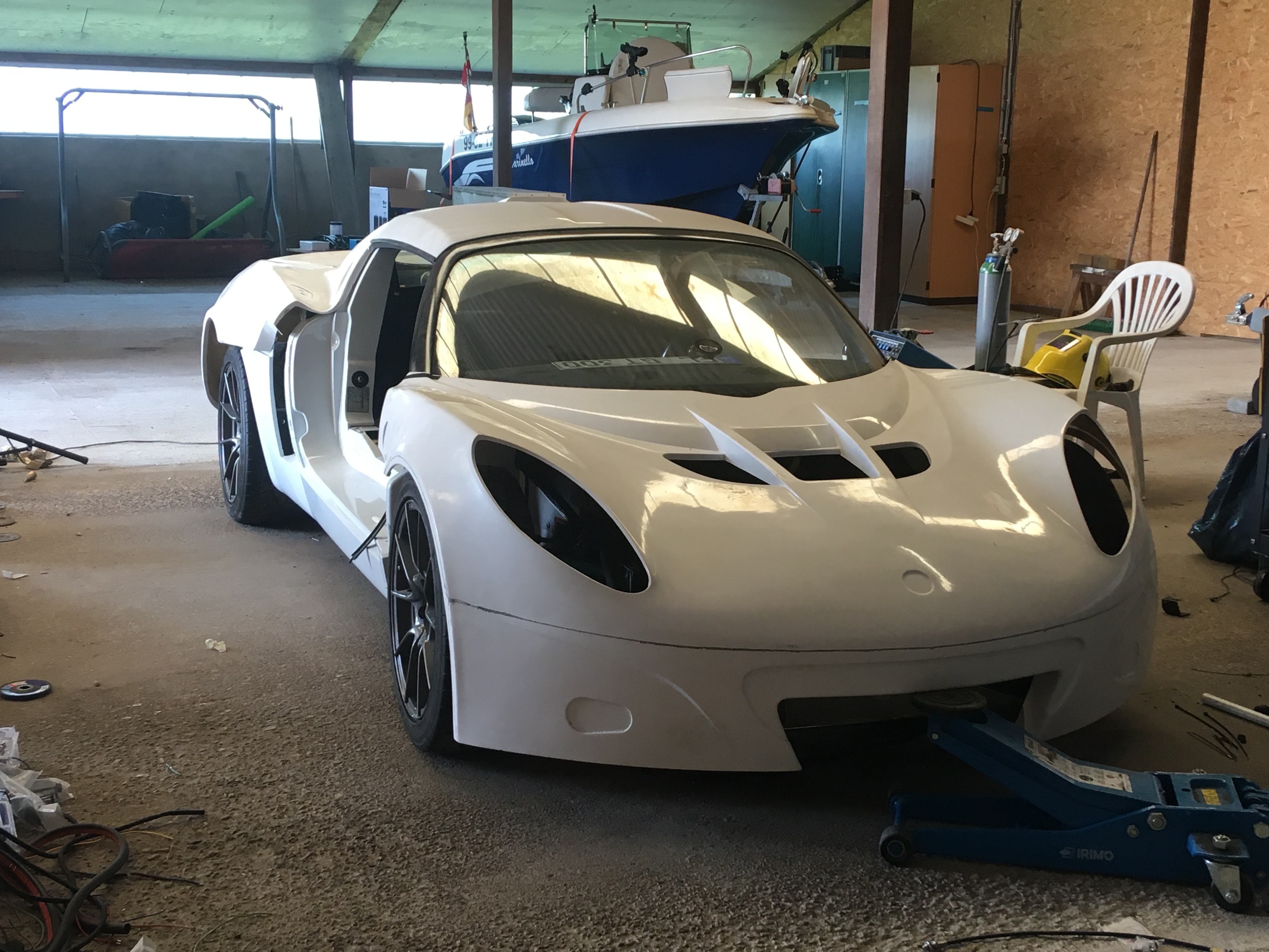

#909 Aerodynamic
Aerodynamic
  • 1,455 posts
Posted 20 April 2018 - 08:17 PM
What body panels is that? Do you need to extend the wheelbase with 30mm? Looks awesome.
#910 Doctor Ed
Doctor Ed
  • 1,188 posts
  • Location:Germany
Posted 20 April 2018 - 08:46 PM
Exige GT3. VX wheelbase is ~30mm longer, so yeah, need to cut and stretch the clam. The widebody also about 80mm per side, so have some big dish 10" wheels plus 40mm spacers. Probably still won't fill the guard, but be close. 255 is also the most sensible and available rubber I can get for 17" wheels, so not heaps, but more than enough I suspect

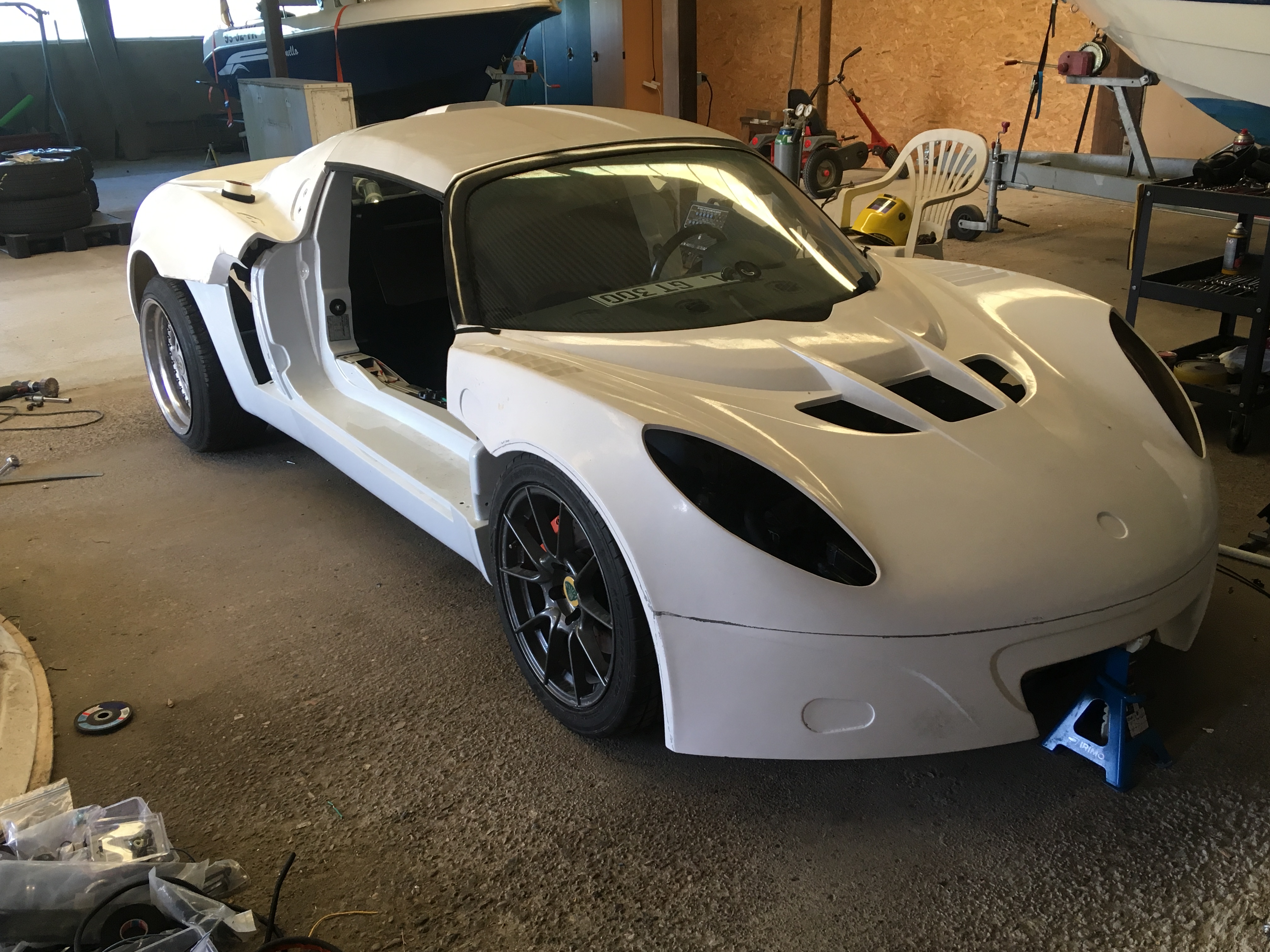

#911 Aerodynamic
Aerodynamic
  • 1,455 posts
Posted 20 April 2018 - 09:01 PM
Ahh I thought these panels were 30mm longer than vx. Where did you get 10" wheels? 5/110?
#912 Doctor Ed
Doctor Ed
  • 1,188 posts
  • Location:Germany
Posted 20 April 2018 - 09:19 PM
5x120 BMW spec. needs spacers anyway, so using PCD adapter spacers

#915 Doctor Ed
Doctor Ed
  • 1,188 posts
  • Location:Germany
Posted 21 April 2018 - 11:23 AM
10 Oz rear sitting kindve where it should (ignore the fully sik stance-spec tyre fitment).
Edited by Doctor Ed, 21 April 2018 - 11:27 AM.
#916 Aerodynamic
Aerodynamic
  • 1,455 posts
Posted 23 April 2018 - 07:48 AM
Are those wheels lightweight? What differs between the GT3 body and the exige V6 except for the design? The V6 is 70mm longer. What about the width? And is the wheels arms higher cutted in the GT3 then v6? Nice work Br, Per
#917 Doctor Ed
Doctor Ed
  • 1,188 posts
  • Location:Germany
Posted 23 April 2018 - 12:43 PM
theyre forged and for a 10" rim theyre relatively lightweight. the ATS are lighter though. ill be keeping both and see how ist handles. the exige V6 is an entirely differnet car. the GT3 is just a sub-evolution of the regular S2 that never came to be (but the moulds got out and people started making their own). its still got all the basics of a regular S2 and doesnt vary wildly in dimensions... except for the rear widebody which is around 80mm per side. word of mouth is that this kit doesnt 'need' Offset uprights and the wheels shouldnt look too orphaned in the arches. the rear does look hight at present, but ist not really 'mounted' properly, just kindve leaning there at present. ist tempting to get carried away with the Body, but engine.... it Needs to run first!

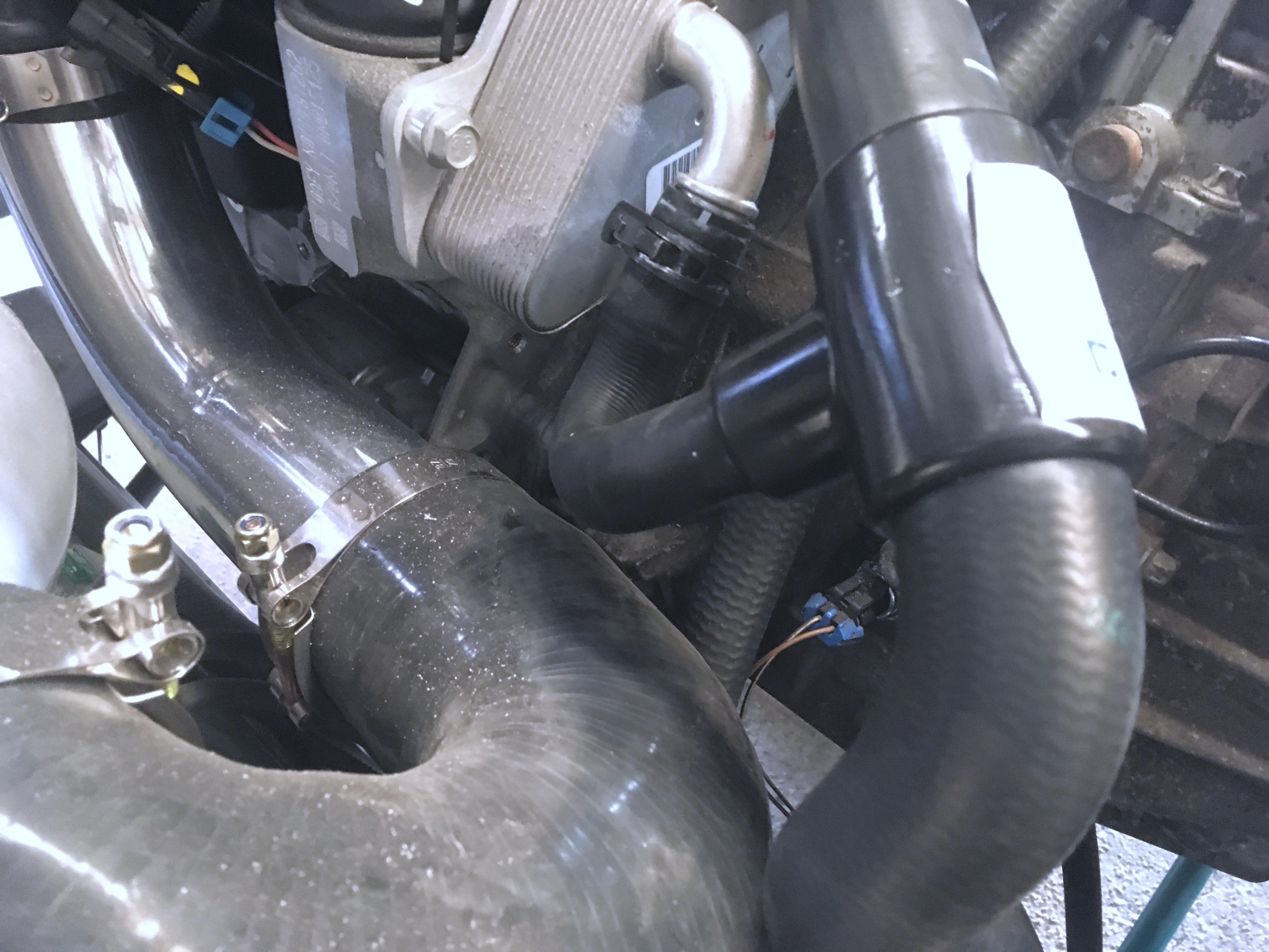

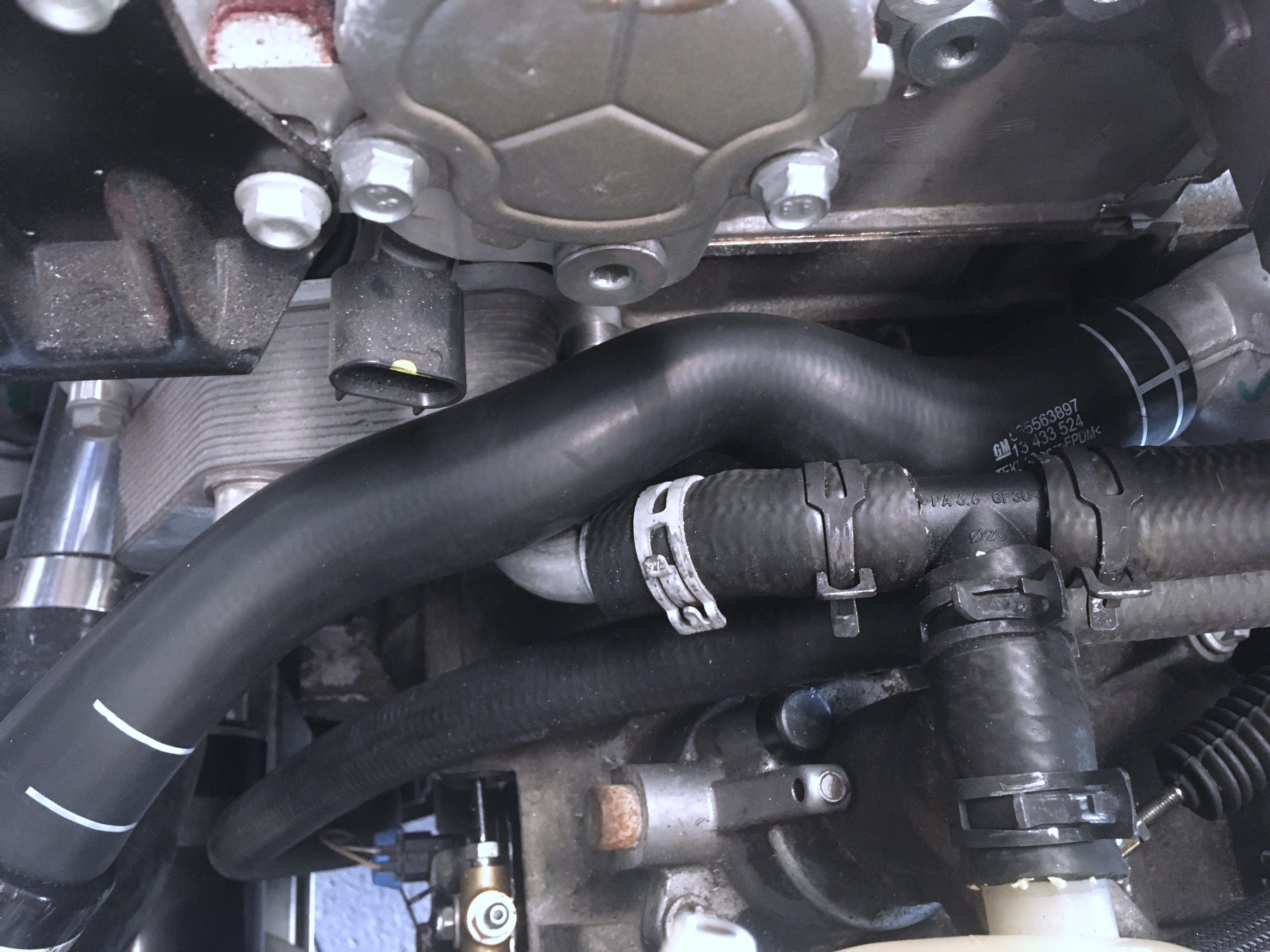

Trying to ignore the bodywork and crack on getting this fcuker running. I've quarantined a day on the weekend later this week, but had a chance today to tackle something that's been annoying me for ages... hooking up the lower radiator hose.
Sounds mundane, but this fcuker cost me over an hour of my life along with quite literally the skin off three knuckles (and I've got a list tomorrow, so it'll be the gift that keeps on giving!)
Standard hose from a Astra J GTC (GM 13251439 / 13433524). Fits eerily well around the surge-tank and meets up with the horizontal lower fitting from the chassis rail. Not looking forward ever having to remove this.
