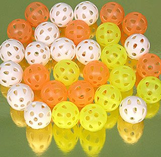

and look baffle balls
http://www.directwat...uk/baffle-balls
#495 smiley
Posted 07 October 2016 - 03:53 PM
That's impressively expensive for plastic balls.
#496 The Batman
Posted 07 October 2016 - 03:59 PM
My dog has a toy ball like that Yours for £50 :lol:

#499 CHILL Gone DUTCH
Posted 08 October 2016 - 01:08 PM
In our fuel tanks we used foam or now use aluminium scourer looking balls
Are they cheaper than these balls
#500 Jason
Jason
  • 1,327 posts
Posted 08 October 2016 - 03:08 PM
https://www.amazon.c.../dp/B005VCZ944/
£11 for 48 balls..
