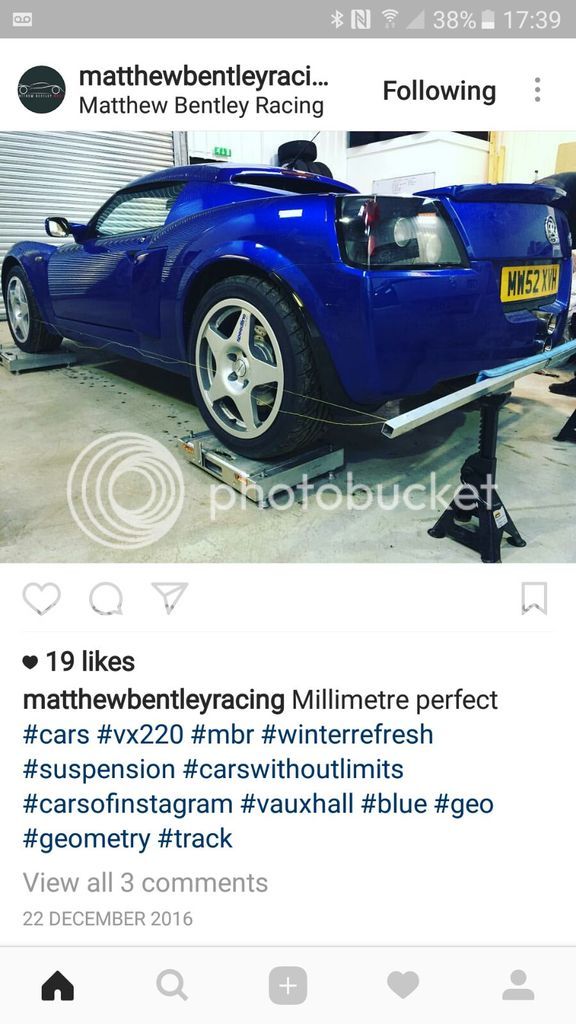

I'm thinking that if I take it to a specialist (someone who knows what they are doing) it'll come back great and maybe steer like my friends exige? I am right in this? But could this be achieved with castor and a basic geo?
You say you have Nitrons fitted? So when they were fitted surely the geo was done then... were you happy at the time or has the car got worse since then?
