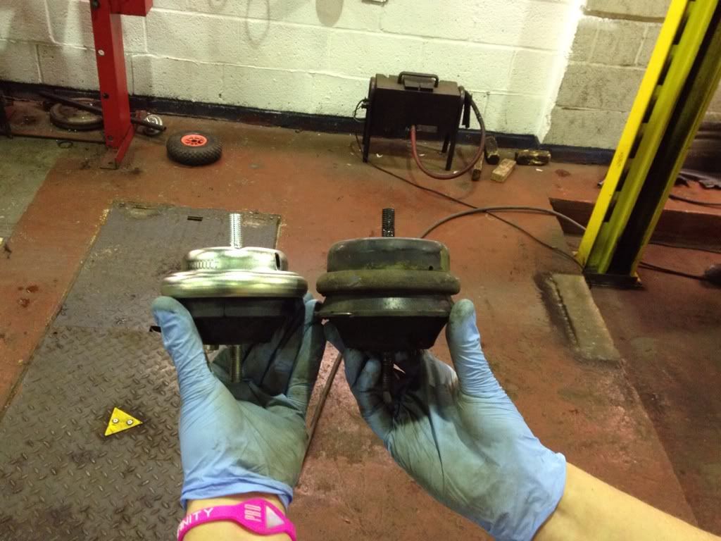

#10 tibby
tibby
  • 504 posts
  • Location:Belgium
  • Interests:POWER
Posted 08 May 2017 - 05:23 PM
left omega
rigth vx

#12 aKra
aKra
  • 109 posts
  • Location:The Netherlands
Posted 08 May 2017 - 08:06 PM
left omega
rigth vx
http://www.autovaux....gine-mount.aspx
http://www.courtenay...r/prod_764.html
Both look similair to the left one, as you state the Omega one?.......

#14 vocky
Posted 09 May 2017 - 07:03 AM
The vx220 side mount is on the left hand side, the omega on the right thumbsup

Posted 09 May 2017 - 09:13 AM
well, crap :blush:
Can't find the topic were  i've got the picture from. Frankandbeanz1 ?
(i'll keep on searching until i find this topic)
