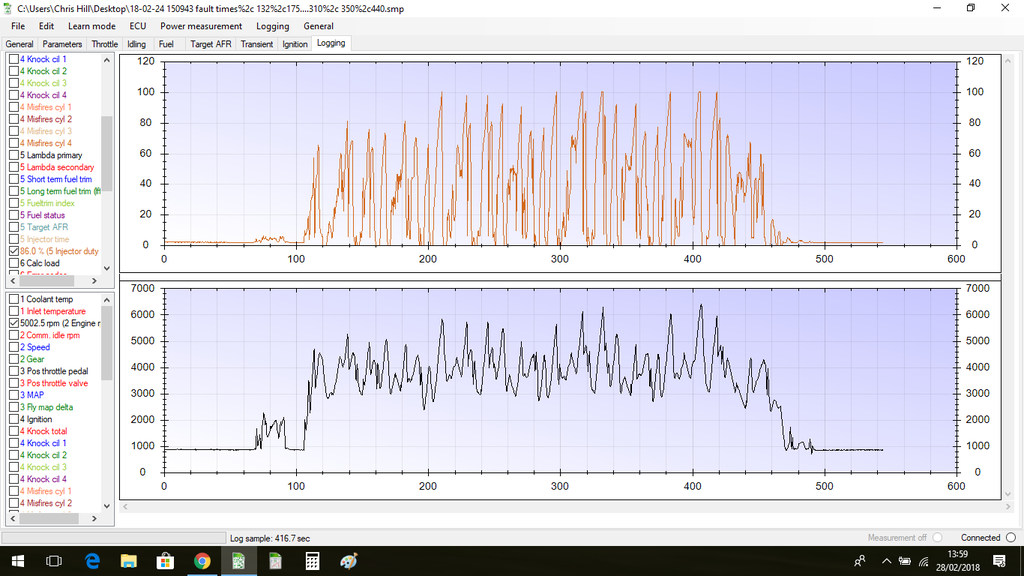

#16 CHILL Gone DUTCH
Posted 28 February 2018 - 02:05 PM
#17 CHILL Gone DUTCH
Posted 28 February 2018 - 02:08 PM
86% duty cycle is coming in at 5000 RPM
so if all your lambda sensors were fully working when you did the fuel learn i would say your injectors are the first thing to uprate
#18 CHILL Gone DUTCH
Posted 28 February 2018 - 02:10 PM
5800 is 100% duty cycle but anything over 90% duty cycle basically leaves the injector fully open all the time
this why you need to aim for around 80% duty cycle and this should give enough scope for when the ecu calls for more fuel with inlet temps etc
Edited by CHILL Gone DUTCH, 28 February 2018 - 02:15 PM.

#20 CHILL Gone DUTCH
Posted 28 February 2018 - 02:16 PM
I fitted a brand new set of NGK lambdas when we went Dutch. Sent from my iPhone using Tapatalk
good lad man after my own heart
you should also check for exhaust leaks or cracked exhaust, your inlet temps in the logs are fine
