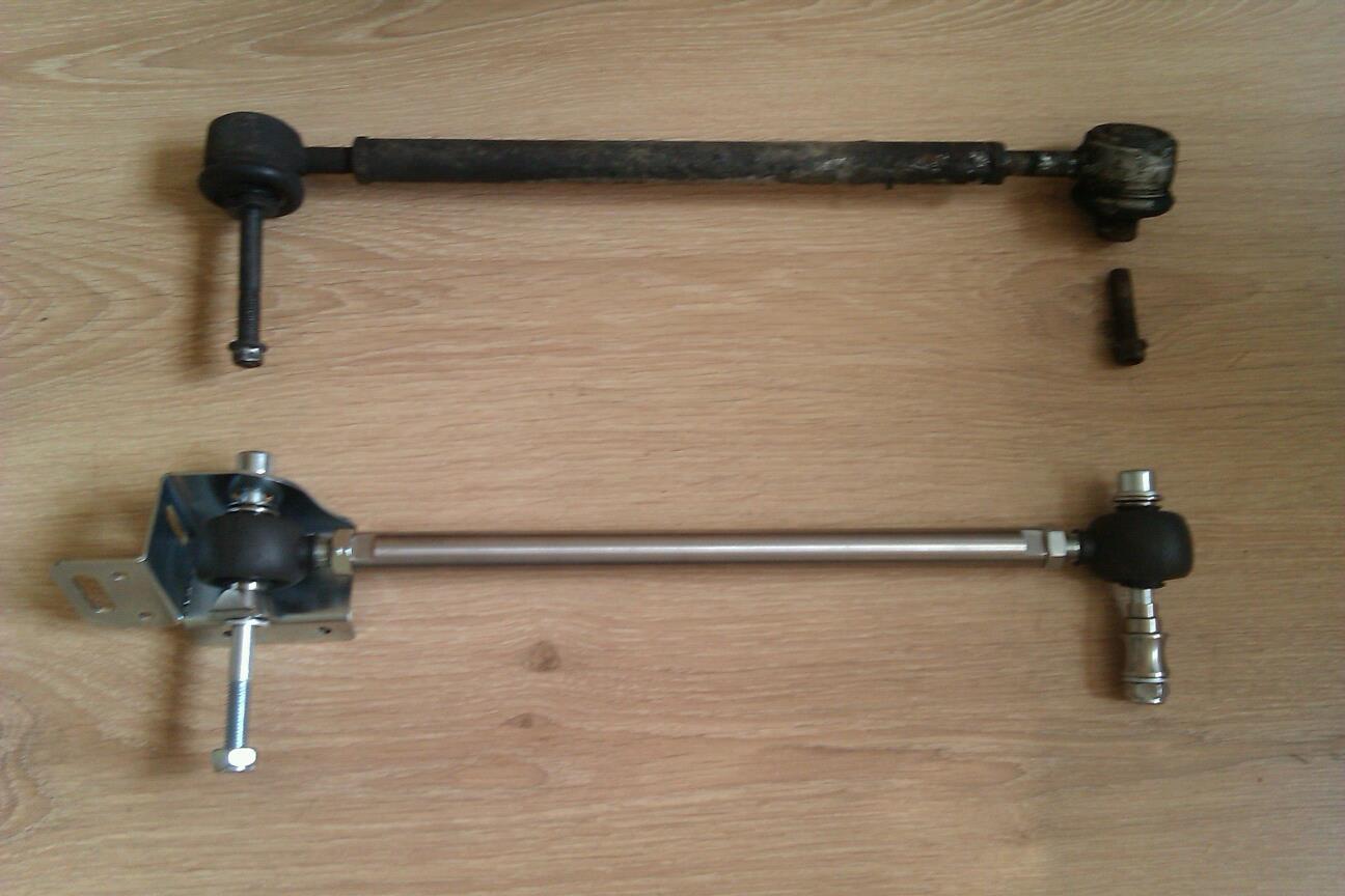

#18 smiley
Posted 19 January 2019 - 11:51 AM
If toe links snap, it is usually in the sub section, which cannot be seen in your pictures.
They will have to be removed for inspection. But to be honest, i would replace them regardless.
The snapping has also been seen on regular road driving, hence all the attention in this topic.
Sample of a snapped one, and an aftermarket toe link.
