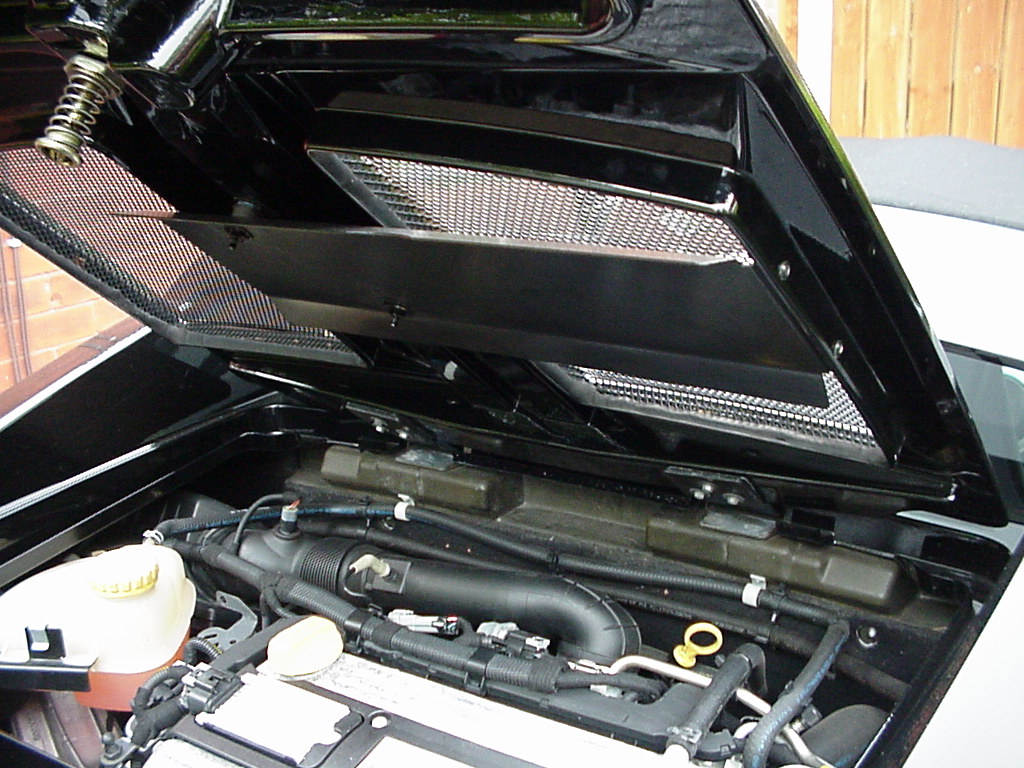

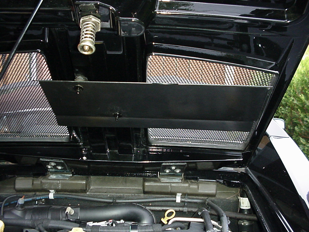

I havent fitted it yet but had a look to see if it would fit.
It doesnt! - it fits to the lip - but doesnt fit to the middle of the boot.
The Turbo has deeper indents in the middle so the kit fits flush - the NA has a huge gap running in the middle so the plate doesnt fut flush so you cannot fit it via the screws

Posted 26 November 2005 - 09:27 PM
I hope you are not giving up this easily - MAKE it fit !!! - and let us know if you want any of our (stupid) ideas to help you alongNo harm in trying! only £22!!!! worth buying it just to see.
PS. If you were handy in metalwork it can be modded!

They had some spacers for the kit to make it fit the boot lid..

The Water ingress kit is the top plate, the badass covers are the bottom two.
Going to try and fit them when I get chance.
