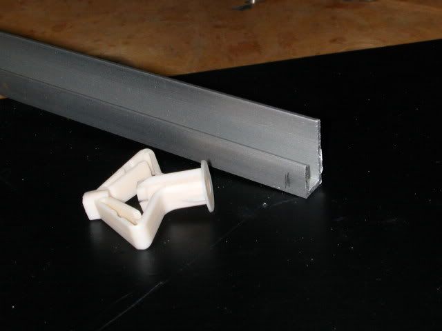

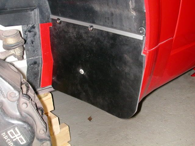

My latest attempt: Posted Image
No new holes. 6mm rubber sheet (yeah, it's a bit heavy) fitted with about 30cm. of aluminium profile, longer inner wheel arch screws (M5 x 30mm), one plastic thingumybob for plasterboard that fits in (and can be removed from) the hole in the sill, and some double sided tape.
