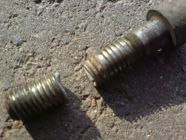

Sun was out all day yesterday, roof off, taking some lunch to the wife who was working, Halfway round a big roundabout on a duel carriageway the car suddenly spins right round rapidly followed by spinning back the other way and coming to a halt in the approach lane for traffic coming the other way.
A quick glace in the mirror confirms my first thought...
Whilst waiting four and a half hours before getting home I had in attendance:
One police Bike
One fire arms responce police car
One traffic police car
Two flatbed recovery trucks
One Flat lift Truck
Watching Laural and Hardy trying to load the car was priceless, this was the 3rd attempt to recover it.
I'll go and whip the wheel off now and get some pics of the damage.
You'd think Vauxhall would accept this problem :beat: It's starting to happen a lot.
Looks like it's pulled the drive shaft out, oil everywhere :(

:o sorry to hear this, is that brake fluid i see in the second pic ?

Yeah I think it may have pulled the brake line out too, it's mixed in with gearbox oil though that came out of the driveshaft hole

not seen it happen to anyone with standayd Bridgestones and standard suspension yet though (although I could be completely wrong) Maybe Lotus / Vauxhall set the car up so the hub would have the toteraces to take standard setup, but not the gripier tyres and harder suspension. I seem to remember reading that if you replace the tyres to 888's on the lotus as part and parcel they also change the bolts (again, I could be wrong) The 10.9 bolts seem to be a good preventative measure for everyone. Glad it happend at relatively slow speeds and that nobody was hurt Dean
Dean
so what did vauxhall do with the VXR then? I am willing to gamble that they didnt put the 10.9 bolts in with the yokos.

That could have been a lot worse :angry2: If it had failed at high speed it would have caused a serious accident.
IIRC Lotus recommend that when changing to exige wheels/suspension on a 111r that the hub carriers are replaced.
Can't find them on Ebay anymore, does anyone know where I can get some from?

The dealer wil try and charge you £10 each for the bolts. i got a full set from the local bolt store for £2 all in for 8 bolts. CV boot kit from dealer is £45 ish also. Don't know if anything from other models fit...

Just been back out with the car, looks like the track rod is also goosed, only replaced them about 4 months ago with OEM parts (cost £275) I'll go for the Splitfire ones this time!!

Remember that this pb can have some different causes.... A wrong design by Lotus, particulary with high stress chassis setup (Yoko / Toto, Nitron / Ohlin)... A poorly done maintenance : bolts must be tight to the correct torque or else the whole system (upper wishbone, hub carrier & bolts) will not work as intented... A friend of mine is racing his Speedster (with slick tires) and had no failure here (using 10.2 bolts torqued to 60+ N.m, changing the bolts very regulary)... I think a road only VX can keep the 8.8 bolts... Anyway, it could be a good idea to change these bolts regulary... :ninja:

when i took my group buy (this forum) 10.9 bolts to Plans to fit when i was having the nitrons done they refused to fit them, graham got quite animated about it - they fitted the 8.8's instead. Peeved me cos the long ones are fekkin expensive. edit/ didn't see any body damage which was lucky
