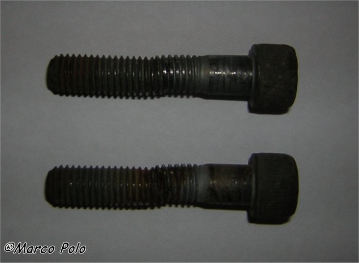

I think i will get them changed for peace of mind every other service. This might be overkill but it doesn't bear thinking about if this were to occur at speed. Now whether fitting the 8.8's will give you any warning that the HCB's are knackered before they break I don't know. I remember a photo on this site showing a bolt that had been removed which was bent and chewed which is a lot better than a broken one, i wonder what grade of s/s it was?
This one ?
:rolleyes:
It was the standart Opel bolt i.e. 8.8 ...
:poke:

Marco Polo well done for finding that. Do you know if they were off the front or rear. I wonder how close they were to the big let go :wacko:

Posted 06 May 2008 - 06:47 PM
Well, not hard to find... They were mine... I am not going to remove that picture from the website for quiet a long time... People need to be aware of that weakness in design/maintenance...
They were on the right side, rear hub carrier...
I still wonder how it would have finished if I had not changed them...
(they were a deep pain in the @$$ to remove !!)
