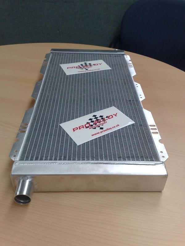

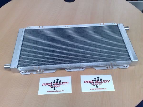

Thought i would bring this thread back up again. I’m am going to change my rad this weekend and my new Radiator arrived today. Very excited haha as its pro alloy and I’ve wanted to buy something from them for ages (sad i know haha)
Very pleased with the build quality and cannot wait to get it in. I’m guessing the old fan off my old rad will be ok with this ? Also I’m just going to use normal water, I’ve bought 6 liters of GM coolant. New header tank will be with me tomorrow also, I’ve recently replaced the current one but it was damaged on arrival so AutoVaux are very kindly swapping it for me.
Cheers
