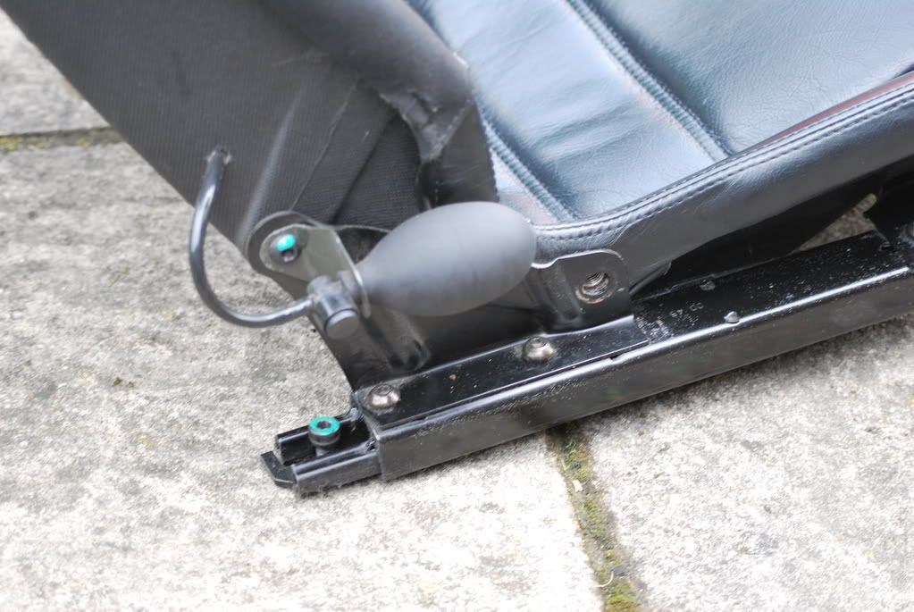

Jen from MSAR kindly got me a pair of these in case I go double shear (will depend on the seat I end up with!)
To replace the standard ones:
I've tried two Loti garages tho, and they don't want to sell the lower bolts individually :rolleyes:

Yep, they are the Reverie ones - only part of the £53 kit, as with a four point harness like the schroth there is no need for the cross brace to attach the anti-sub strap to :) These plates replace the triangular bracket you can see in the pic of my standard seat thumbsup having double shear means that you need a longer than standard bolt, hence trying to get one from Loti The double shear refers to the two plates, hence the bolt is held in place at two points rather than one on the standard set-up, effectively doubling the strengh The harnesses are then slipped over the bolt that passes through the two plates and into the captive nut inside the seat, so it isn't the top of the triangular bit, it's the holes on the right hand side of the pic above I don't think they are a straight swap, may need to re-drill the mounting holes in the bottom, not sure yet tho :)
