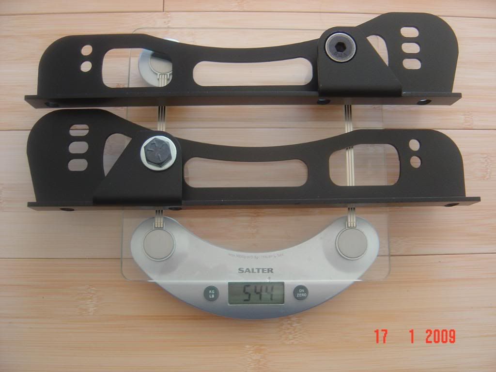

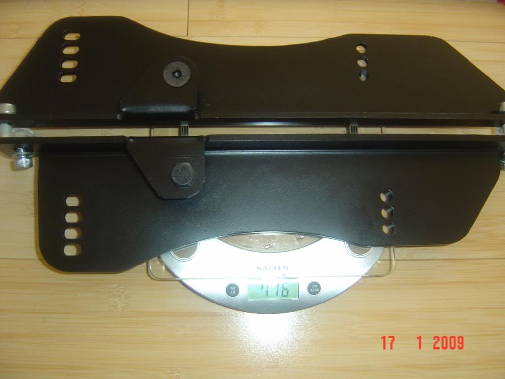

I picked my seats up from the couriers on Saturday and installed them today. The quality / finish / strength is excellent. Installation was no different from the standard seats ( i.e. easy if you have 10”long fingers that are1/2” diameter and have the dexterity of a surgeon!). You have to order the brackets separately for each seat, I opted for the aluminum passenger rails and the steel drivers slide (no aluminum ones in stock) with the drivers side if you want the sliding adjustment you need to use the existing adjuster rail that comes with the standard seats.

Aluminum passenger rails = 716g
Drivers Slide = 544g
Standard Seats = 17.8kg
Tillet Seats & Brackets = 10.06kg
Total weight saving = 7.74kg

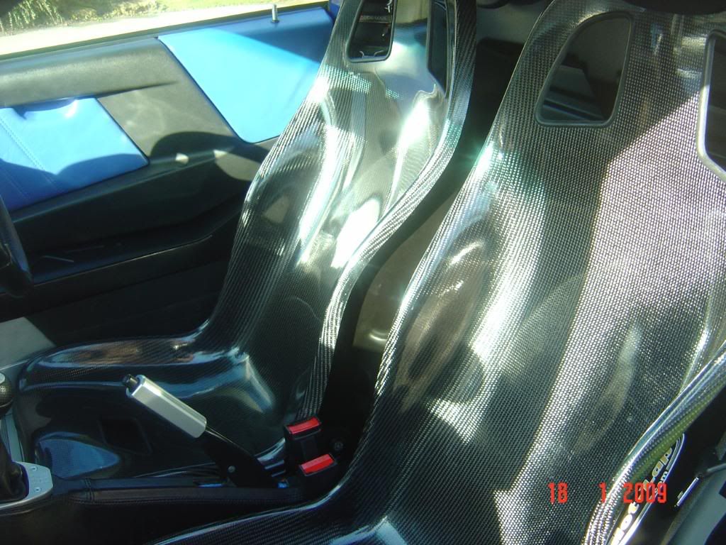

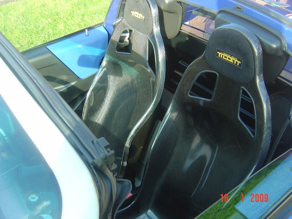

One observation as the seats have a higher back than standard the seat, they do not sit in the inbuilt headrest recess (See the images below) although this suits my driving position and I am 6ft, it may be necessary to remove the inbuilt headrest.

Tillett B5 - Carbon Fibre / GRP
Passenger rails
Drivers rails
Tillett B5 on the scales

If anything the leg room is reduced length wise due to the fact that the Tillett seat back is taller than the OEM seat therefore does not fit into the fixed headrest recess, however this could be removed (There are some threads on how to do this) giving a good few inches of additional legroom.

There you go this is the best image I have at present detailing the proximity of the seat to the fixed headrest, which I would say is roughly 10mm.
