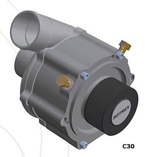

#16 mandarinvx
Posted 07 June 2009 - 02:46 PM
B)
#17 vocky
Posted 07 June 2009 - 02:50 PM
At the moment I'm irritated with my car (which I only use on track) as I can go faster than most around the corners but it is dog slow on the straights and most of what I've got past comes steaming past me again. I want a car with about 200-220bhp, that will do me. At present I've got TMS pp2 158bhp. The problem is I'm trying to get it all done by the 29th but thats looking a no go now. I've got a Miltek with a 200 cat and would prefer to keep that, would the Piper not be too loud.
the milltek will be fine, just replace the exhaust manifold when the standard one cracks thumbsup
The courtenay sc will deliver the power you want, you just need to be patient :grouphug:
#18 vocky
Posted 07 June 2009 - 02:51 PM
B)
wouldn't that look great with itb's ;)
#19 The Batman
Posted 07 June 2009 - 02:52 PM
thats the shizzle adam! now the question is can i hook that up to my m62? :lol: (i can picture vocky shaking his head :lol: )
