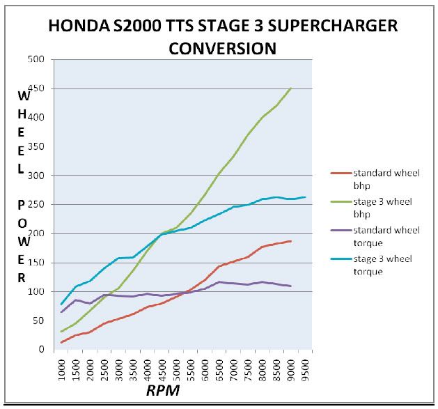

How would the boost and torque graphs differ between an M62/Harrop and a Rotrex? I was led to believe the power delivery/driveablity characteristics were not as good on a Rotrex charger.
Ok, so you can't really compare, but here is a graph for an S2000 (with charge cooling) - still seems nice and linear

The Rotrex graphs I have seen are linear. An intercooler is sufficient I think - all it would mean is that you could not get your 250bhp in a traffic jam ;) There were postings on here once from an Italian gentleman with a Rotrex'd Speedster. None in the UK though I think.

The torque doesn't come in until right at the top of the rev range then?
So at about 2,200 rpm the Rotrex produces less than 50% of it's available torque.
Yet the M62 will be producing nigh on maximum torque at that point, the area under the torque curve varies massively. Surely given those characteristics the M62/Harrop powered car would be long gone.
Also with the z22se which is less inclined to rev very highly that makes the it all the more worse as you won't be able to easily exploit that torque with it right at the top end of the rev range?

I'm not sure - it may just be that the charger replicates the characteristics of the engine (and the graph above is a Honda :D)
I don't think so as the standard torque curve is relatively flat.
