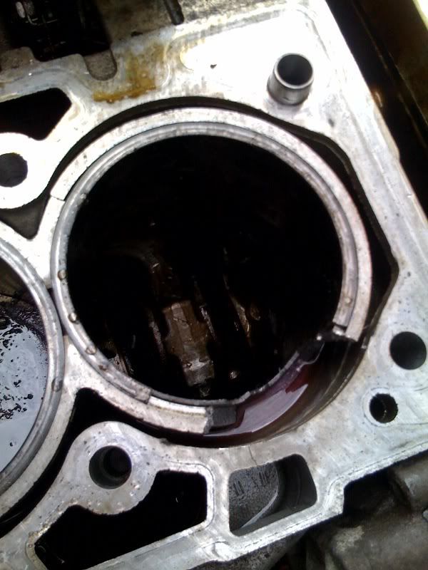

This was an LNF btw... http://good-times.we...562048974BhcfDN
(2.0 is not underbore, same bore as our 2.2)

ouch, poor lnf , is there a forum link to the story behind that catastrophy?

Yep, All 2.0 / 2.2 / 2.4 gen 2 bottoms are the same (from a weak L61 to a LNF)
It seems the L61 (Z22SE) only got a Gen2 block in 2007 - so all our VX220s will have the Gen1 block with the weaker bottom end.
Impressive failure btw :) I'd never seen one of them die like that before. Was he running stupidly boosted, or was that a totally stock engine?
http://www.solsticef...ne-build-41759/

i put a direct port n2o kit on...
i worked up to a 200 shot...figured a 300 shot would...
I think that says an awful lot about how insanely strong these engines are. I wouldn't be worrying too much about my cylinder liners tbh :)
