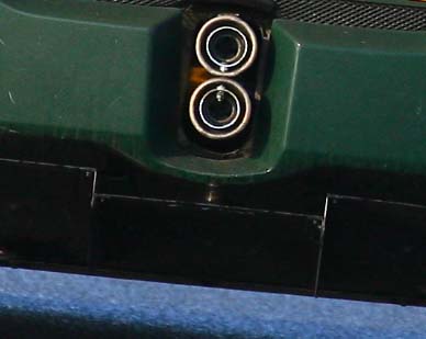

I went there with the original off the shelf piper full system 2.25" and ITG filter (+dblias exaust manifold).
After spending a lot of cash on a Harness, Harness bar etc I was desperate to get on track and not be turned away. A self test was done (with what now seems to be an unreliable DB Meter) registering around 103. To be on the safe side I picked up 2 of these Exhaust Baffles.
The baffles were cut down, the exhaust tips were drilled (one bolt goes through the lot +a few washers as spacers), and the baffles nudged into place. I believe the static was around 95-96 on the day, not sure on drive-by.
Unfortuntely without a back to back test with the same reader I can't confirm how well (if at all) these are working.

Posted 04 February 2010 - 08:34 AM
That's a shame as it would be good to know how effective they are, although it takes a brave man to take a drill to the tailpipes. The short run of tube for the tailpipes before they merge is a real pain in the proverbial as it probably meant almost cutting those baffles in half, I guess? :blink:

#58 BRG_Pete
BRG_Pete
  • 285 posts
  • Location:Camberley
Posted 04 February 2010 - 10:35 AM
Yep pretty much cut them in half, i ended up with about a 10.5cm baffle. Made a complete hash of it with a hack saw, then headed round to a friends to use a cicurlar saw. The tail pipes were a pain to drill, especially upwards into the bottom pipe without taking the diffuser (mmg) off.
