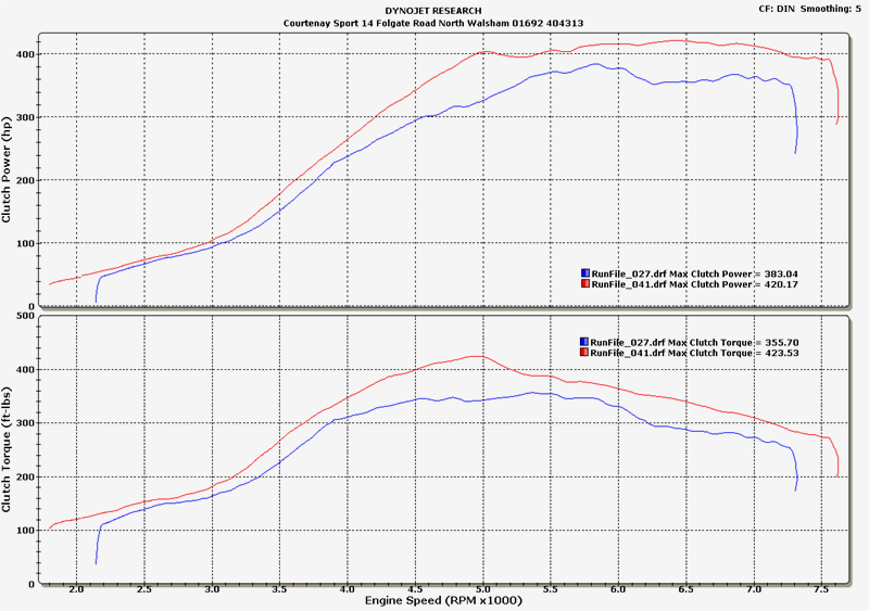

Garrett GT28-71 RS turbo
equal length tubular manifold
forged pistons, steel rods, lightened and balanced, under piston cooling installed
High Flow Injectors (550cc),
80mm air flow meter,
high flow enlarged tophat
uprated inlet and exhaust cams, modified head,
3" bespoke exhaust system with sports cat,
Courtenay-Klasen High Flow Inlet Manifold

+80bhp +80lb/ft at 5,000rpm over the Stage 5 :o Is this the Scottish Astra VXR?

no details about comp ratio , but looks like mid range has suffered noticeably ,
compare : http://www.dyno-plot...vx220/index.htm
wonder if they used an early x20xev crank instead , no balance shaft cogs, so lighter
apart from that I'm disappointed it doesn't rev out to 8500 for a built engine.

I was quoted £ 13.5k for a similar amount of work by a certain company (who I will not name), and that was without the Klassen inlet which itself is £800 more. I am attempting a similar (but more powerful setup (due to larger turbo with more high revs puff mainly) on my car for approx £9000 (and thats including the Klassen inlet). You can thus draw an approx idea of the profit margins made. Having said that, I consider the profit margin fairly sensible. Looking at the torque curve, I would say that it looks excelent with very little mid range peak, making for a very progressively featherable throttle. I will be very happy if I achieve a simliarly 'flat' torque curve. As for not maxing out at 8500 revs, there is a lot of worthyness in not needing to rev the engine over 700 PRM - namely longevity. The difference of engine life from 7000 revs to 8500 is logarithmic. That said however, if you wanted the car for tracking it would be much better to have a steeper BHP curve in the last 3000 RPM, as that BHP curve is too flat to be worth reving over 5700 revs.

the turbo is too small to flow enough for 8500, it's the classic problem of a fixed geometry turbo that you can't get a wide enough range of flow.

The torque curve looks actually not that bad Looks like a driveable one
