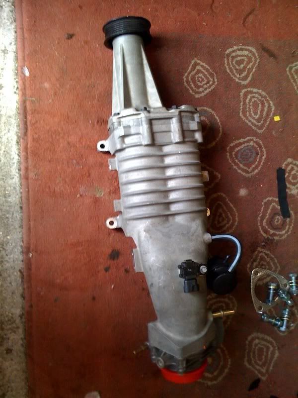

best induction kit - modify original airbox using drain pipe, so that you have 2 pipes coming out of it, making sure they are long enough to be behind the air vent, cut at slants so that air flows into it, then take away the crap bit of pipe from the tb to airbox, get a 90degree silicon bend put that on tb then drain pipe to airbox
jobs a good'en, list of bits:
drainpipe
90 degree bend
silicon sealant/glue
all be bought for less than £30
or just buy one of these ;)
and im not talking about the carpet ;)
