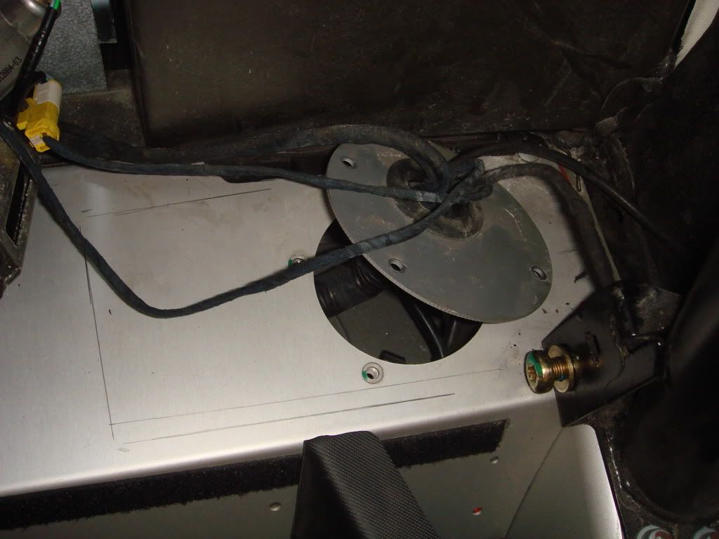

Well here are the results of this evenings work:
Before:
Standard inspection cover with part of loom passing through the plate.

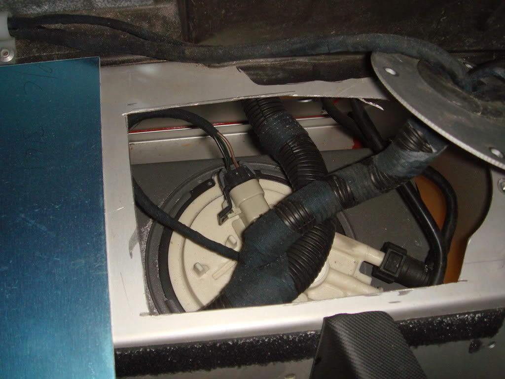

After: Hole cut with thin blade angle grinder, slowly and carefully trying to avoid any production of sparks. Before starting ensure that there is absolutely no evidence of fuel or petrol vapours present.
Need to tidy up the apperature and possibly extend it slightly above 115 mm (OD of pump housing).
Now with the pump out, tempted to dismantle the pump housing to check out the filter, as from previous posts, blockage of the filter can give problems. More electrical connections to be dismantled under the pump flange :(
Waiting for Rivnuts and tool inorder to make new closing plate.
