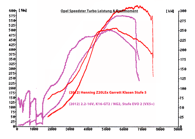

And just for completion:
here my setup (violett) against the setup of the friend with the Garrett...
Mad? Yes, I think so... :D
