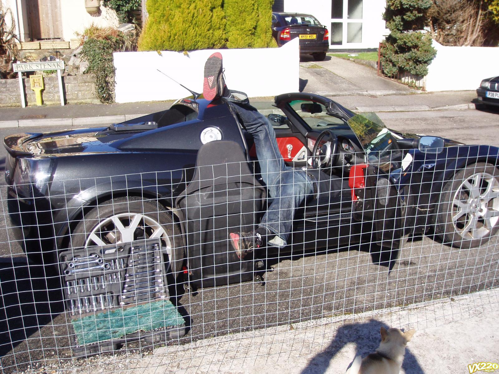

Well i gave this a go today.
Wow! what a difference, seems every little thing i play with and have a go at makes the world of difference.
I was ready to buy a new steering rack, the bolts seemed tight enough but still moved a bit.
Highly recommend trying this if you have a bit of movement in the steering wheel, tuck your head underneath and grab the joints then move the steering wheel a bit.

Lucky someone didn't run off with your tools. You'd know they were doing it but by the time you'd extracted yourself from the footwell they'd be long gone.

cant you see my guard dog sitting in the corner :tt:
