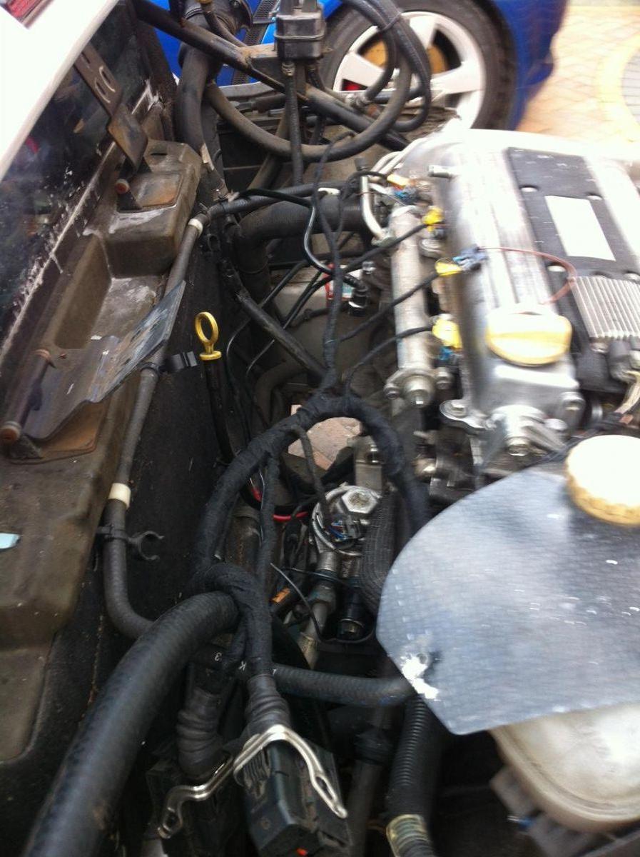

#96 fezzasus
  • 7,689 posts
Posted 16 July 2013 - 09:27 PM
Alternator turned up which changed my plans a bit:
#97 Steve.i.am
Steve.i.am
  • 990 posts
  • Location:Sussex
  • Interests:Bends
Posted 16 July 2013 - 09:38 PM
Yey stuff being bolted on.  thumbsup
Coming together. Good stuff.
