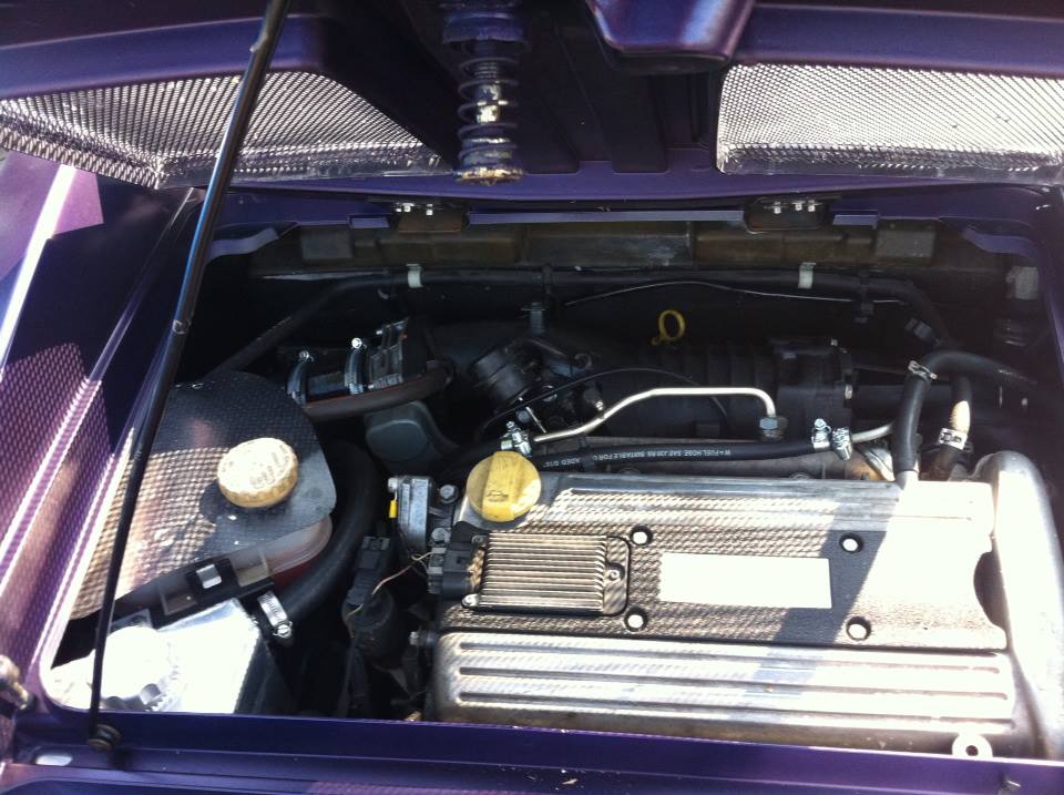

#139 fezzasus
  • 7,689 posts
Posted 21 July 2013 - 03:56 PM
Proof.
#140 CHILL Gone DUTCH
Posted 21 July 2013 - 04:39 PM
Good work
